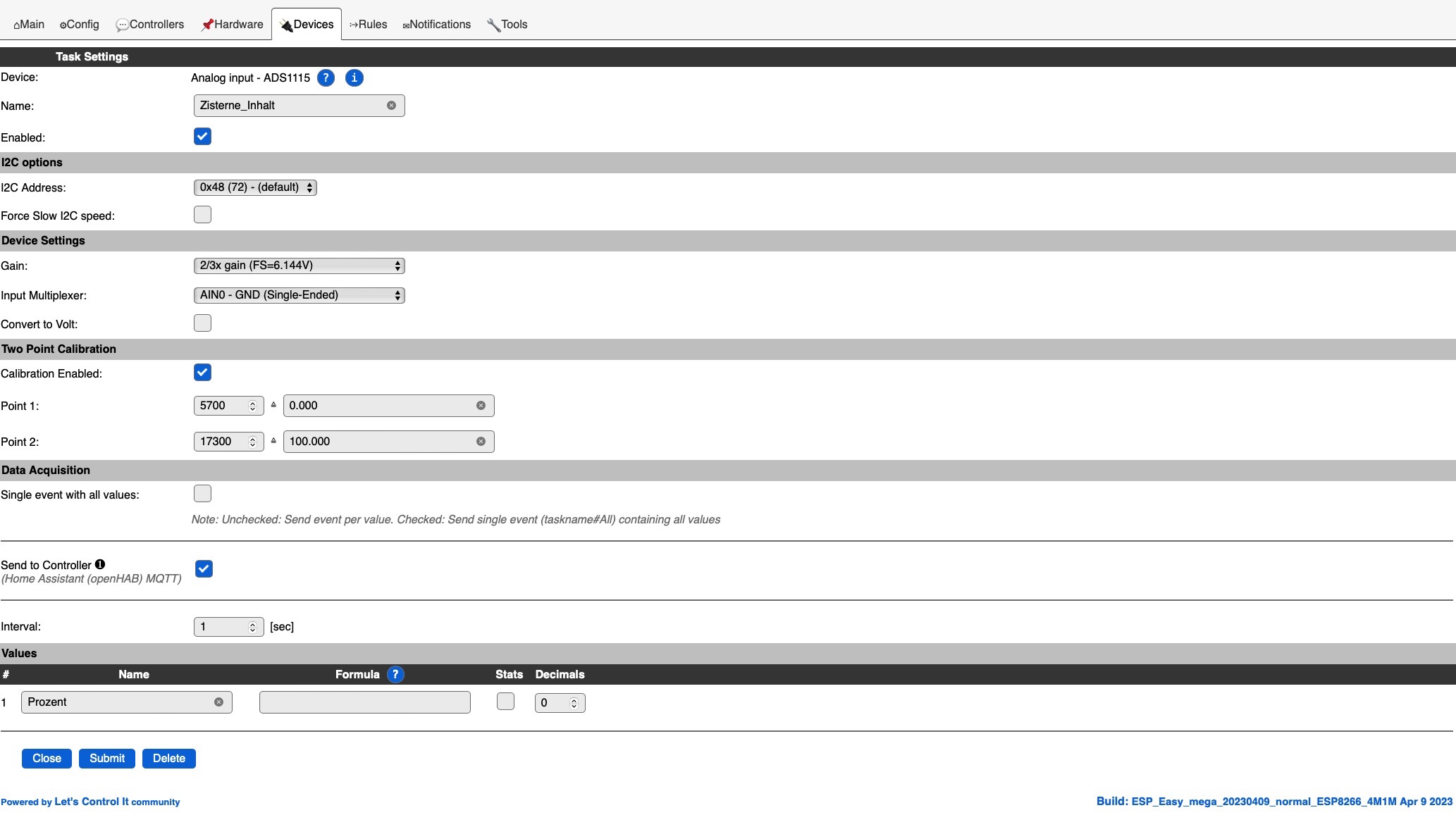

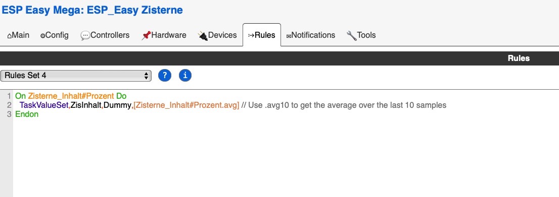

Hello, I use 4 sensors with my ESP2866. One signal is not very stable, so I tried to use rules to get a stable value. But It does not work. The average value I got is about 74 instead of about 102? Here are some screenshots. Could you have a look on it? What is my mistake?

The easiest way to get the average for task values is to enable the Stats checkbox, left from the Decimals setting for that Value, and use the [Zisterne_Inhalt#Prozent.avg] value in a rule:
On Zisterne_Inhalt#Prozent Do
  TaskValueSet,ZisInhalt,Dummy,[Zisterne_Inhalt#Prozent.avg] // Use .avg10 to get the average over the last 10 samples
Also see the documentation: https://espeasy.readthedocs.io/en/lates ... statistics

Did you disable or remove the rule with the same trigger? As only the first found instance will be executed (rules 1 .. rules 4 are read in that order, top down).

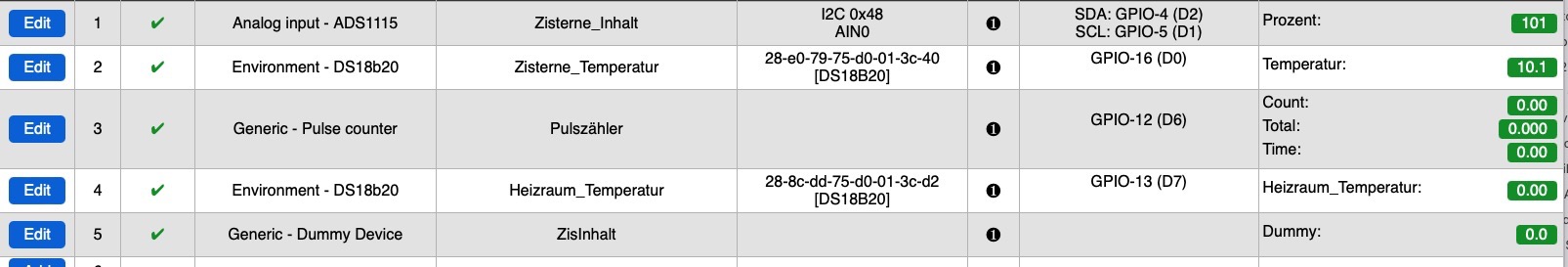

#5 Post by bastler11 » 30 Apr 2023, 19:35
I deleted all rules and all Dummy Devices. Then I and wrote the rule for the content new. But the shown value is still 0.0?
Re: Calculate average values does not work
#6 Post by Ath » 30 Apr 2023, 19:41

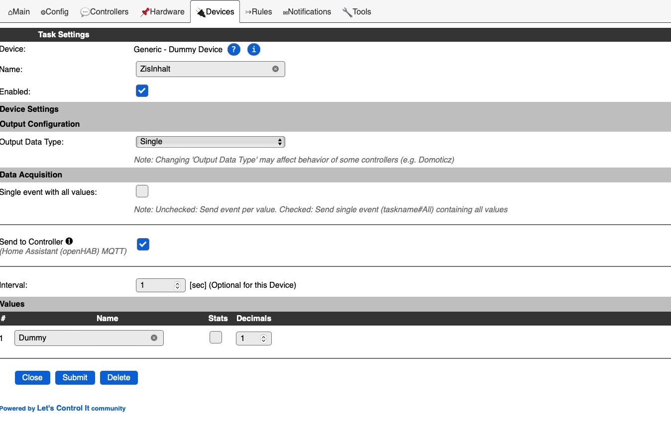

bastler11 wrote: 30 Apr 2023, 19:35 I deleted all rules and all Dummy Devices. Then I and wrote the rule for the content new. But the shown value is still 0.0?
But you still have a ZisInhalt Dummy Device, with a Dummy value? As I've used the TaskValueSet using the taskname and valuename, so these have to match for the value to be assigned (matching is not case-sensitive).

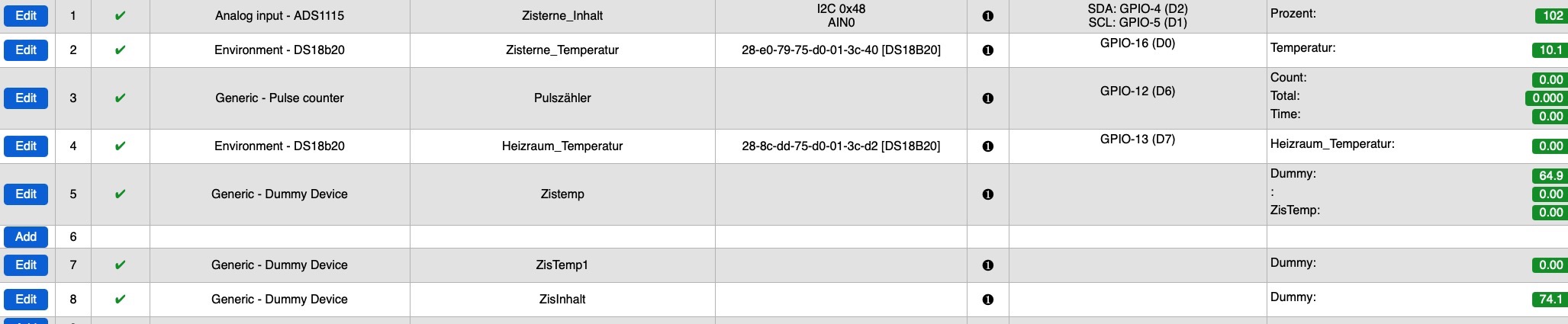

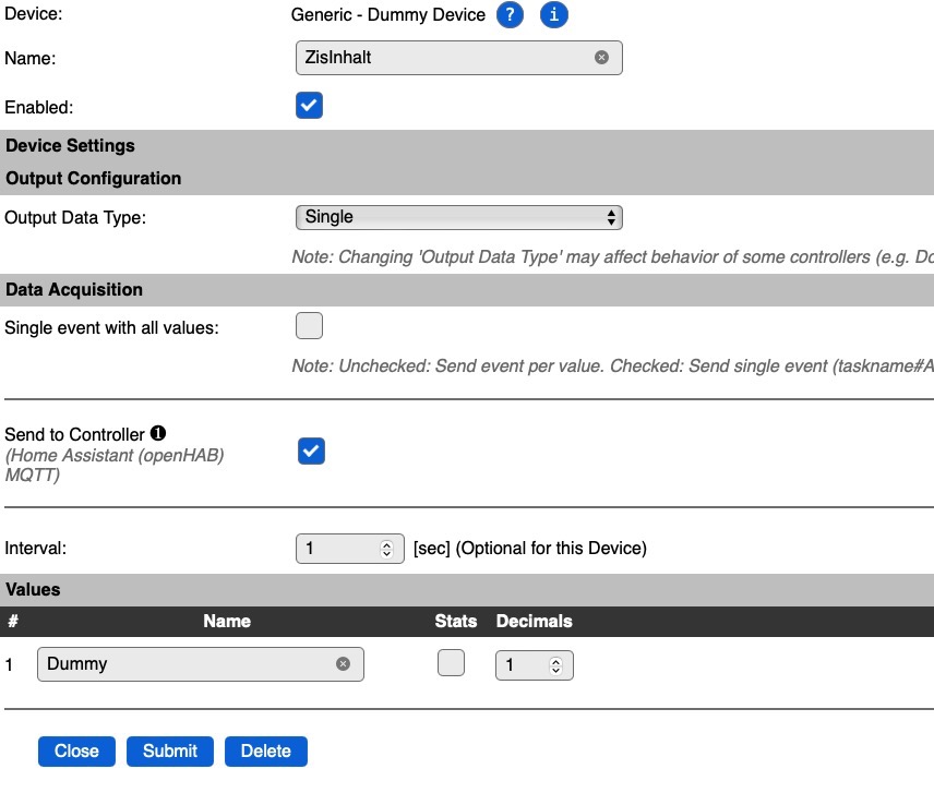

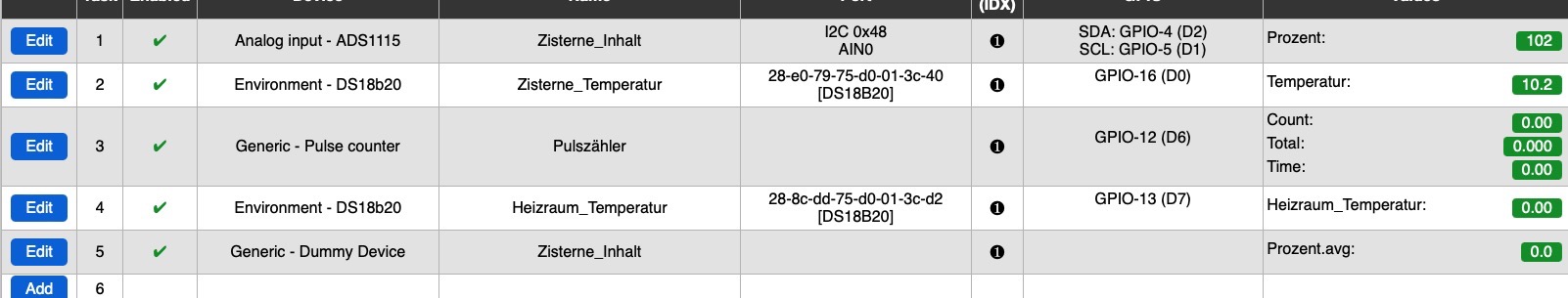

I do not understand? Here are again some screenshots.
In the rule you send me: TaskValueSet,ZisInhalt,Dummy,[Zisterne_Inhalt#Prozent.avg] were have I to write it?
#8 Post by Ath » 30 Apr 2023, 21:06
The name of your Dummy Device task should be ZisInhalt, and the Name for the Values entry should be Dummy, like you originally had, that should fix it.
The ADS1115 task is already named Zisterne_Inhalt, you can't have 2 devices (tasks) with the same name.

You have to enable the Stats checkbox on your ADS1115 task:
Screenshot - 30-04-2023 , 21_37_41.png (38.31 KiB) Viewed 3731 times
(took a screenshot from this thread, above)

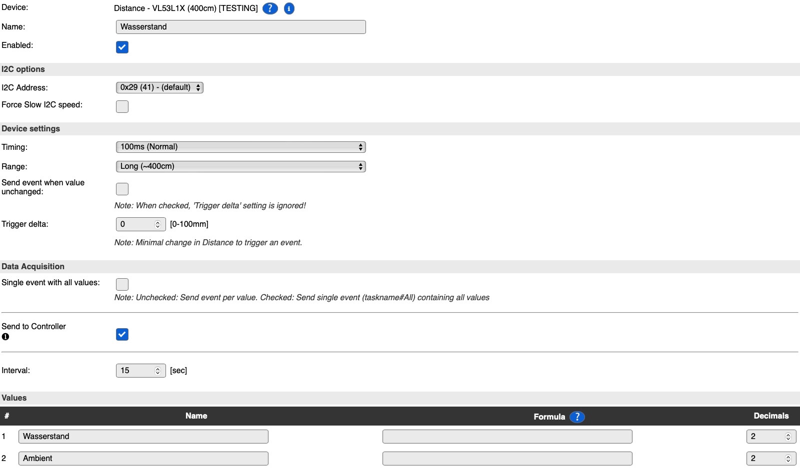

I tried to use this function with an other device. But there I do not find the Stats checkbox. Do I have to update the firmware?
#13 Post by Ath » 30 Apr 2023, 22:09
That plugin does have Stats enabled, but because it is in a Collection build the Stats feature is excluded to limit the .bin size. You would have to build a Custom ESPEasy to have that enabled.
