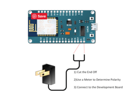

What pin did you use?
I was thinking to use the VIN and GND.
Scherm­afbeelding 2023-05-06 om 21.37.26.png (89.66 KiB) Viewed 6069 times
Re: esp8266 external power
#4 Post by Ath » 06 May 2023, 21:45
That sounds about right.

#5 Post by TD-er » 06 May 2023, 22:09
What kind of power supply are you using?
Texts like "cut end off" do sound a lot like you're just using any kind of power supply and not something that's really 5V and powerful enough to deliver a stable 5V.
Why not using an USB charge adapter? Those can be had for cheap and you can use just a simple USB cable.

#6 Post by marktn » 06 May 2023, 22:27
TD-er wrote: 06 May 2023, 22:09 What kind of power supply are you using?
I have more options as power adapter. I am testing to know what the best is. I did cut the end off :)
The problem is that I want the power adapter not near the esp8266. Because there is no place.
Between the power adapter and esp8266 is 10 meter.
Any good and stable suggestions?
I need to power 3 esp8266 boards.
