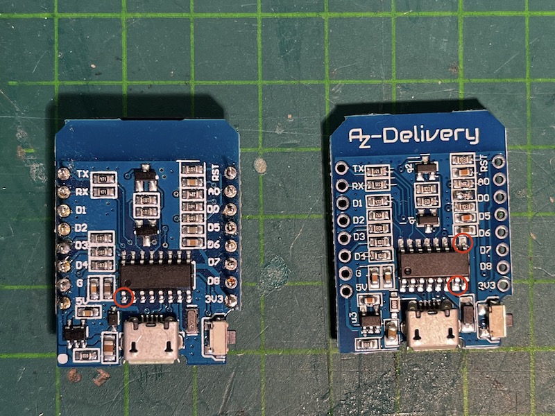

I once made a battery powered sensor using a wemos d1 mini clone.
With no modification it was drawing around 300uA of power while in deep sleep which is ok but not good enough.
With the proper modifications which included lifting the ground pin of the serial chip and a changing the ldo regulator i got the consumption down do around 50uA which is good enough for me.
Two days ago i found myself in need of a water leakage sensor. I could have simply bought one but since i found this instruction https://esp8266--server-de.translate.go ... r_pto=wapp i thought this seems easy enough since i already have all the parts i need laying around.
A quick and dirty setup and some measurements later i realized that even with the aforementioned modifications i couldn´t get lower than 1,8mA
I spend the whole yesterday to figure out what was wrong. And i found out that some wemos d1 minis without mods got down to 300uA in deep sleep and some go only down to 1,8mA.
One night sleeping over it brought me to the right path:
The serial chip!
Both type of boards have slightly different layout but the serial chip is labeled the same: CH340C
The chips are the same but the connections differ? That means one of the chip is not an CH340C since one draws significantly more power than the other (300uA vs 1,8mA!)
A continuity test revealed the ground legs of the sketchy chip, which i desoldered. New measurement: 60uA. 🥳
I hope that revelation helps some people that stumble upon the same issue.
In the picture you can see on the left the standard clone and on the right the clone with the strange serial chip.
The red circles indicate the ground pins wich need to be desoldered/lifted.

TD-er wrote: 30 May 2023, 14:04 Yep, external components are easy to overlook.
The problem with these "fake"/different serial chips seem to be their inability to enter a "sleep mode" when not in use
Good find!
