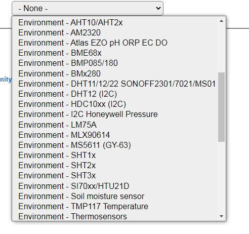

Good afternoon. used normal Build20230409_20230531075113 there was a sensor ds18b20, but there was a problem with wifi. after two or three days of work, wi-fi was disconnected and the module had to be rebooted. I thought it was the firmware and decided to change . because on another module I use Build: ESP_Easy_mega_20230409_neopixel_ESP32_4M316k Apr 9 2023, then I decided to put a neopixel. but in firmware ESP_Easy_mega_20230508_neopixel_ESP32_4M316k.factory no sensor ds18b20 :( Can I add this sensor myself? or is it better to set the climate and not fool my head?
by the way in Build: ESP_Easy_mega_20230508_climate_ESP32_4M316k May 8 2023 also no sensor ds18b20 :shock: Why?

The DS18B20 plugin has been renamed to '1-Wire Temperature', as it supports more types of the 1-wire sensor than just the DS18B20.

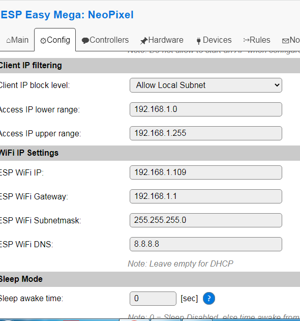

TD-er wrote: 02 Jun 2023, 19:46 What is happening? Does ESPEasy have issues resolving some DNS name?
I do not quite understand what you said, but my settings are as follows

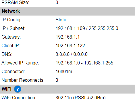

TD-er wrote: 03 Jun 2023, 12:27 you should see only 1 DNS entry on the sysinfo page (the
now I have
. and at the moment everything is working (Build: ESP_Easy_mega_20230409_neopixel_ESP32_4M316k Apr 9 2023)
but on the other firmware the settings were the same, but after a couple of days the module losted connecting to Wi-Fi and only rebooting the module helped
but now it works and I'm happy with it. Thank you
