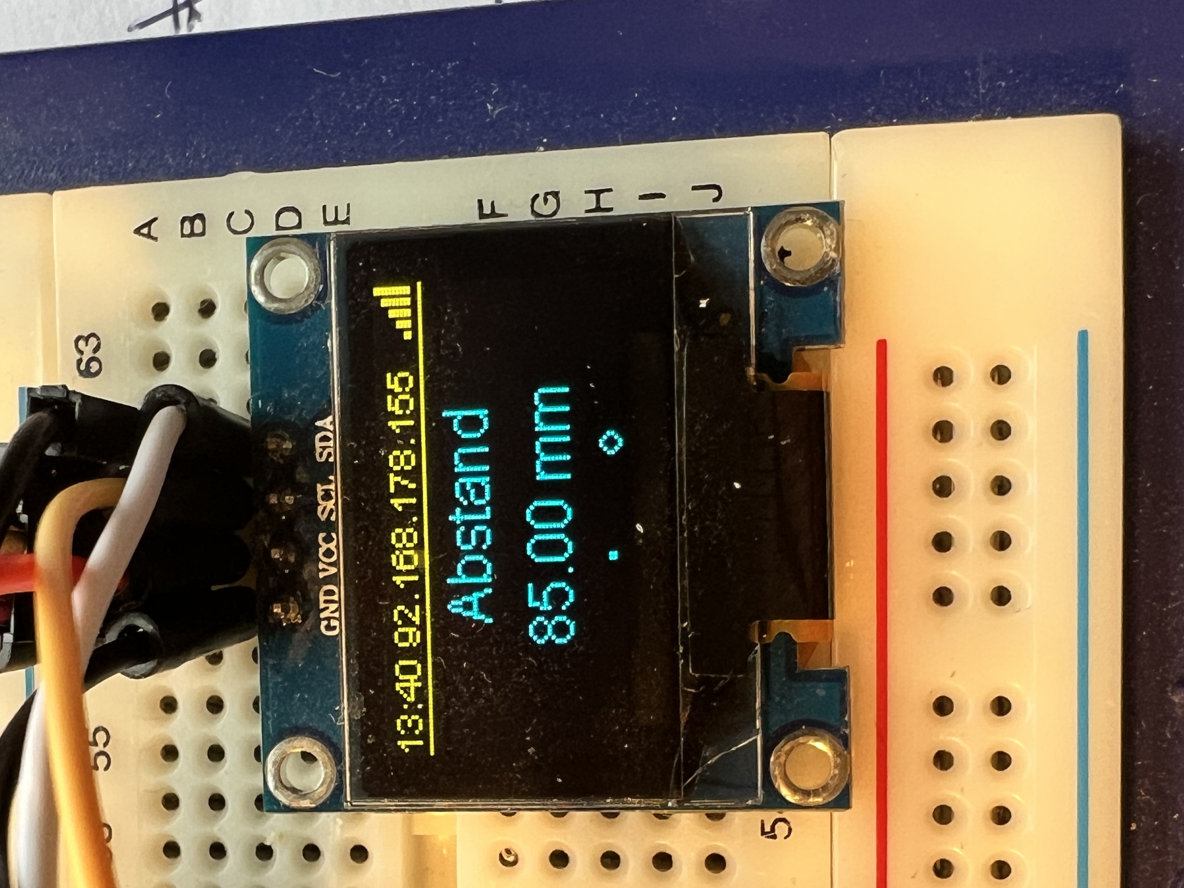

I have one more question.
I have an other ESP8266 with an OLED SSD1306 display and want now to connect a VL530X sensor, to show the distance value on the display. How do I connect the sensor to the board?
Re: GY-530 VL53L0X Laser Ranging Sensor Time-of-Flight
Both devices need an I2C connection, and as they have different addresses, you can just connect the SCL and SDA connections in parallel to the I2C pins, as configured on the Hardware tab.
Both devices also need GND and 3.3V connected of course
When configuring the display you can just use predefined text, using something like "Distance: [VL53L0X#Distance#d4] mm" (no quotes needed, just added here for readability)
Thanks, it works!

NB: Air-code... untested
On System#Boot Do // If this rule already exists, add the code to the existing On System#Boot Do rule!
LoopTimerSet,1,5 // Update display every 5 seconds with new data
On Rules#Timer=1 Do // Handle loop-timer
AsyncEvent,UpdateDisplay=[Switch#State]
On Switch#State Do // Handle switch
AsyncEvent,UpdateDisplay=%eventvalue1%
On UpdateDisplay Do // Common update display rule
If %eventvalue1%=0
OledFramedCmd,1,"Abstand [VL53L0X#Distance#d4] mm"
Else
OledFramedCmd,1,"Voltage [SysInfo#VCC#d2.1] V"
Endif
- The display should NOT have any preset Lines 1..12 configuration
- The Button should NOT be configured in the Display settings, but via a separate Switch task
