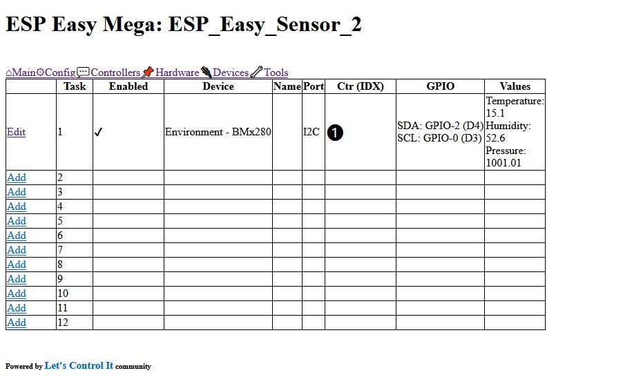

what is the reason that the web interface of some of my ESP 8266 devices look like the picture below and not like the normal design?
I know this simple web interface from connecting the first time via access point, afte connecting with my wifi the normal design is shown but now I have the simple design for running and connected devices too ?
Is the design a reason of browser settings or a general problem?

It seems like when a build was made without pygit2 installed as Python library, you do end up with a CDN url without a Git tag in the URL.
And it looks like jsdelivr is suddenly no longer accepting those URLs.

I made a quick fix, but you probably need to make a new build for it to work again (assuming you made your own build)
https://github.com/letscontrolit/ESPEasy/pull/4874

We do rely on some external service to host static files like the CSS and JavaScript files.
And all of a sudden those links are no longer working.

obstbauer wrote: 13 Nov 2023, 14:57 It is really necessary to flash it again?
No...
Use "file upload" under "/tools"
and upload the files of the attachment one by one..
Note: you need around 9kb of free space for that.. but that is usually the case

By the way, I think you can also gzip them and then upload them as .js.gz

Ah yes, have to check the source code as I have made a replacement name for it when serving embedded JS...
Rename it to upd_values_device_page.js
or upd_values_device_page.js.gz if you GZipped it..

ok I uploaded all files but it doesn't work
should I delete the "update_sensor_values_device_page.js" file ?
and upload the renamed file again ?

I uploaded "upd_values_device_page.js" but it doesn't work

#20 Post by obstbauer » 13 Nov 2023, 23:34
yes it worked :)
