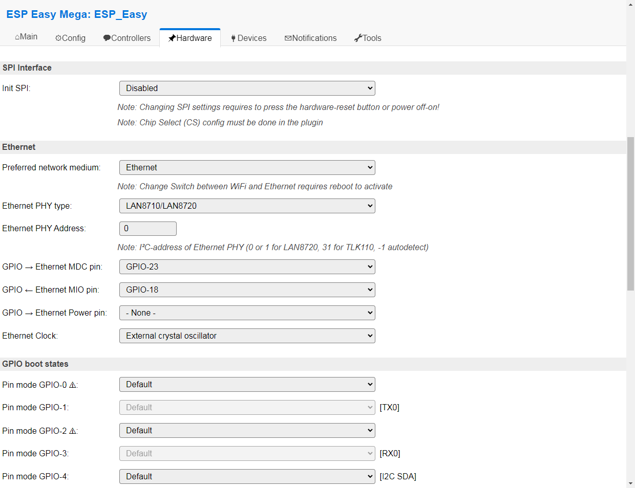

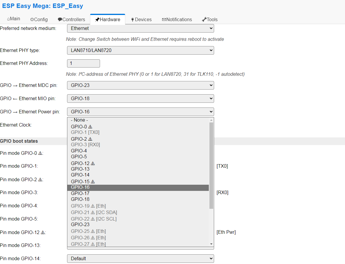

I cannot succeed. I load Pre-defined config:WT32-ETH01 add-on but eth is not work
Web yakalama_10-9-2022_18150_192.168.1.161.jpeg (65.74 KiB) Viewed 13056 times
Web yakalama_10-9-2022_18254_192.168.1.161.jpeg (301.89 KiB) Viewed 13056 times

#4 Post by TD-er » 10 Sep 2022, 17:45
In the topic linked along with the code there was a mention of GPIO-16 for the Ethernet power GPIO pin.
Can you try that pin too?

#5 Post by asuz » 11 Sep 2022, 11:49
TD-er wrote: 10 Sep 2022, 17:45 In the topic linked along with the code there was a mention of GPIO-16 for the Ethernet power GPIO pin.
When I choose GPIO → Ethernet Power pin: to 16 then submit it keeps stay GPIO 12. Should I need any physically connection?

Re: WT32-ETH01 switch wifi to ethernet
#14 Post by Ath » 12 Sep 2022, 13:49
Re-installing isn't going to help, if it does, then your ESP unit is severely broken, and should be replaced.
After selecting the other GPIO for the Power pin (and confirmed the changed setting is selected), you have pressed the Submit button, as usual, right? And waited for the page to reload?
Any pins in use for other (system-, not plugin-)purposes can not be selected from the combobox as they are disabled, even though they are listed there.
