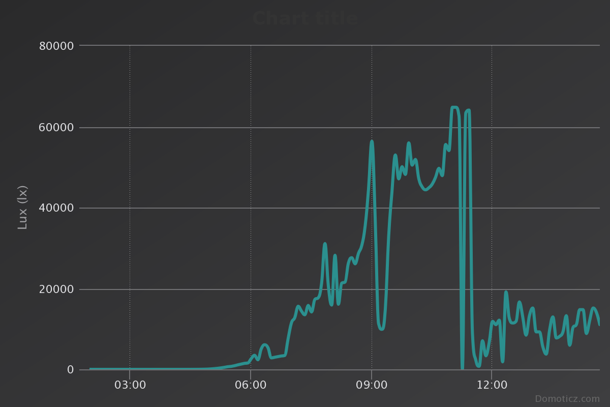

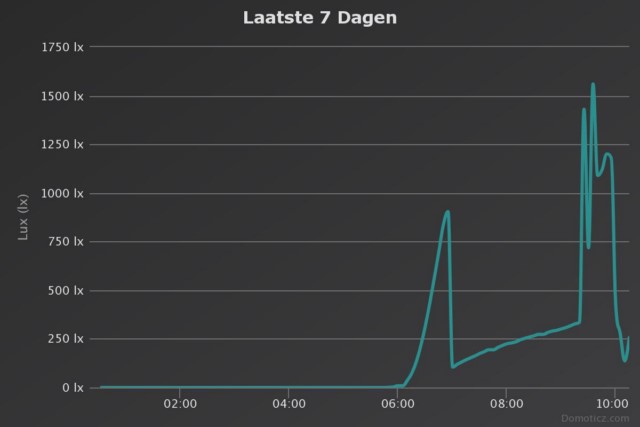

Last days with clear-blue sky and plenty of sunshine gave ample opportunity to check the operation of the 'chain' with WS7000-19 => RFLinkGateway => Domoticz.
Compared in Domoticz the readings by a colocated sensor type SI1145 (= upper graph) with the info from WS7000-19 (= bottom graph).
The graph from SI1145 is rather smoothly rising in the morning.
In the resulting curve at Domoticz for WS7000-19 it can be clearly seen that
- the line starts indicating the L-value (with F=0 => multiplier = 1)
- the line at the 1st threshold drops back to an L-value which is representative for L/10 ( at that moment should be with F=2 => multiplier = 10).
- that process repeats itself at the 2nd thresholdlevel for L/100 (& F=3 => multiplier = 100).
Looking at the numbers in both graphs, a resemblance can be seen between SI1145 and WS700-19-'clone'.
However, for F>0 the value shown for WS7000-19 seems to be lagging by a factor 10.
At this moment apparently the handling of some F-values is missing 'somewhere' in the interfaces & functions around RFLinkGateway & Domoticz

After upgrade of the firmware of RFLinkGateway and WS_Controller, the WS7000P19 was coupled to Domoticz via RFLinkGateway.
One year later looked at the year-graphs from Domoticz and surprised to see that apparently a clamping is taking place at light level of approx. 65kLux.
Any user of RFLinkGateway in conjunction with Lightsensor WS2500/19 or WS7000/19 seeing similar graph?
Obvious next question: where in functional chain Sensor > RFLinkGateway > Domoticz is this clamping happening?
At this moment difficult to check, because lightlevels too low till next spring to serve as input >65kLux.
For reference/comparison the light-curve from my Tempest PWS over the period starting April 2021 in which the higher lightlevels occur, and clearly show.

The proper solution is: research & test, finding the source of the problem and subsequent correction of related firmware.
However, it involves at least 2 elements (WS7000P19-Controller and RFLinkGateway) and bright light (> 100kLux) is needed for reproduction of the problem.
Not nice, but very pragmatic remedy for this 'problem' is following make-shift solution.
Basic approach:
If the electronic & software functions 'somewhere' in the functional chain cause the described clamping, then reduce the input at the sensor so much that no clamping occurs.
In this case it means that a real input of approx. 150kLux should result in a virtual lightlevel on the sensor of approx. 60kLux.
=> find an optical attenuation filter of approx. 2,5* and put as cover over the sensor
=> while getting actual lightlevels of 0 ~150kLux, the sensor will effectively 'see' 0 ~60kLux
=> multiply the resulting, reported value in Domoticz by 2.5* to reconstruct the entry-value

It took quite long time to get perfect weather for this test, but recently a few continuously very bright & very clear days gave opportunity to make 'unspoiled' loggings of the transmission for highlevellightdata from the WS7000-Controller towards the RFLinkGateway.
Analysis of the best logging made in the RFLinkGateway shows that 22nd of June later than 11:15 the pulse-pattern is telling that the level should be > 65klux,
but the RFLinkGateway 'shifts gear downward' and via Domoticz (as in the picture below) shows level below 65klux.
Apparently MSB present from the Controller, but missing in the data from RFLinkGateway to Domoticz.
Reported to RFLinkStuntteam, and now waiting for response.

Re: Lacrosse WS2500-19 brightness sensor
Very clear sky today and nice spring weather is good for testing the readout for high levels of Light and UVI.
The graph below well demonstrates that the RFLinkGateway does not process the MSB of 65kLux for WS7000P19:
between today approx. 10:30 and 16:00 the graphline 'dips', although a level higher than 65kLux is expected,
Tempest-readout for comparison shows levels running up to 133kLux.
The sensor MAX44009 of WS7000P19 is also able to 'see' those values within it's technical range of 188kLux,
and therefore it would be nice if RFLinkGateway would correctly transfer the actual value.
Included in the next upgrade of the firmware for RFLinkGateway?
From 'repair' of the BH1750 in my DIY-setup now have a spare Dome for a BH1750.
In that DIY-setup have to calibrate/align the BH1750-with-dome and the TLS2561s:
that would provide data how much the dome is attenuating, and such data might be interesting to consider the spare dome as cap over the MAX44009.
First observation is that attenuation is approx. 3*
As makeshift interim solution pending a preferred upgrade of the RFLinkGateway's firmware,
it provides a practical (but inaccurate) range extension from max. 65kLux towards max. 195kLux.
For 2023 not an urgent matter, because the actual, practical values for 'naked' MAX44009 presently under 65kLux and seasonrelated decreasing.
