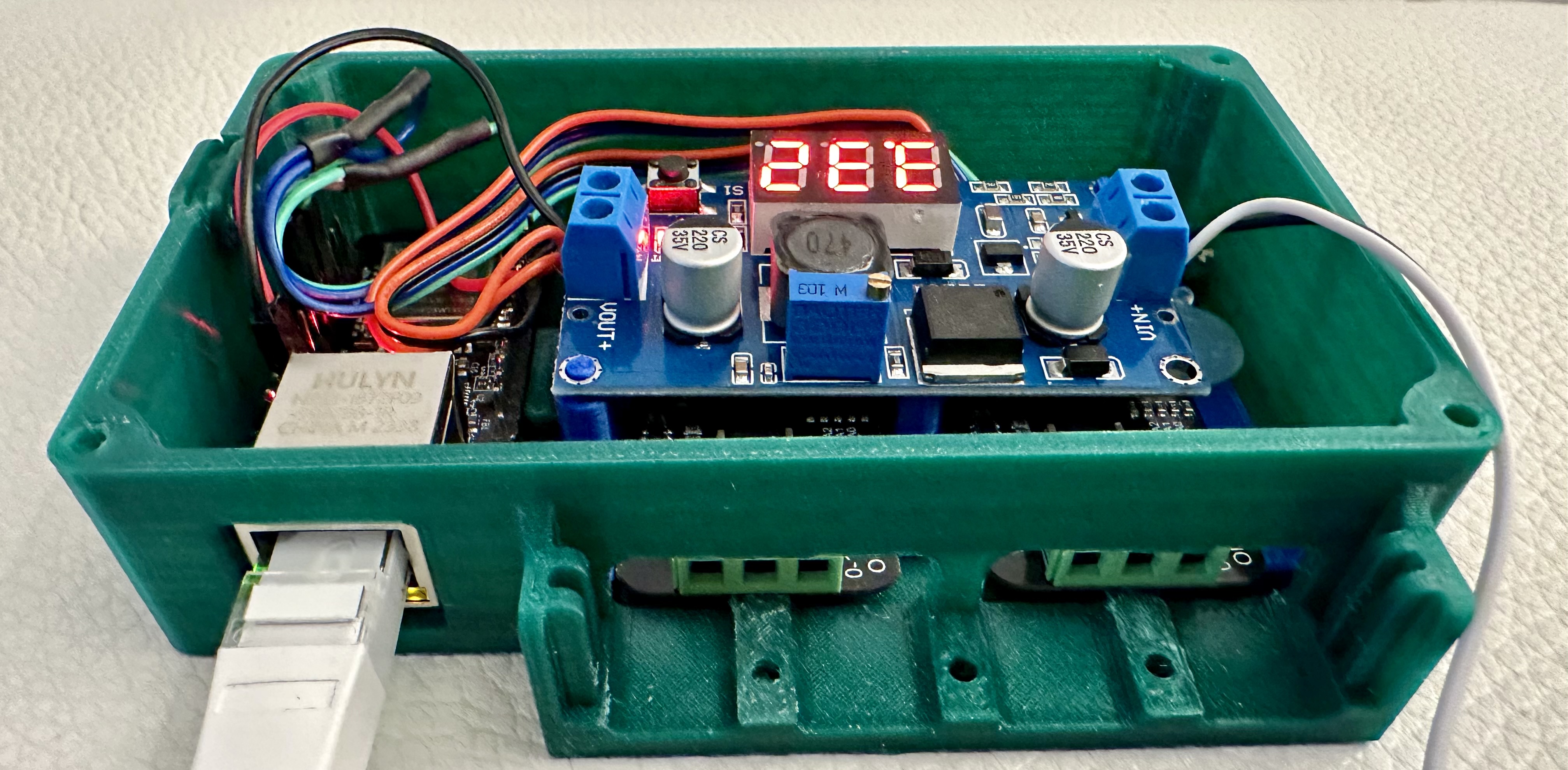

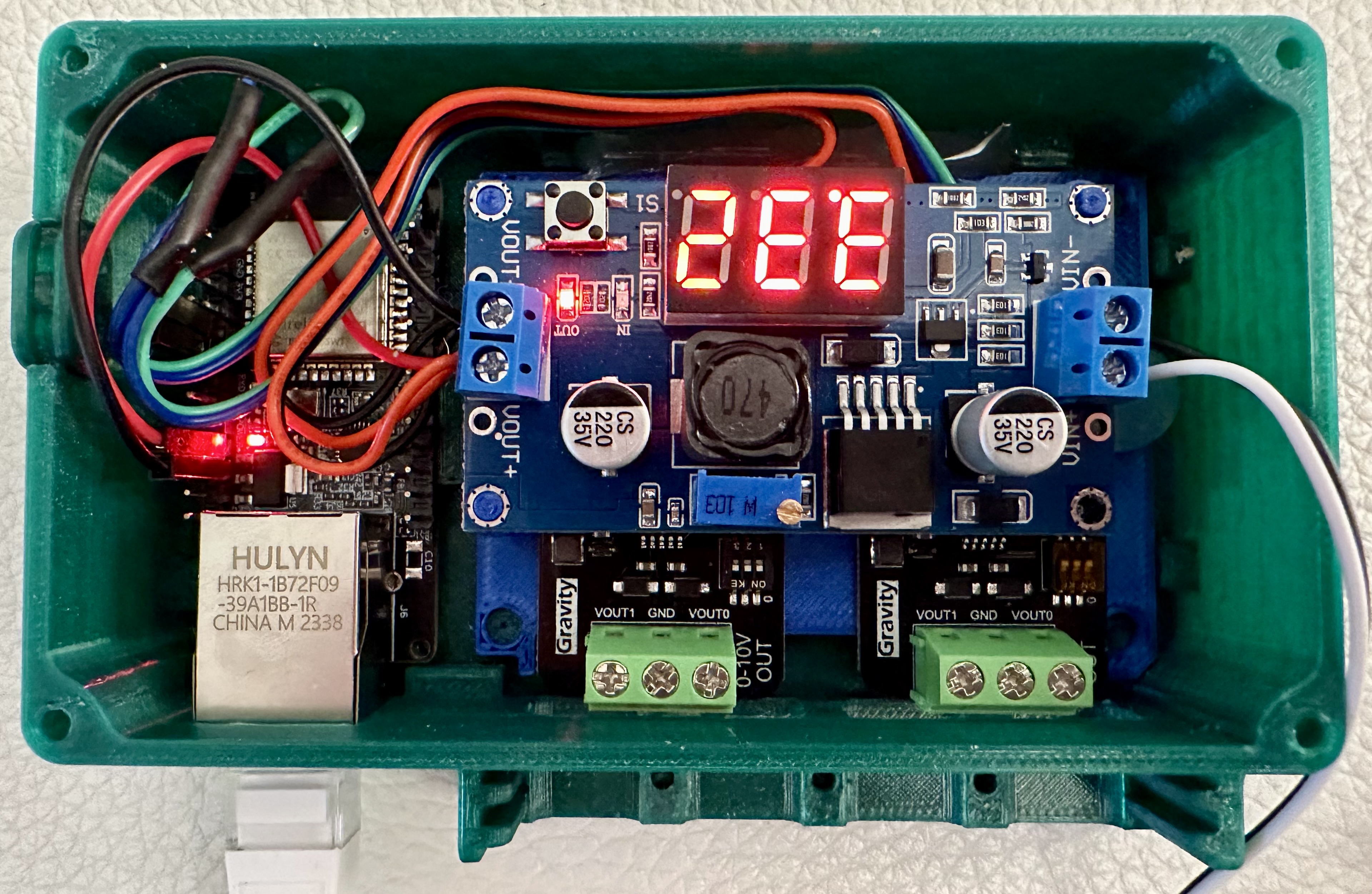

#112 Post by localhorst » 31 Jan 2024, 09:17
For "stress testing" the unit, I've made a script in ioBroker yesterday. It switches the output voltage of each DAC channel every minute to a random value 0-10V.
This morning the unit was dead again. Not reachable, the both LED of the LAN not flickering as normal, only periodically blinking - like every 2 seconds on/off.
On the DAC I measure 0V on both channel 0 - on channel 1 I can still measure 6V and 8V. This matches the last returned values to ioBroker.

#115 Post by localhorst » 31 Jan 2024, 09:46
Ath wrote: 31 Jan 2024, 09:36 but when running the DAC board at 5V, then the I2C bus should use a level converter, as the ESP only accepts 3.3V on the GPIO pins
Might this be a reason for my crashes? All, the board as the DACs, are getting 5V currently. Do I need some gentle, fishy slaps again? :?
I'll change to 3.3V now, disable logging and see...

Re: Analog output 0-10V?
#116 Post by TD-er » 31 Jan 2024, 10:28
The ESP8266 should be 5V tolerant, as it has internal diodes to clamp to 3V3 if higher voltages are applied to a GPIO pin.
However this doesn't mean it is a good idea to do so as other I2C devices might not be 5V tolerant.
Also those diodes may pull the "high" level of the I2C signals to a level which may be close to the "low" level when considering 5V TTL level signals.
This can cause the I2C device and the ESP to get out of sync.
This should not cause hangs, but it can keep the ESP busy for too long so it can loose WiFi connection.

#117 Post by localhorst » 31 Jan 2024, 10:47
Thank you again!
So, from what I understand, it's in general not a good idea to power the ESP32 and the I2C devices with 5V.
So I'll leave the whole unit now running on 3.3V with ioBroker switching the output every minute. Switching with 2 sec offset each channel to a random voltage 0-10V. Let's see if it crashes again.
(German) documentation of making a decentralized ventilation system with heat recovery smart, based on CO2 sensors with ESP Easy: https://luft.breest.eu
#118 Post by TD-er » 31 Jan 2024, 11:00
Powering the ESP directly with 5V (thus not using a voltage regulator) is absolutely a bad idea.

Already some wrap-up for this project, the unit is running fine since a couple of days and will be integrated in my automation next week:
If someone wants to build the same unit: Power board/ step-down module used: LM2596S Step-down Module or Shop link
