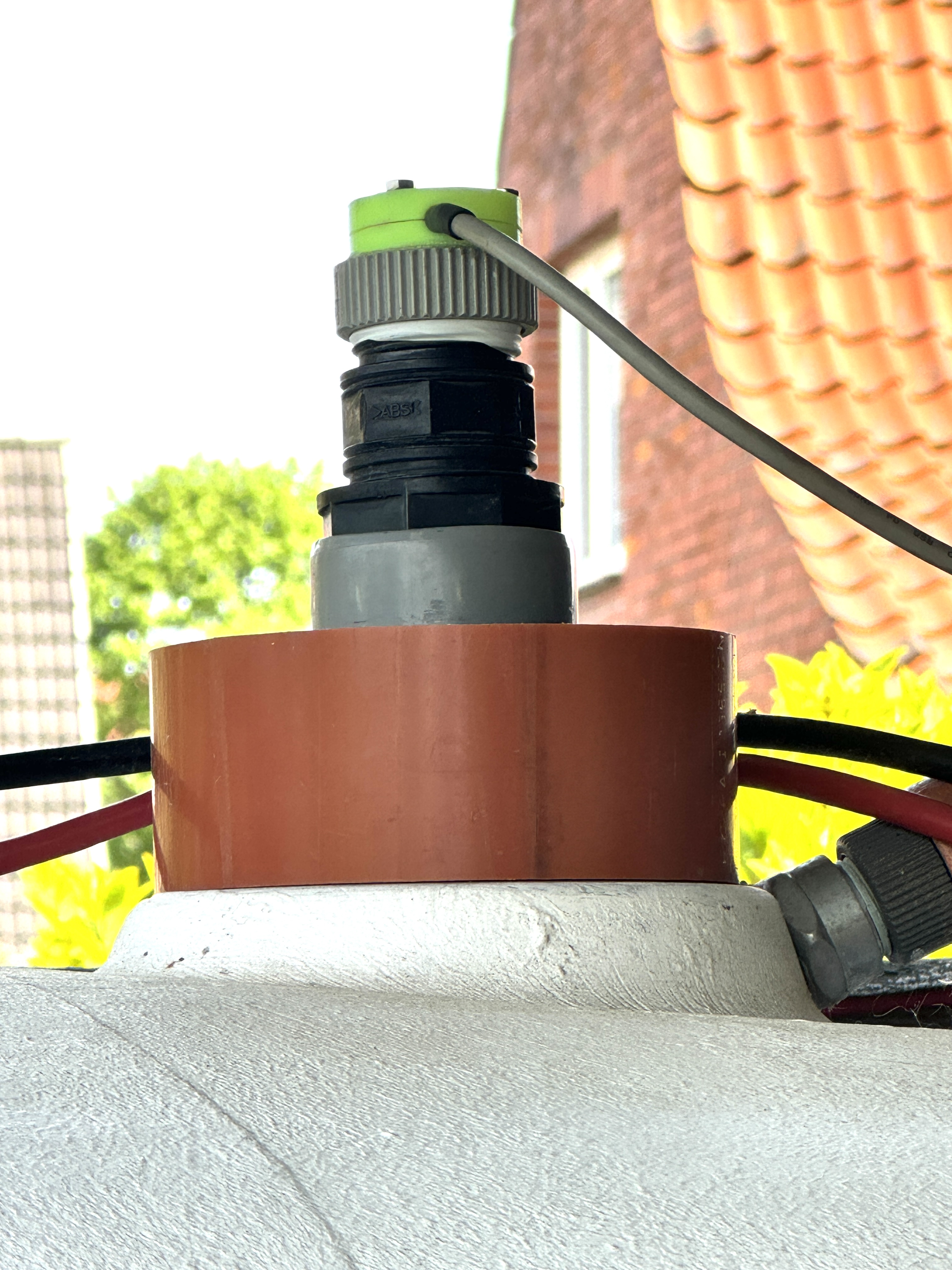

Thanks, I will have a look on it. Actually I built a housing for the sensor and tried to make it close against humidity, because it is direct over the filler neck. The water level is in 30cm. To open the housing it is a little difficult.
