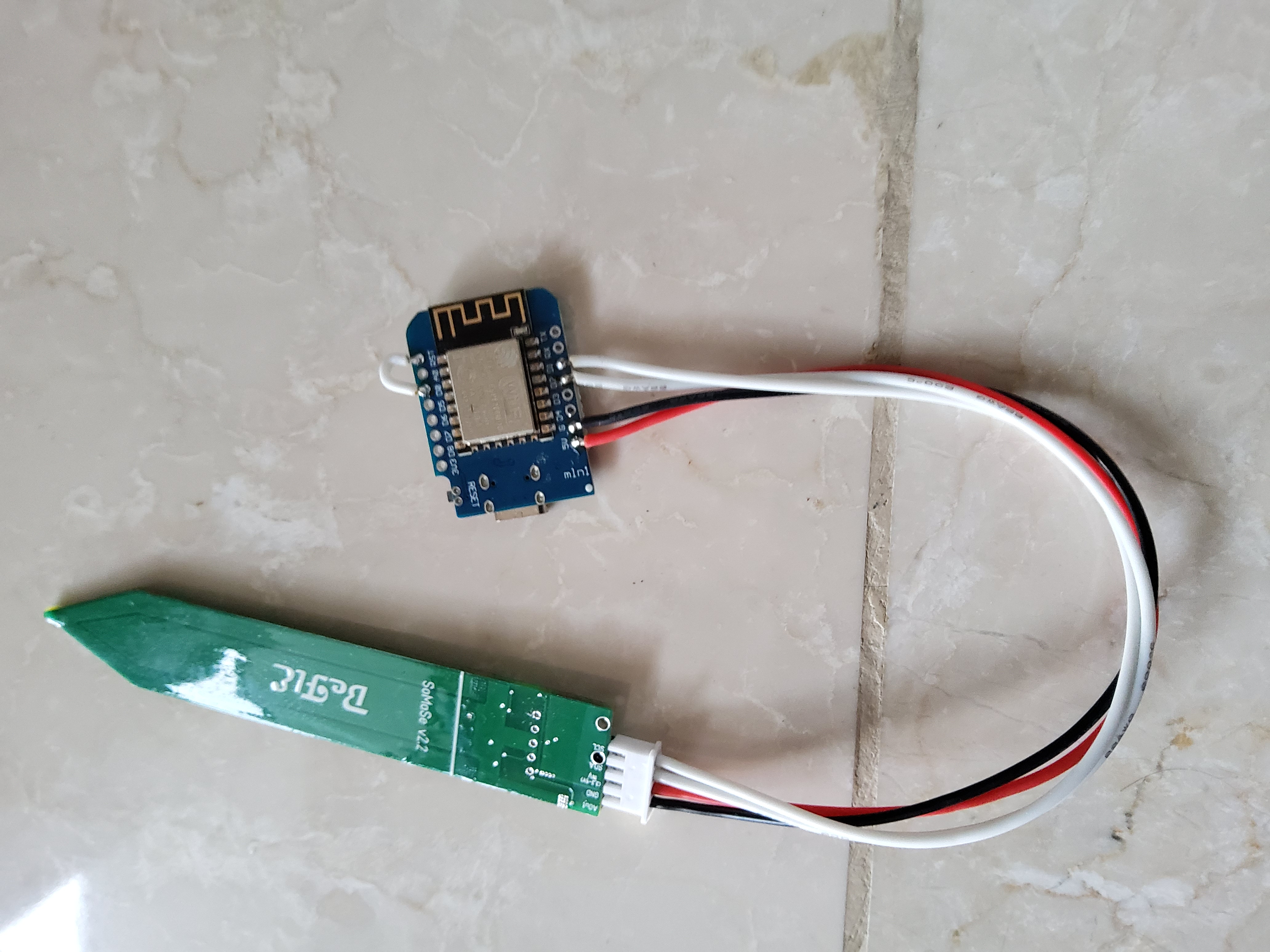

I how flashed the Collection_C Firmware and configured BeFIE Sensor AS device. SDA: GPIO-4 (D2) and SCL: GPIO-5 (D1) but I get no readings. Voltage of the sensor ist connected correctly to 5V of the Wemos D1 mini.
What ist going wrong? How can I debug it?

Thank you. I2C scan Said "No devices". I reattached the cable and now it's measuring without resoldering. Values are a bit off, i.e. temperature about +6°C. Moisture weg is around 140 which should be 100 as maximum.

sptotal wrote: 30 Sep 2023, 12:09 Voltage of the sensor ist connected correctly to 5V of the Wemos D1 mini.
I'd suggest to connect the sensor to 3.3V, as the GPIO pins of the ESP are not really specified for 5V, though there are some ppl using that all the time, it's still not advised.

3.3V instead of 5V seems to be the solution. Now I have really consistent readings which seems to be true if nothing changes.

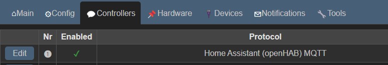

That's the MQTT Controller:

A few questions:
- How long are the wires to your sensor?
- Do you have pull-up resistors installed on the SDA and SCL lines?
- You didn't swap the SDA and SCL wires? (no harm, but won't work)
- Was the sensor used by someone else before you got it, and reprogrammed it to I2C Address 0x01?
- I assume you changed your config to use 0x01 as the address, but you can reconfigure it to something else, by setting the checkbox "Change Sensor Address", and filling the desired hexadecimal value for the new address (0x55 ?) and saving the settings. On next start (immediately if the task is enabled) it will be updated. (Fixed it in this PR as it has a bug in the current release version :o)
sptotal
Posts: 14
Joined: 29 Sep 2023, 15:44
Re: Moisture Sensor from BeFlE
#40 Post by sptotal » 14 May 2024, 09:26
- The sensor has original cable length as it was on SoMoSe v2.2 with total length of 60cm.
- I can not detect any pull-up resistor on SDA/SCL.
- SDA (D2) and SCL (D1) are connected correctly in same order as the "old" SoMoSe v2.2.
- The sensor is a prototype which was send me from the inventor of this soil moisture sensor. He has developed the Arduino code and it should work.
- I did not change the address to 0x01, it was originally this value. Maybe it's wrong as changing the address does not work, too. After changing address to 0x15, I2C scan always reports 0x01 only.
I2C scan does not recognize the supported device.
#41 Post by Ath » 14 May 2024, 09:51
I2C Scan should at least list the address, the device names may be excluded, not sure if these names are included in the Custom build.
You can enter the found address in the I2C Address field, but I assume you already tried that.
Adding a 10k pull-up to 3V3 on both SDA/SCL should fix the pull-up state.
To me it feels like the hardware wasn't programmed as intended, I assume BeFlE/SoMoSe can help you identify the status of the device, hopefully they have a Reset to factory defaults-procedure...

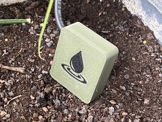

#42 Post by Elektroarzt » 02 Jun 2024, 13:57
For everyone who needs a complete device around this great sensor, I released an open source mains power supplied soil moisture sensor around it on Github: https://github.com/Elektroarzt/floragrow
Klein (FloraGrow Sense PS overview).jpeg (14.44 KiB) Viewed 18085 times
