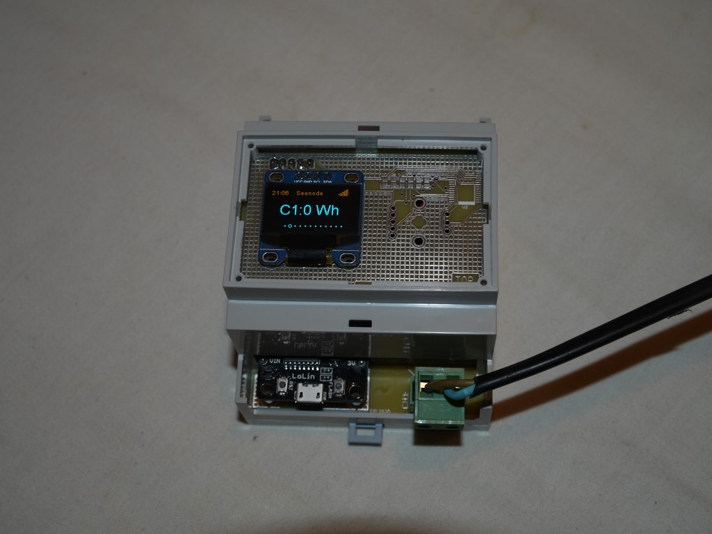

Hi there,
We just finished first protos of our box for NodeMCU and Oled Display.Main feature are:
- Din Rail enclosure (4U)
- Internal power supply (240Vac)
- 4 optocoupled inputs (Pulse counters S0 or Thermo DHT/18B20)
- 2 Relays 16A with NC, NO
- Optional Oled Display board
If somebody is interested in getting it, pls send me a PM.
We are defining versions (with or without OLED), quantities, prices.
I'll be back with info very soon....
Here are some pics: Regards
Paolo

It looks like the ESP8266 antenne is encapsulated between 2 printed circuits with lots of copper.
Will this not limit the send/recieving?

Thnx for yr interest.
@nietgiftig: The sample is running well, even with a -91db wifi strenght (box closed).
I'll be back asap with more info.....
Paolo
Paolo
