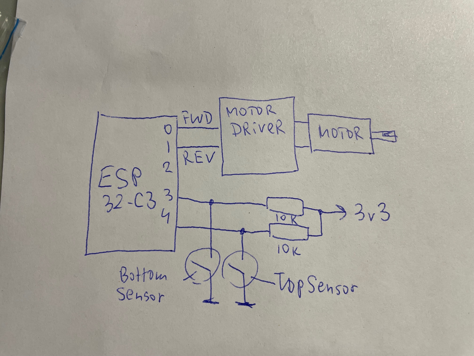

Good afternoon. I'm making a roller blind controller using EasyEsp.
I'm using the P098 PWM Motor plugin. The motor is started with the pwmmotorhome and pwmmotorend commands.
Sensors LimitA and LimitB are configured.
When the sensors are triggered, the LimitA and LimitB events are not generated, although the motor stops.
Events are created only if I try to start a motor that is already in the extreme position.
What am I doing wrong?
