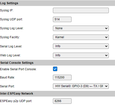

#4 Post by BartSr » 31 Jul 2024, 13:38
@ Ath
Are these the answers you are expecting?
-Bart

#5 Post by Ath » 31 Jul 2024, 13:50
Thanks for the info. I was asking about the P2P Controller, available in the Controllers tab, but as that doesn't seem to ring a bell, you are probably not using it ;)
(The only reason I could think of was that by saving a task on a unit with the P2P Controller enabled it could have updated a task with the same tasknumber on another unit, also having the P2P Controller active. But that would only be possible if that tasknumber is unused on the receiving unit, which it isn't. (Sorry for the probably confusing mind-boggle I had when reading your issue).)
