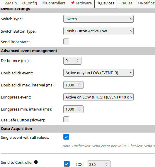

Config like this
Capture d’écran du 2024-08-07 13-00-38.png (64.64 KiB) Viewed 8141 times
With 1 shortpress event, I got the state value 1. An other shortpress : state value 0. Everything is fine !
But : when I am trying a longpress event, I am expecting to get state value 10 or 11. But the state value stays on 0.
Same with doubleclick event, I am expecting value 3 : the state value goes from 0 to 1 or 1 to 0 (not each time)
I don't understand what I am doing bad... I would like to use the longpress event to manage an event in Domoticz and adjust a dimmer.
About the doubleclick event, it is useless because not user friendly, but I find funny to get an "hidden" function :D
So, if anyone has an idea... Many thanks in advance !

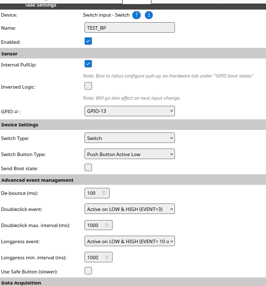

- I modify the debounce value to 100ms (instead of 0) like this
Capture d’écran du 2024-08-10 16-34-10.png (48.11 KiB) Viewed 8002 times
- I modify the circuit like this :
5V --- R1 --- GPIO --- R2/C1 --- GND
where
R1: 4k7
R2: 10k
C1: 100 nF
You can see that on the picture.
Green wire linked to GPIO D13
Blue wire linked to 5V
Purple wire linked to GND
And nothing more than before : pushbutton works on single event (state changes from 0 to 1 and 1 to 0). But no state 3 or 10 or 11 as expected for double click or longpress.
I also tried in 3.3V with the same circuit (and without) : no change.
About longpress : the state change from 0 to 1 (or 1 to 0) before I release the button. Like if the board does not care I still press the button...

Hmm, the Doubleclick max. interval and the Longpress min. interval might be too close to each other, causing both to be ignored.
You could try with the Doubleclick max. interval set to 800 msec, to see if that un-confuses the plugin?

You can not put a value lower than 1000ms.
But I put 1000ms to double and 1200 to longpress.
Unfortunately, no change.
No state 3 or 10 or 11.

You have the switch configured for "Push Button Active Low", but that should be set to "Normal Switch", even when using push-buttons.
The Push Button types can not be used with Longpress and Doubleclick, as these types have to be pressed again to revert the state, so they would always be long-pressed, and that doesn't make sense.
Naming that switch type "Push Button" might seem weird, but it's been this way for a long time, and there is no better way of naming these types. So, 1st push switches from Off to On, 2nd push switches from On to Off.
You did not say, but perhaps you are viewing ESPEasy's Devices Tab page for the state values. Be aware that only states 0 and 1 are reported in the ESPEasy Browser. You will not see the other state values there.
Also, double press may be unreliable if serial log is enabled. And in some cases a brief single press event can be missed too. So disable serial log during your testing to avoid this problem.
And it is not clear to me if your switch is a common push switch (only active while depressed), which is what your application should use. The translated datasheet description appears to be a push on, push off switch (mechanical toggle), which in this case is not the correct type. Your continuity tester will confirm what you have; It should only beep when the switch is being pressed.

Ath,
I changed Push Button Active Low to Normal switch but I don't see the states I am looking for (3 or 10 or 11).
And now the behaviour is state still on 1 except when I press the button.
So maybe I could work with this in a Domoticz script.

And I also enabled "Inversed logic", so my button can connect the GPIO to GND to activate, that usually makes things more clear.

NB: When using the Longpress (10/11) and Doublclick (3) events, you will also get the standard State event of 1.
