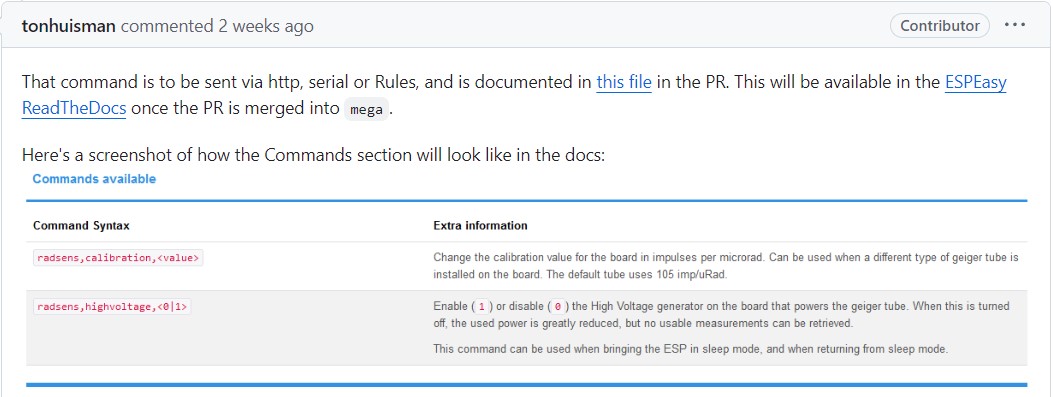

Why can't we implement editing the calibration constant with a command like this?
This is implemented in the P136 RadSens plugin
Снимок экрана 2024-09-04 120937.jpg (84.07 KiB) Viewed 4026 times
Re: calibration BH1750 sensor
#4 Post by Ath » 04 Sep 2024, 12:04
bubastic wrote: 04 Sep 2024, 11:14 Why can't we implement editing the calibration constant with a command like this?
Several reasons, the first being that is a plugin developed early in the ESPEasy project, when command handling wasn't very wide-spread yet, and probably nobody thought of that being wanted at some point.
Another reason not to add it now is that this plugin is available in nearly all builds, and ESP8266 builds are already very cramped in .bin size, so adding more features there will cause (more) technical issues.
It's implemented in the RadSens plugin because one needs it when using a tube with different specs, but that's quite uncommon, so no need to implement in the UI settings, and the setting is (according to the RadSens documentation) stored in the controller-board, and not in ESPEasy.
For this plugin IMHO, there isn't much reason to change the accuracy on the fly, and for calibration, a formula seems more appropriate, as there is no setting available in the sensor or ESPEasy to adjust.
The RadSens plugin is intended to be used with an ESP32 board, where more .bin size is still available (though not unlimited). (in fact, ESP8266 is deprecated for use in new projects, as even Espressif has set it's status to End-of-life)
