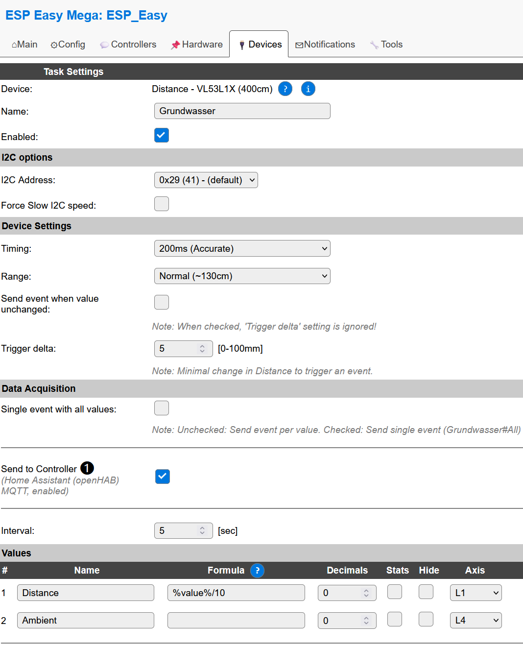

In the value section of the configuration page there are are fields like Stats, Hide, Axis.
I haven't found any description what they mean. Esp. for Axis there are option L1-L4 and R1-R4?

here is a screenshot from the device configuration page

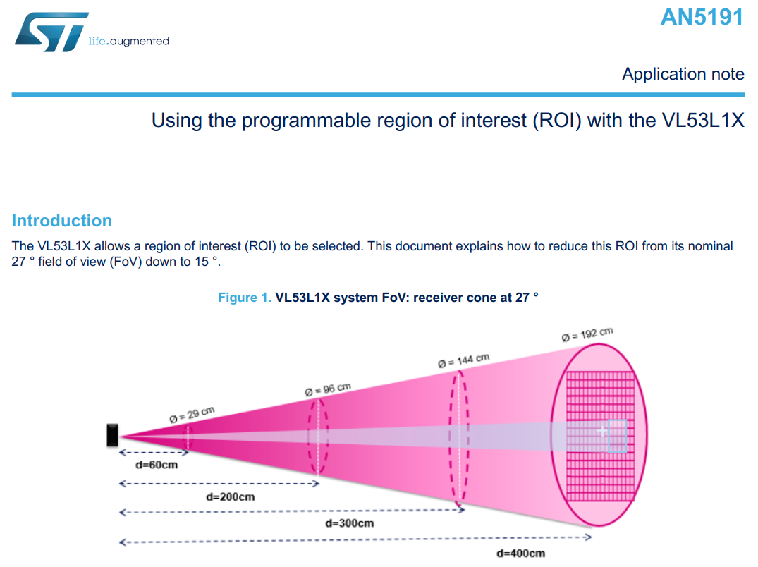

regarding the ROI i have attached another screenshot, it talks about how to reduce this ROI from its nominal
27 ° field of view (FoV) down to 15 °

That's the Axis where the statistics graph draws the scale/range for that value in the graph. It's just not updated in the documentation yet.
The L1..4 is drawn at the left side, and the R1..4 at the right side of the statistics. If the range of the values is (nearly) the same you can have multiple values on the same axis (they used to be all on the same axis), but if the ranges are far apart it would reduce the usability of the graph.

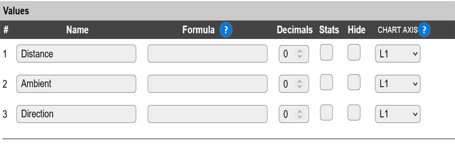

Maybe I should change it to "Chart Axis" ?
That will help. And for extra credit, add a "info" hyperlink balloon tag to the RTD. Like the Formula column uses in the Values box.
Mockup Example:
Hyperlink Info Tag
Hyperlink Info Tag
