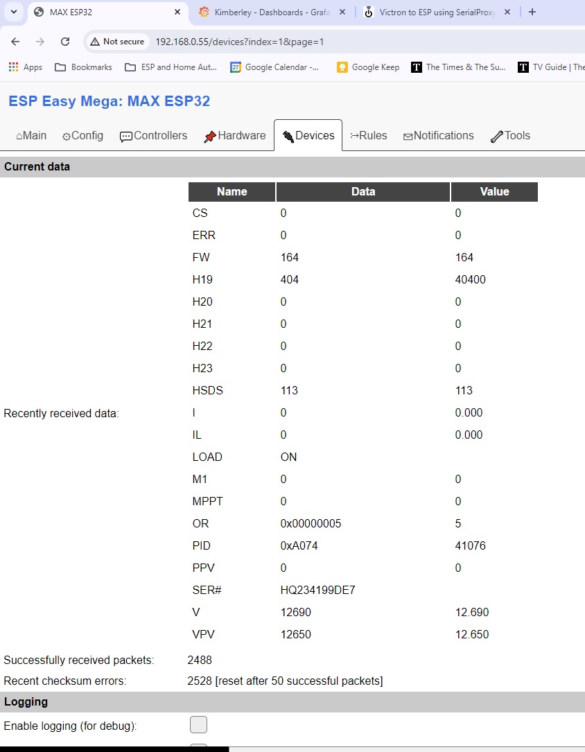

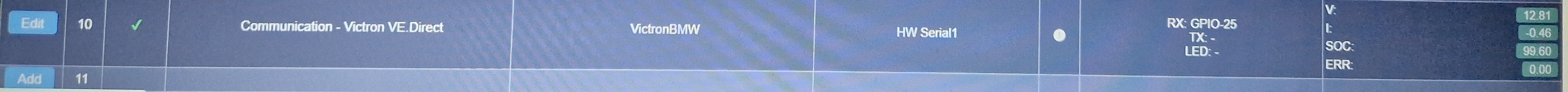

#60 Post by giorgino » 27 Oct 2024, 13:32
I'm testing onboard :ugeek:
something is going wrong
The readings exists in the device, but can't read in rules
Screenshot 2024-10-27 132423.png (51.6 KiB) Viewed 13726 times
Screenshot 2024-10-27 132324.png (48.79 KiB) Viewed 13726 times
Screenshot 2024-10-27 132102.png (22.6 KiB) Viewed 13726 times
Re: Victron to ESP using SerialProxy plugin
#61 Post by Ath » 27 Oct 2024, 13:34
What have you written in Rules so far?
#62 Post by TD-er » 27 Oct 2024, 14:04
Also can you set it to HW Serial1 (if not used elsewhere) to make sure there isn't a conflict with the ESPEasy console?

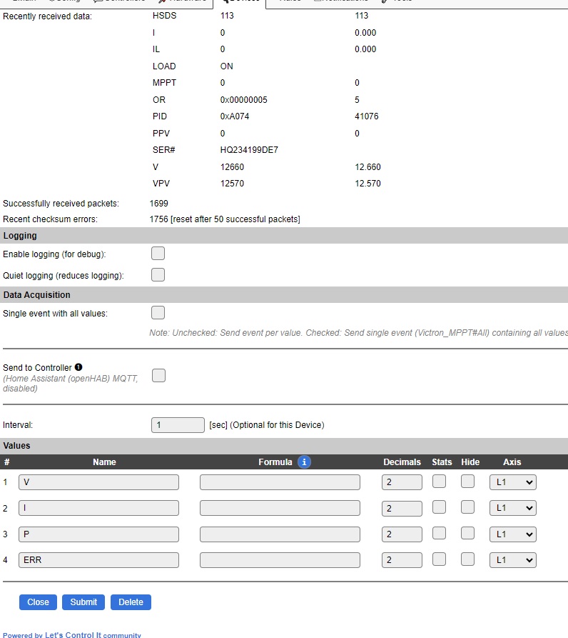

giorgino
Posts: 126
Joined: 24 Oct 2022, 21:06
#63 Post by giorgino » 27 Oct 2024, 14:22
in the DEVICE summary screen there is:
V:0.00
I:0.00
SOC:0.00
ERR:0.00
but inside the DEVICE screen it is allright...
This is strange, do you?
note: with HWSERIAL 1 noting has change
giorgino
Posts: 126
#64 Post by giorgino » 27 Oct 2024, 14:26
and this is some (testing) rules:
on Victron#All Do
  Publish,'VictronBMW#V',[VictronBMW#V]
on Clock#Time=All,**:** do    // will run ogni minuto
  Publish,'VictronBMWvoltage',[VictronBMW#V]
  Publish,'WaterLevel',[DimmiWaterLevel#GetLevel]
#65 Post by Ath » 27 Oct 2024, 14:57
Task configuration:
- Using HW Serial1 is better than using HW Serial0, as HW Serial0 by default used as the serial console & log, unless you disabled that.
- You have left the Interval at the default of 0, so no read of these 4 values is performed. I'll change the inner workings so these values will always be up to date, and not only set when the interval expires or an explicit TaskRun is executed.
To send out the values to the configured Controller, the Interval has to expire or an explicit TaskRun command given.
Rules:
- If you had tried another non-zero value, like Alarm or TTG, you would have gotten the matching value, as that's obtained from the received data directly.
- The on VictronBMW#All do event is only generated if the corresponding checkbox in the Task configuration is enabled, and in your screenshots it isn't...
- Using VictronBMW#V for a MQTT topic is invalid, AFAIK, as the # (hash) is the wildcard symbol in the MQTT ecosystem.
I'll add a counter with the correctly received number of packets.
NB: A packet in the Victron VE.Direct world is a block of data between 2 Checksum lines, and depending on the number of datafields available in the device, there are usually multiple packets needed to receive all data from the device.

#74 Post by giorgino » 27 Oct 2024, 23:21
sorry that I can't test it now, the system is on my boat, far from here. I'll back onboard in 2 weeks.
Now I can only try to collect the data publishes from the MQTT throw the controller, and place them on my portable dashboard (HA dasboard on smartphone)
In the meantime I will continue my studies in the RULE syntax. Another goal will be how to have my preferred plugins on a single chip (Victron, Nextion, gps, and something capable to listen the NMEA code)
thank you very much for all this assitance !

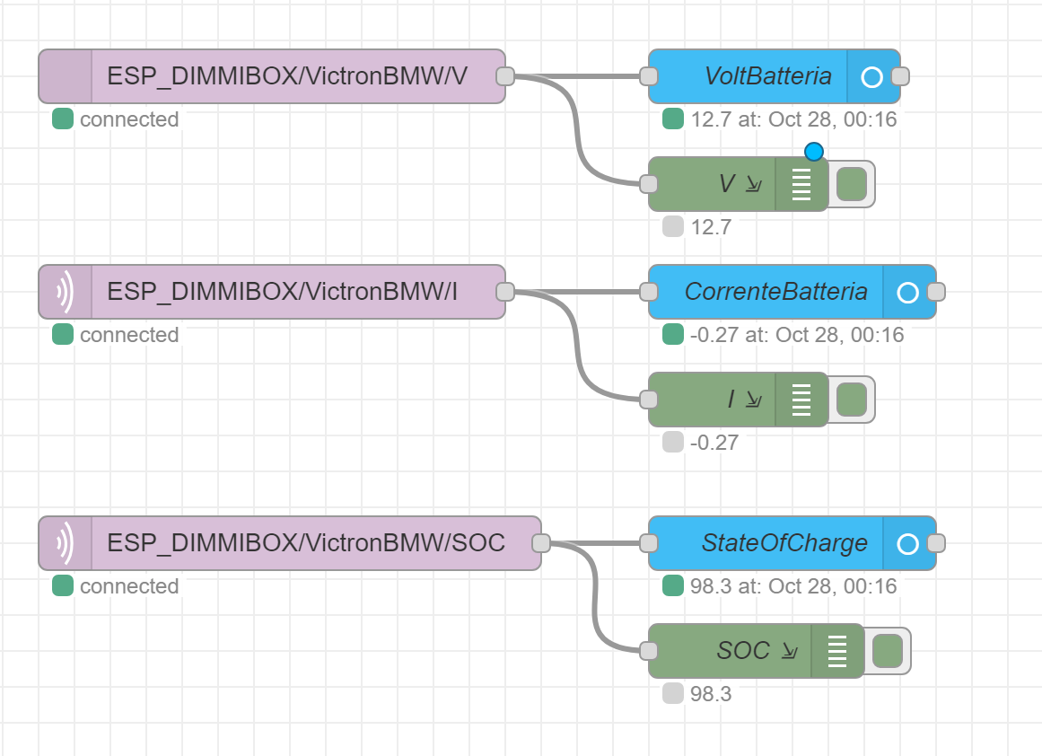

#76 Post by giorgino » 28 Oct 2024, 00:18
Already working !
Screenshot (9).png (49.69 KiB) Viewed 13625 times
Screenshot (8).png (106.5 KiB) Viewed 13625 times
#78 Post by Affinite » 28 Oct 2024, 23:46
Ath, thanks for a really quick response to the request for the Victron plugin.
P176 seems to work really nicely but I have been getting a few checksum errors.
In fact I'm getting 1 for every full packet of data received.
Should I be concerned or is there a little issue there ?
Screen shot of the error count attached:
Here are my (test) rules
on mqtt#connected do
  LoopTimerSet,1,30
  asyncevent,sendvaluestomqtt
on Victron_MPPT* do
  TaskValueSet,Battery_Voltage,Volts,[Victron_MPPT#V]
  TaskValueSet,Panel_Voltage,Volts,[Victron_MPPT#VPV]
  TaskValueSet,Yesterdays_Power,Watts,[Victron_MPPT#H23]
on sendvaluestomqtt do
  publish,Kimberley/pv.panel.voltage,[Victron_MPPT#VPV]
On Rules#Timer=1 do
Log dump follows:
35065212: ACT  : TaskValueSet,Panel_Voltage,Volts,0.030
35065215: taskValueSet: TaskValueSet,Panel_Voltage,Volts,0.030  taskindex: 2 varNr: 0 result: 0.030000 type: 1
35065216: P176 : getReceivedValue Key:h23, value:21
35065217: ACT  : TaskValueSet,Yesterdays_Power,Watts,21
35065220: taskValueSet: TaskValueSet,Yesterdays_Power,Watts,21  taskindex: 3 varNr: 0 result: 21.000000 type: 1
35065224: P176 : Processing data 'HSDS 112', checksum: 196
35065224: P176 : Checksum state: 5

35079216: P176 : getReceivedValue Key:h23, value:21
35079217: ACT  : TaskValueSet,Yesterdays_Power,Watts,21
35079220: taskValueSet: TaskValueSet,Yesterdays_Power,Watts,21  taskindex: 3 varNr: 0 result: 21.000000 type: 1
35079225: P176 : Processing data 'HSDS 112', checksum: 196
35079225: P176 : Checksum state: 2
35079226: EVENT: Victron_MPPT#P=6.49
35079231: ACT  : TaskValueSet,Battery_Voltage,Volts,12.75
35079234: taskValueSet: TaskValueSet,Battery_Voltage,Volts,12.75  taskindex: 1 varNr: 0 result: 12.750000 type: 1
35079235: P176 : getReceivedValue Key:vpv, value:30
35079237: ACT  : TaskValueSet,Panel_Voltage,Volts,0.030
35079239: taskValueSet: TaskValueSet,Panel_Voltage,Volts,0.030  taskindex: 2 varNr: 0 result: 0.030000 type: 1
35079241: P176 : getReceivedValue Key:h23, value:21
35079242: ACT  : TaskValueSet,Yesterdays_Power,Watts,21
35079245: taskValueSet: TaskValueSet,Yesterdays_Power,Watts,21  taskindex: 3 varNr: 0 result: 21.000000 type: 1
35079249: P176 : Validate next checksum
35079559: P176 : Processing data 'Checksum h', checksum: 127
35079559: P176 : Checksum state: 3
35079559: Victron: Checksum error, expected 0 but got 127
35079560: EVENT: Victron_MPPT#ERR=0
35079566: ACT  : TaskValueSet,Battery_Voltage,Volts,12.75
35079569: taskValueSet: TaskValueSet,Battery_Voltage,Volts,12.75  taskindex: 1 varNr: 0 result: 12.750000 type: 1
35079571: P176 : getReceivedValue Key:vpv, value:30
35079572: ACT  : TaskValueSet,Panel_Voltage,Volts,0.030
35079575: taskValueSet: TaskValueSet,Panel_Voltage,Volts,0.030  taskindex: 2 varNr: 0 result: 0.030000 type: 1
35079576: P176 : getReceivedValue Key:h23, value:21
35079577: ACT  : TaskValueSet,Yesterdays_Power,Watts,21
35079580: taskValueSet: TaskValueSet,Yesterdays_Power,Watts,21  taskindex: 3 varNr: 0 result: 21.000000 type: 1
35079739: P176 : Processing data 'PID 0xA074', checksum: 0
35079739: P176 : Checksum state: 5
35079759: P176 : Processing data 'FW 164', checksum: 88
35079759: P176 : Checksum state: 5
35079779: P176 : Processing data 'SER# HQ234199DE7', checksum: 26
35079779: P176 : Checksum state: 5
35079800: P176 : Processing data 'V 12750', checksum: 143
35079800: P176 : Checksum state: 5
35079818: P176 : Processing data 'I 0', checksum: 40
35079819: P176 : Checksum state: 5
35079839: P176 : Processing data 'VPV 30', checksum: 167
35079839: P176 : Checksum state: 5
35079860: P176 : Processing data 'PPV 0', checksum: 237
35079860: P176 : Checksum state: 5
35079878: P176 : Processing data 'CS 0', checksum: 211
35079879: P176 : Checksum state: 5
35079899: P176 : Processing data 'MPPT 0', checksum: 100
35079899: P176 : Checksum state: 5
35079920: P176 : Processing data 'OR 0x00000005', checksum: 82
35079920: P176 : Checksum state: 5
35079938: P176 : Processing data 'ERR 0', checksum: 139
35079939: P176 : Checksum state: 5
35079959: P176 : Processing data 'LOAD ON', checksum: 104
35079959: P176 : Checksum state: 5
35079979: P176 : Processing data 'IL 0', checksum: 77
35079979: P176 : Checksum state: 5
35079999: P176 : Processing data 'H19 404', checksum: 183
35079999: P176 : Checksum state: 5
35080018: P176 : Processing data 'H20 0', checksum: 177
35080019: P176 : Checksum state: 5
35080039: P176 : Processing data 'H21 0', checksum: 172
35080039: P176 : Checksum state: 5
35080059: P176 : Processing data 'H22 6', checksum: 174
35080059: P176 : Checksum state: 5
35080079: P176 : Processing data 'H23 21', checksum: 222
35080079: P176 : Checksum state: 5
35080099: P176 : Processing data 'HSDS 112', checksum: 196
35080099: P176 : Checksum state: 5
35080559: P176 : Processing data 'Checksum h', checksum: 127
35080559: P176 : Checksum state: 1
35080559: P176 : Start counting for checksum
35080566: P176 : getReceivedValue Key:v, value:12750
35080566: P176 : getReceivedValue Key:i, value:0
35080567: P176 : getReceivedValue Key:p, value:
35080567: P176 : getReceivedValue Key:err, value:0
35081128: P176 : Processing data 'H19 404', checksum: 56
35081128: P176 : Checksum state: 2
35081146: P176 : Processing data 'H20 0', checksum: 50
35081147: P176 : Checksum state: 2
35081166: P176 : Processing data 'H21 0', checksum: 45
35081167: P176 : Checksum state: 2
35081170: P176 : getReceivedValue Key:v, value:12750
35081170: P176 : getReceivedValue Key:i, value:0
35081171: P176 : getReceivedValue Key:p, value:
35081171: P176 : getReceivedValue Key:err, value:0
35081179: EVENT: Victron_MPPT#V=12.75
35081184: ACT  : TaskValueSet,Battery_Voltage,Volts,12.75
35081187: taskValueSet: TaskValueSet,Battery_Voltage,Volts,12.75  taskindex: 1 varNr: 0 result: 12.750000 type: 1
35081189: P176 : getReceivedValue Key:vpv, value:30
35081190: ACT  : TaskValueSet,Panel_Voltage,Volts,0.030
35081193: taskValueSet: TaskValueSet,Panel_Voltage,Volts,0.030  taskindex: 2 varNr: 0 result: 0.030000 type: 1
35081194: P176 : getReceivedValue Key:h23, value:21
35081195: ACT  : TaskValueSet,Yesterdays_Power,Watts,21
35081198: taskValueSet: TaskValueSet,Yesterdays_Power,Watts,21  taskindex: 3 varNr: 0 result: 21.000000 type: 1
35081202: P176 : Processing data 'H22 6', checksum: 47
35081202: P176 : Checksum state: 2
35081204: EVENT: Victron_MPPT#I=0.00
35081210: ACT  : TaskValueSet,Battery_Voltage,Volts,12.75
35081213: taskValueSet: TaskValueSet,Battery_Voltage,Volts,12.75  taskindex: 1 varNr: 0 result: 12.750000 type: 1
35081214: P176 : getReceivedValue Key:vpv, value:30
35081215: ACT  : TaskValueSet,Panel_Voltage,Volts,0.030
35081218: taskValueSet: TaskValueSet,Panel_Voltage,Volts,0.030  taskindex: 2 varNr: 0 result: 0.030000 type: 1
35081219: P176 : getReceivedValue Key:h23, value:21
35081220: ACT  : TaskValueSet,Yesterdays_Power,Watts,21
35081223: taskValueSet: TaskValueSet,Yesterdays_Power,Watts,21  taskindex: 3 varNr: 0 result: 21.000000 type: 1
35081227: P176 : Processing data 'H23 21', checksum: 95
35081227: P176 : Checksum state: 2
35081229: EVENT: Victron_MPPT#P=6.49
35081234: ACT  : TaskValueSet,Battery_Voltage,Volts,12.75
35081237: taskValueSet: TaskValueSet,Battery_Voltage,Volts,12.75  taskindex: 1 varNr: 0 result: 12.750000 type: 1
35081238: P176 : getReceivedValue Key:vpv, value:30
35081239: ACT  : TaskValueSet,Panel_Voltage,Volts,0.030
35081242: taskValueSet: TaskValueSet,Panel_Voltage,Volts,0.030  taskindex: 2 varNr: 0 result: 0.030000 type: 1
35081243: P176 : getReceivedValue Key:h23, value:21
35081245: ACT  : TaskValueSet,Yesterdays_Power,Watts,21
35081247: taskValueSet: TaskValueSet,Yesterdays_Power,Watts,21  taskindex: 3 varNr: 0 result: 21.000000 type: 1
35081252: P176 : Processing data 'HSDS 112', checksum: 69
35081252: P176 : Checksum state: 2
35081253: EVENT: Victron_MPPT#ERR=0
35081258: ACT  : TaskValueSet,Battery_Voltage,Volts,12.75
35081261: taskValueSet: TaskValueSet,Battery_Voltage,Volts,12.75  taskindex: 1 varNr: 0 result: 12.750000 type: 1
35081262: P176 : getReceivedValue Key:vpv, value:30
35081264: ACT  : TaskValueSet,Panel_Voltage,Volts,0.030
35081266: taskValueSet: TaskValueSet,Panel_Voltage,Volts,0.030  taskindex: 2 varNr: 0 result: 0.030000 type: 1
35081268: P176 : getReceivedValue Key:h23, value:21
35081269: ACT  : TaskValueSet,Yesterdays_Power,Watts,21
35081272: taskValueSet: TaskValueSet,Yesterdays_Power,Watts,21  taskindex: 3 varNr: 0 result: 21.000000 type: 1
35081276: P176 : Validate next checksum
35081559: P176 : Processing data 'Checksum h', checksum: 0
35081559: P176 : Checksum state: 3
35081559: P176 : Moving 19 _temp items to _data
35081560: P176 : getReceivedValue Key:v, value:12750
35081560: P176 : getReceivedValue Key:i, value:0
35081560: P176 : getReceivedValue Key:p, value:
35081561: P176 : getReceivedValue Key:err, value:0
35081720: P176 : Processing data 'PID 0xA074', checksum: 129
35081720: P176 : Checksum state: 1
35081720: P176 : Start counting for checksum
35081740: P176 : Processing data 'FW 164', checksum: 88
35081740: P176 : Checksum state: 2
35081760: P176 : Processing data 'SER# HQ234199DE7', checksum: 26
35081760: P176 : Checksum state: 2
35081781: P176 : Processing data 'V 12750', checksum: 143
35081781: P176 : Checksum state: 2
35081799: P176 : Processing data 'I 0', checksum: 40
35081800: P176 : Checksum state: 2
35081820: P176 : Processing data 'VPV 30', checksum: 167
35081820: P176 : Checksum state: 2
35081841: P176 : Processing data 'PPV 0', checksum: 237
35081841: P176 : Checksum state: 2
35081859: P176 : Processing data 'CS 0', checksum: 211
35081860: P176 : Checksum state: 2
35081880: P176 : Processing data 'MPPT 0', checksum: 100
35081880: P176 : Checksum state: 2
35081901: P176 : Processing data 'OR 0x00000005', checksum: 82
35081901: P176 : Checksum state: 2
35081919: P176 : Processing data 'ERR 0', checksum: 139
35081920: P176 : Checksum state: 2
35081940: P176 : Processing data 'LOAD ON', checksum: 104
35081940: P176 : Checksum state: 2
35081961: P176 : Processing data 'IL 0', checksum: 77
35081961: P176 : Checksum state: 2
35081980: P176 : Processing data 'H19 404', checksum: 183
35081980: P176 : Checksum state: 2
35082000: P176 : Processing data 'H20 0', checksum: 177
35082000: P176 : Checksum state: 2
35082021: P176 : Processing data 'H21 0', checksum: 172
35082021: P176 : Checksum state: 2
35082040: P176 : Processing data 'H22 6', checksum: 174
35082040: P176 : Checksum state: 2
35082060: P176 : Processing data 'H23 21', checksum: 222
35082060: P176 : Checksum state: 2
35082206: P176 : Processing data 'HSDS 112', checksum: 196
35082206: P176 : Checksum state: 2
35082213: P176 : getReceivedValue Key:v, value:12750
35082213: P176 : getReceivedValue Key:i, value:0
35082213: P176 : getReceivedValue Key:p, value:
35082214: P176 : getReceivedValue Key:err, value:0
35082218: EVENT: Victron_MPPT#V=12.75
35082223: ACT  : TaskValueSet,Battery_Voltage,Volts,12.75
35082226: taskValueSet: TaskValueSet,Battery_Voltage,Volts,12.75  taskindex: 1 varNr: 0 result: 12.750000 type: 1
35082228: P176 : getReceivedValue Key:vpv, value:30
35082229: ACT  : TaskValueSet,Panel_Voltage,Volts,0.030
35082232: taskValueSet: TaskValueSet,Panel_Voltage,Volts,0.030  taskindex: 2 varNr: 0 result: 0.030000 type: 1
35082233: P176 : getReceivedValue Key:h23, value:21
35082234: ACT  : TaskValueSet,Yesterdays_Power,Watts,21
35082237: taskValueSet: TaskValueSet,Yesterdays_Power,Watts,21  taskindex: 3 varNr: 0 result: 21.000000 type: 1
35082240: P176 : Validate next checksum
35082559: P176 : Processing data 'Checksum h', checksum: 127
35082559: P176 : Checksum state: 3
35082559: Victron: Checksum error, expected 0 but got 127
35082560: EVENT: Victron_MPPT#I=0.00
35082565: ACT  : TaskValueSet,Battery_Voltage,Volts,12.75
35082569: taskValueSet: TaskValueSet,Battery_Voltage,Volts,12.75  taskindex: 1 varNr: 0 result: 12.750000 type: 1
35082570: P176 : getReceivedValue Key:vpv, value:30
35082571: ACT  : TaskValueSet,Panel_Voltage,Volts,0.030
35082574: taskValueSet: TaskValueSet,Panel_Voltage,Volts,0.030  taskindex: 2 varNr: 0 result: 0.030000 type: 1
35082575: P176 : getReceivedValue Key:h23, value:21
35082576: ACT  : TaskValueSet,Yesterdays_Power,Watts,21
35082579: taskValueSet: TaskValueSet,Yesterdays_Power,Watts,21  taskindex: 3 varNr: 0 result: 21.000000 type: 1
35082584: P176 : Processing data 'PID 0xA074', checksum: 0
35082584: P176 : Checksum state: 5
35082585: EVENT: Victron_MPPT#P=6.49
35082590: ACT  : TaskValueSet,Battery_Voltage,Volts,12.75
35082593: taskValueSet: TaskValueSet,Battery_Voltage,Volts,12.75  taskindex: 1 varNr: 0 result: 12.750000 type: 1
35082595: P176 : getReceivedValue Key:vpv, value:30
35082596: ACT  : TaskValueSet,Panel_Voltage,Volts,0.030
35082599: taskValueSet: TaskValueSet,Panel_Voltage,Volts,0.030  taskindex: 2 varNr: 0 result: 0.030000 type: 1
35082600: P176 : getReceivedValue Key:h23, value:21
35082601: ACT  : TaskValueSet,Yesterdays_Power,Watts,21
35082604: taskValueSet: TaskValueSet,Yesterdays_Power,Watts,21  taskindex: 3 varNr: 0 result: 21.000000 type: 1
35082612: P176 : Processing data 'FW 164', checksum: 88
35082612: P176 : Checksum state: 5
35082614: EVENT: Victron_MPPT#ERR=0
35082619: ACT  : TaskValueSet,Battery_Voltage,Volts,12.75
35082622: taskValueSet: TaskValueSet,Battery_Voltage,Volts,12.75  taskindex: 1 varNr: 0 result: 12.750000 type: 1
35082623: P176 : getReceivedValue Key:vpv, value:30
35082625: ACT  : TaskValueSet,Panel_Voltage,Volts,0.030
35082627: taskValueSet: TaskValueSet,Panel_Voltage,Volts,0.030  taskindex: 2 varNr: 0 result: 0.030000 type: 1
35082629: P176 : getReceivedValue Key:h23, value:21
35082630: ACT  : TaskValueSet,Yesterdays_Power,Watts,21
35082633: taskValueSet: TaskValueSet,Yesterdays_Power,Watts,21  taskindex: 3 varNr: 0 result: 21.000000 type: 1
35082637: P176 : Processing data 'SER# HQ234199DE7', checksum: 26
35082637: P176 : Checksum state: 5
35082646: P176 : Processing data 'V 12750', checksum: 143
35082647: P176 : Checksum state: 5
35082663: P176 : Processing data 'I 0', checksum: 40
35082664: P176 : Checksum state: 5
35082684: P176 : Processing data 'VPV 30', checksum: 167
35082684: P176 : Checksum state: 5
35082704: P176 : Processing data 'PPV 0', checksum: 237
35082704: P176 : Checksum state: 5
35083067: P176 : Checksum state: 5
35083086: P176 : Processing data 'IL 0', checksum: 77
35083087: P176 : Checksum state: 5
35083107: P176 : Processing data 'H19 404', checksum: 183
35083107: P176 : Checksum state: 5
35083127: P176 : Processing data 'H20 0', checksum: 177
35083127: P176 : Checksum state: 5
35083146: P176 : Processing data 'H21 0', checksum: 172
35083147: P176 : Checksum state: 5
35083166: P176 : Processing data 'H22 6', checksum: 174

Any ideas ?
P176 screen dump.png (54.58 KiB) Viewed 13403 times
#79 Post by TD-er » 29 Oct 2024, 01:02

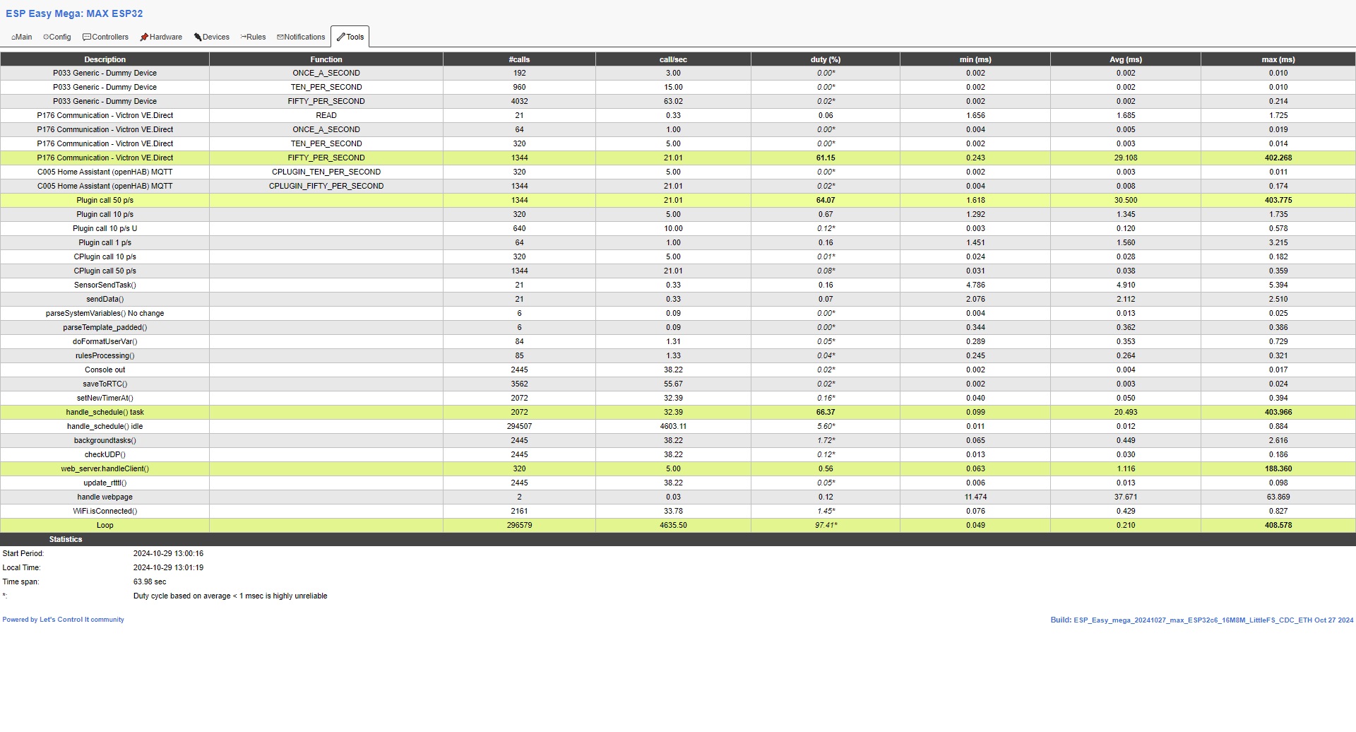

Can you take a look at the timing stats (you may need to enable it on tools->Advanced "Collect Timing Statistics" )
Then on the tools -> Timing stats you can see how long everything running on the ESPEasy node takes.
N.B. each time you refresh that page, it will clear the stats.
Let it run for a few minutes without opening any other page and then refresh the page to see how long everything takes.
It sounds a bit like there might be something else taking up too much time, so the node may miss a packet.
You can also try to increase the buffer size.
Just keep in mind that if there is another process at the ESPEasy node taking too long, a larger buffer will not magically fix this and depending on the real cause, it may even worsen things if there are more packets to be processed...
You may also want to disable any serial log, to see if this improves things.
What serial port do you use to collect the data?
And it is also possible that there still might be some issue in calculating the checksum. (as far as I know, Ton doesn't have a Victron device to test with so he wrote it all based on the datasheet)
#80 Post by Ath » 29 Oct 2024, 07:52
TD-er wrote: 29 Oct 2024, 01:02 You can also try to increase the buffer size.
That's a suggestion I also had in mind, increasing the buffer to 256 fixed an earlier bug in my code that had the order of receiving wrong, but once fixed, the 128 byte buffer is large enough so far.
On heavy load/busy other tasks it might not be enough though.
TD-er wrote: 29 Oct 2024, 01:02 And it is also possible that there still might be some issue in calculating the checksum. (as far as I know, Ton doesn't have a Victron device to test with so he wrote it all based on the datasheet)
Well, I'm a bit surprised that there are so many "Checksum h" lines in the log (the 'h' is the checksum value), and while that's possible (haven't scraped it yet for comparing multiple packets), it feels a bit 'unexpected'.
Another thing I noticed is the VPV value of 0.03 V, but that's probably because you're measuring while it's dark?

FWIW - Load on my ESP32-C6 16M device with P176 disabled was 9%. Load when enabled is around 70%
I disabled my rules (just in case ...) and set Rx buffer to 256. Timing stats enabled in Advanced
Im reading serial data on HW1 (GPIO2) with serial port logging disabled
Still same behaviour re checksum errors
1126289: P176 : Checksum state: 2

1126569: P176 : Checksum state: 2
1126588: P176 : Processing data 'H20 0', checksum: 223
1126588: P176 : Checksum state: 2
1126609: P176 : Processing data 'H21 0', checksum: 218
1126609: P176 : Checksum state: 2
1126628: P176 : Processing data 'H22 0', checksum: 214
1126628: P176 : Checksum state: 2
1126648: P176 : Processing data 'H23 0', checksum: 211
1126648: P176 : Checksum state: 2
1126668: P176 : Processing data 'HSDS 113', checksum: 186
1126668: P176 : Checksum state: 2
1126688: P176 : Validate next checksum
1126689: P176 : Processing data 'Checksum ', checksum: 0
1126689: P176 : Checksum state: 3
1126689: Victron: Checksum validated Ok
1126689: P176 : Moving 19 _temp items to _data
1126689: P176 : getReceivedValue Key:v, value:12700
1126690: P176 : getReceivedValue Key:i, value:0
1126690: P176 : getReceivedValue Key:p, value:
1126690: P176 : getReceivedValue Key:err, value:0
1127278: P176 : Checksum state: 1
1127278: P176 : Start counting for checksum
1127285: P176 : Processing data 'PID 0xA074', checksum: 129
1127285: P176 : Checksum state: 2
1127304: P176 : Processing data 'FW 164', checksum: 217
1127305: P176 : Checksum state: 2
1127325: P176 : Processing data 'SER# HQ234199DE7', checksum: 155
1127325: P176 : Checksum state: 2
1127344: P176 : Processing data 'V 12700', checksum: 11
1127345: P176 : Checksum state: 2
1127364: P176 : Processing data 'I 0', checksum: 164
1127364: P176 : Checksum state: 2
1127532: P176 : Processing data 'VPV 12650', checksum: 190
1127532: P176 : Checksum state: 2
1127552: P176 : Processing data 'PPV 0', checksum: 4
1127552: P176 : Checksum state: 2
1127571: P176 : Processing data 'CS 0', checksum: 234
1127571: P176 : Checksum state: 2
1127591: P176 : Processing data 'MPPT 0', checksum: 123
1127592: P176 : Checksum state: 2
1127612: P176 : Processing data 'OR 0x00000005', checksum: 105
1127612: P176 : Checksum state: 2
1127632: P176 : Processing data 'ERR 0', checksum: 162
1127632: P176 : Checksum state: 2
1127652: P176 : Processing data 'LOAD ON', checksum: 127
1127652: P176 : Checksum state: 2
1127671: P176 : Processing data 'IL 0', checksum: 100
1127671: P176 : Checksum state: 2
1127692: P176 : Processing data 'H19 404', checksum: 206
1127692: P176 : Checksum state: 2
1127712: P176 : Processing data 'H20 0', checksum: 200
1127712: P176 : Checksum state: 2
1127733: P176 : Processing data 'H21 0', checksum: 195
1127733: P176 : Checksum state: 2
1127751: P176 : Processing data 'H22 0', checksum: 191
1127751: P176 : Checksum state: 2
1127771: P176 : Processing data 'H23 0', checksum: 188
1127771: P176 : Checksum state: 2
1127792: P176 : Processing data 'HSDS 113', checksum: 163
1127792: P176 : Checksum state: 2
1127811: P176 : Validate next checksum
1127811: P176 : Processing data 'Checksum ', checksum: 233
1127812: P176 : Checksum state: 3
1127812: Victron: Checksum error, expected 0 but got 233
1127812: P176 : Moving 19 _temp items to _data
1127812: P176 : getReceivedValue Key:v, value:12700
1127813: P176 : getReceivedValue Key:i, value:0
1127813: P176 : getReceivedValue Key:p, value:
1127813: P176 : getReceivedValue Key:err, value:0
1128278: P176 : Checksum state: 5
1128422: P176 : Processing data 'PID 0xA074', checksum: 129
1128422: P176 : Checksum state: 5
1128442: P176 : Processing data 'FW 164', checksum: 217
1128442: P176 : Checksum state: 5
1128462: P176 : Processing data 'SER# HQ234199DE7', checksum: 155
1128462: P176 : Checksum state: 5
1128481: P176 : Processing data 'V 12700', checksum: 11
1128482: P176 : Checksum state: 5
1128501: P176 : Processing data 'I 0', checksum: 164
1128502: P176 : Checksum state: 5
1128522: P176 : Processing data 'VPV 12650', checksum: 190
1128522: P176 : Checksum state: 5
1128541: P176 : Processing data 'PPV 0', checksum: 4
1128541: P176 : Checksum state: 5
1128561: P176 : Processing data 'CS 0', checksum: 234
1128561: P176 : Checksum state: 5
1128581: P176 : Processing data 'MPPT 0', checksum: 123
1128582: P176 : Checksum state: 5
1128602: P176 : Processing data 'OR 0x00000005', checksum: 105
1128602: P176 : Checksum state: 5
1128622: P176 : Processing data 'ERR 0', checksum: 162
1128622: P176 : Checksum state: 5
1128641: P176 : Processing data 'LOAD ON', checksum: 127
1128642: P176 : Checksum state: 5
1128661: P176 : Processing data 'IL 0', checksum: 100
1128661: P176 : Checksum state: 5
1128682: P176 : Processing data 'H19 404', checksum: 206
1128682: P176 : Checksum state: 5
1128701: P176 : Processing data 'H20 0', checksum: 200
1128702: P176 : Checksum state: 5
1128723: P176 : Processing data 'H21 0', checksum: 195
1128723: P176 : Checksum state: 5
1128741: P176 : Processing data 'H22 0', checksum: 191
1128742: P176 : Checksum state: 5
1128761: P176 : Processing data 'H23 0', checksum: 188
1128761: P176 : Checksum state: 5
1128781: P176 : Processing data 'HSDS 113', checksum: 163
1128782: P176 : Checksum state: 5
1128802: P176 : Processing data 'Checksum ', checksum: 233
1128802: P176 : Checksum state: 1
1128802: P176 : Start counting for checksum
1129278: P176 : Checksum state: 2
1129419: P176 : Processing data 'PID 0xA074', checksum: 152
1129419: P176 : Checksum state: 2
1129439: P176 : Processing data 'FW 164', checksum: 240
1129439: P176 : Checksum state: 2
1129459: P176 : Processing data 'SER# HQ234199DE7', checksum: 178
1129459: P176 : Checksum state: 2
1129479: P176 : Processing data 'V 12700', checksum: 34
1129479: P176 : Checksum state: 2
1129499: P176 : Processing data 'I 0', checksum: 187
1129499: P176 : Checksum state: 2
1129519: P176 : Processing data 'VPV 12650', checksum: 213
1129519: P176 : Checksum state: 2
1129538: P176 : Processing data 'PPV 0', checksum: 27
1129538: P176 : Checksum state: 2
1129559: P176 : Processing data 'CS 0', checksum: 1
1129559: P176 : Checksum state: 2
1129578: P176 : Processing data 'MPPT 0', checksum: 146
1129578: P176 : Checksum state: 2
1129599: P176 : Processing data 'OR 0x00000005', checksum: 128
1129599: P176 : Checksum state: 2
1129620: P176 : Processing data 'ERR 0', checksum: 185
1129620: P176 : Checksum state: 2
1129639: P176 : Processing data 'LOAD ON', checksum: 150
1129639: P176 : Checksum state: 2
1129658: P176 : Processing data 'IL 0', checksum: 123
1129658: P176 : Checksum state: 2
1129678: P176 : Processing data 'H19 404', checksum: 229
1129679: P176 : Checksum state: 2
1129698: P176 : Processing data 'H20 0', checksum: 223
1129698: P176 : Checksum state: 2
1129718: P176 : Processing data 'H21 0', checksum: 218
1129718: P176 : Checksum state: 2
1129739: P176 : Processing data 'H22 0', checksum: 214
1129739: P176 : Checksum state: 2
1129758: P176 : Processing data 'H23 0', checksum: 211
1129758: P176 : Checksum state: 2
1129778: P176 : Processing data 'HSDS 113', checksum: 186
1129778: P176 : Checksum state: 2
1129798: P176 : Validate next checksum
1129798: P176 : Processing data 'Checksum ', checksum: 0
1129799: P176 : Checksum state: 3
1129799: Victron: Checksum validated Ok
1129799: P176 : Moving 19 _temp items to _data
1129799: P176 : getReceivedValue Key:v, value:12700
1129800: P176 : getReceivedValue Key:i, value:0
1129800: P176 : getReceivedValue Key:p, value:
1129800: P176 : getReceivedValue Key:err, value:0
1130278: P176 : Checksum state: 1
1130278: P176 : Start counting for checksum
1130432: P176 : Processing data 'PID 0xA074', checksum: 129
1130432: P176 : Checksum state: 2
1130450: EVENT: Clock#Time=Tue,9:52
1130455: P176 : Processing data 'FW 164', checksum: 217
1130455: P176 : Checksum state: 2
1130472: P176 : Processing data 'SER# HQ234199DE7', checksum: 155
1130472: P176 : Checksum state: 2
1130491: P176 : Processing data 'V 12700', checksum: 11
1130491: P176 : Checksum state: 2
1130512: P176 : Processing data 'I 0', checksum: 164
1130512: P176 : Checksum state: 2
1130532: P176 : Processing data 'VPV 12650', checksum: 190
1130532: P176 : Checksum state: 2
1130551: P176 : Processing data 'PPV 0', checksum: 4
1130551: P176 : Checksum state: 2
1130571: P176 : Processing data 'CS 0', checksum: 234
1130571: P176 : Checksum state: 2
1130591: P176 : Processing data 'MPPT 0', checksum: 123
1130591: P176 : Checksum state: 2
1130612: P176 : Processing data 'OR 0x00000005', checksum: 105
1130612: P176 : Checksum state: 2
1130632: P176 : Processing data 'ERR 0', checksum: 162
1130632: P176 : Checksum state: 2
1130651: P176 : Processing data 'LOAD ON', checksum: 127
1130652: P176 : Checksum state: 2
1130671: P176 : Processing data 'IL 0', checksum: 100
1130671: P176 : Checksum state: 2
1130691: P176 : Processing data 'H19 404', checksum: 206
1130691: P176 : Checksum state: 2
1130711: P176 : Processing data 'H20 0', checksum: 200
1130711: P176 : Checksum state: 2
1130733: P176 : Processing data 'H21 0', checksum: 195
1130733: P176 : Checksum state: 2
1130751: P176 : Processing data 'H22 0', checksum: 191
1130751: P176 : Checksum state: 2
1130771: P176 : Processing data 'H23 0', checksum: 188
1130771: P176 : Checksum state: 2
1130791: P176 : Processing data 'HSDS 113', checksum: 163
1130792: P176 : Checksum state: 2
1130811: P176 : Validate next checksum
1130811: P176 : Processing data 'Checksum ', checksum: 233
1130811: P176 : Checksum state: 3
1130812: Victron: Checksum error, expected 0 but got 233
1130812: P176 : Moving 19 _temp items to _data
1130812: P176 : getReceivedValue Key:v, value:12700
1130813: P176 : getReceivedValue Key:i, value:0
1130813: P176 : getReceivedValue Key:p, value:
1130813: P176 : getReceivedValue Key:err, value:0
1131278: P176 : Checksum state: 5
1131428: P176 : Processing data 'PID 0xA074', checksum: 129
1131428: P176 : Checksum state: 5
1131447: P176 : Processing data 'FW 164', checksum: 217
1131447: P176 : Checksum state: 5
1131467: P176 : Processing data 'SER# HQ234199DE7', checksum: 155
1131467: P176 : Checksum state: 5
1131486: P176 : Processing data 'V 12700', checksum: 11
1131487: P176 : Checksum state: 5
1131507: P176 : Processing data 'I 0', checksum: 164
1131507: P176 : Checksum state: 5
1131528: P176 : Processing data 'VPV 12650', checksum: 190
1131528: P176 : Checksum state: 5
1131546: P176 : Processing data 'PPV 0', checksum: 4
1131546: P176 : Checksum state: 5
1131566: P176 : Processing data 'CS 0', checksum: 234
1131566: P176 : Checksum state: 5
1131586: P176 : Processing data 'MPPT 0', checksum: 123
1131587: P176 : Checksum state: 5
1131607: P176 : Processing data 'OR 0x00000005', checksum: 105
1131607: P176 : Checksum state: 5
1131626: P176 : Processing data 'ERR 0', checksum: 162
1131626: P176 : Checksum state: 5
1131647: P176 : Processing data 'LOAD ON', checksum: 127
1131647: P176 : Checksum state: 5
1131666: P176 : Processing data 'IL 0', checksum: 100
1131666: P176 : Checksum state: 5
1131687: P176 : Processing data 'H19 404', checksum: 206
1131687: P176 : Checksum state: 5
1131706: P176 : Processing data 'H20 0', checksum: 200
1131706: P176 : Checksum state: 5
1131726: P176 : Processing data 'H21 0', checksum: 195
1131726: P176 : Checksum state: 5
1131747: P176 : Processing data 'H22 0', checksum: 191
1131747: P176 : Checksum state: 5
1131766: P176 : Processing data 'H23 0', checksum: 188
1131766: P176 : Checksum state: 5
1131786: P176 : Processing data 'HSDS 113', checksum: 163
1131787: P176 : Checksum state: 5
1131806: P176 : Processing data 'Checksum ', checksum: 233
1131806: P176 : Checksum state: 1
1131807: P176 : Start counting for checksum
1132279: P176 : Checksum state: 2
1132439: P176 : Processing data 'PID 0xA074', checksum: 152
1132439: P176 : Checksum state: 2
1132459: P176 : Processing data 'FW 164', checksum: 240
1132459: P176 : Checksum state: 2
1132479: P176 : Processing data 'SER# HQ234199DE7', checksum: 178
1132479: P176 : Checksum state: 2
1132499: P176 : Processing data 'V 12700', checksum: 34
1132499: P176 : Checksum state: 2
1132518: P176 : Processing data 'I 0', checksum: 187
1132518: P176 : Checksum state: 2
1132539: P176 : Processing data 'VPV 12650', checksum: 213
1132539: P176 : Checksum state: 2
1132559: P176 : Processing data 'PPV 0', checksum: 27
1132559: P176 : Checksum state: 2
1132578: P176 : Processing data 'CS 0', checksum: 1
1132578: P176 : Checksum state: 2
1132598: P176 : Processing data 'MPPT 0', checksum: 146
1132599: P176 : Checksum state: 2
1132619: P176 : Processing data 'OR 0x00000005', checksum: 128
1132619: P176 : Checksum state: 2
1132639: P176 : Processing data 'ERR 0', checksum: 185
1132639: P176 : Checksum state: 2
1132658: P176 : Processing data 'LOAD ON', checksum: 150
1132658: P176 : Checksum state: 2
1132678: P176 : Processing data 'IL 0', checksum: 123
1132678: P176 : Checksum state: 2
1132699: P176 : Processing data 'H19 404', checksum: 229

Timing stats
Oh, re VPV = 0.3V - yes no sunlight here at 11pm :D
P176 timing page 1.jpg (445.32 KiB) Viewed 13356 times
#83 Post by TD-er » 29 Oct 2024, 12:11
Can you also test with all logging disabled?
I know you can't see the checksum errors then, but there should be a counter on the task page so you can let it run for like a minute and then refresh that page to see what 'statistics' it shows regarding reading lines and checksum errors.
I just discussed it with Ton as the 50/sec call of that task is taking > 20 msec on average, so no wonder the ESP load will be high.
We will look into this later today to see what can be fine tuned.

All logging disabled
Load 67%
Timing stats in attachment

P176 current data page .jpg (135.72 KiB) Viewed 13337 times
P176 timing page No Logging.jpg (390.4 KiB) Viewed 13338 times
#85 Post by Ath » 29 Oct 2024, 15:11
Hmm, haven't seen that 400 msec duration of the 50/sec call here :shock: , it's usually between 5..30 msec
Is it possible you have some ground-loop in your wiring, causing a lot of noise on the serial line? To exclude/resolve that you could power the ESP from a power-bank instead of a computer or mains-power supply.

#86 Post by Affinite » 29 Oct 2024, 15:44
Ath wrote: 29 Oct 2024, 15:11 Hmm, haven't seen that 400 msec duration of the 50/sec call here :shock: , it's usually between 5..30 msec
Serial in is going through a level shifter. I'll try a simpler voltage divider and also power the ESP off a power bank as you suggest and report back
Affinite
Posts: 152
Joined: 03 Apr 2018, 18:46
Location: United Kingdom
#87 Post by Affinite » 29 Oct 2024, 21:19
OK I tried these steps in sequence:
1) powered the ESP from a DC power bank
2) Removed the physical serial data i/p (so no physical connections to the ESP except the USB power cable)
3) changed serial i/p in plugin to H/W 0 (with serial logging disabled)
With P176 enabled the ESP hit 100% load ! (see attached timing page dump)
With P176 disabled load settled back at 12%
As a second test I reconnected the Victron MPPT serial output to the ESP and installed P094 (CUL reader)
Disabled P176
I could see serial data coming in on the event log and CPU load was 22%
Conclusion - my ESP32 C6-16M doesn't like P176 :cry:
Very strange behaviour - I might get the chance to test the plugin on my other ESP32 (currently working fine with P094) and Victron Shunt but not until next week
P176 timing page 1.jpg (389.22 KiB) Viewed 13286 times

Hm strange that it's not working as intended for you on an ESP32-C6 16M, as that's the exact unit I've done nearly all my testing on... :? Maybe it's to do with the GPIO pins used for RX/TX? I've configured HW Serial 1 with GPIO-1 for RX and GPIO-0 for TX (ESP-side, the other way around may block the ESP from booting, depending on the external TX signal).
With the suggestions TD-er had I've optimized the code quite a bit, with the debug logging from the configuration turned off, the load is now very reasonable, with everything turned off (including the sending signal!) I have a base-load. When my sender is turned on, and P176 is still disabled, ca. 5% load is added, and enabling P176 another ca. 1% load is added. Timings for P176 50/sec is ca. 0.3 msec avg and ca. 7.1 msec max (even on first opening of the stats page).
When debug logging is enabled, the max stats rises to ca. 50 msec, so that should really be turned off for production use.

Victron to ESP using Victron (P176) plugin
#94 Post by Affinite » 30 Oct 2024, 12:38
Ath,
I think you've (nearly) cracked it ...
Loaded new version of the plugin and it runs with load around 25-30% and much healthier timing screen.
The number of checksum errors has not changed though (Around 1 checksum error per packet received)
I don't know if that's a problem or if I should just tick "Ignore data on checksum error:" and not worry about it - it certainly isn't an issue for me - the plugin seems to be working just fine for my application.
Thanks again for your (and TD-er's) help.

330903: EVENT: Victron_MPPT#P=0.00
330908: ACT  : TaskValueSet,Battery_Voltage,Volts,12.66
330912: taskValueSet: TaskValueSet,Battery_Voltage,Volts,12.66  taskindex: 1 varNr: 0 result: 12.660000 type: 1
330915: ACT  : TaskValueSet,Panel_Voltage,Volts,12.590
330918: taskValueSet: TaskValueSet,Panel_Voltage,Volts,12.590  taskindex: 2 varNr: 0 result: 12.590000 type: 1
330921: ACT  : TaskValueSet,Yesterdays_Power,Watts,0
330924: taskValueSet: TaskValueSet,Yesterdays_Power,Watts,0  taskindex: 3 varNr: 0 result: 0.000000 type: 1
330927: ACT  : TaskValueSet,Day_Sequence,Dummy,113
330930: taskValueSet: TaskValueSet,Day_Sequence,Dummy,113  taskindex: 4 varNr: 0 result: 113.000000 type: 1
330935: EVENT: Victron_MPPT#ERR=0.00
330940: ACT  : TaskValueSet,Battery_Voltage,Volts,12.66
330943: taskValueSet: TaskValueSet,Battery_Voltage,Volts,12.66  taskindex: 1 varNr: 0 result: 12.660000 type: 1
330946: ACT  : TaskValueSet,Panel_Voltage,Volts,12.590
330949: taskValueSet: TaskValueSet,Panel_Voltage,Volts,12.590  taskindex: 2 varNr: 0 result: 12.590000 type: 1
330952: ACT  : TaskValueSet,Yesterdays_Power,Watts,0
330955: taskValueSet: TaskValueSet,Yesterdays_Power,Watts,0  taskindex: 3 varNr: 0 result: 0.000000 type: 1
330958: ACT  : TaskValueSet,Day_Sequence,Dummy,113
330961: taskValueSet: TaskValueSet,Day_Sequence,Dummy,113  taskindex: 4 varNr: 0 result: 113.000000 type: 1
331837: EVENT: Victron_MPPT#V=12.66
331842: ACT  : TaskValueSet,Battery_Voltage,Volts,12.66
331846: taskValueSet: TaskValueSet,Battery_Voltage,Volts,12.66  taskindex: 1 varNr: 0 result: 12.660000 type: 1
331849: ACT  : TaskValueSet,Panel_Voltage,Volts,12.590
331852: taskValueSet: TaskValueSet,Panel_Voltage,Volts,12.590  taskindex: 2 varNr: 0 result: 12.590000 type: 1
331855: ACT  : TaskValueSet,Yesterdays_Power,Watts,0
331858: taskValueSet: TaskValueSet,Yesterdays_Power,Watts,0  taskindex: 3 varNr: 0 result: 0.000000 type: 1
331861: ACT  : TaskValueSet,Day_Sequence,Dummy,113
331864: taskValueSet: TaskValueSet,Day_Sequence,Dummy,113  taskindex: 4 varNr: 0 result: 113.000000 type: 1
331869: EVENT: Victron_MPPT#I=0.00
331874: ACT  : TaskValueSet,Battery_Voltage,Volts,12.66
331877: taskValueSet: TaskValueSet,Battery_Voltage,Volts,12.66  taskindex: 1 varNr: 0 result: 12.660000 type: 1
331880: ACT  : TaskValueSet,Panel_Voltage,Volts,12.590
331883: taskValueSet: TaskValueSet,Panel_Voltage,Volts,12.590  taskindex: 2 varNr: 0 result: 12.590000 type: 1
331886: ACT  : TaskValueSet,Yesterdays_Power,Watts,0
331889: taskValueSet: TaskValueSet,Yesterdays_Power,Watts,0  taskindex: 3 varNr: 0 result: 0.000000 type: 1
331892: ACT  : TaskValueSet,Day_Sequence,Dummy,113
331896: taskValueSet: TaskValueSet,Day_Sequence,Dummy,113  taskindex: 4 varNr: 0 result: 113.000000 type: 1
331904: EVENT: Victron_MPPT#P=0.00
331909: ACT  : TaskValueSet,Battery_Voltage,Volts,12.66
331912: taskValueSet: TaskValueSet,Battery_Voltage,Volts,12.66  taskindex: 1 varNr: 0 result: 12.660000 type: 1
331915: ACT  : TaskValueSet,Panel_Voltage,Volts,12.590
331919: taskValueSet: TaskValueSet,Panel_Voltage,Volts,12.590  taskindex: 2 varNr: 0 result: 12.590000 type: 1
331922: ACT  : TaskValueSet,Yesterdays_Power,Watts,0
331925: taskValueSet: TaskValueSet,Yesterdays_Power,Watts,0  taskindex: 3 varNr: 0 result: 0.000000 type: 1
331928: ACT  : TaskValueSet,Day_Sequence,Dummy,113
331931: taskValueSet: TaskValueSet,Day_Sequence,Dummy,113  taskindex: 4 varNr: 0 result: 113.000000 type: 1
331936: EVENT: Victron_MPPT#ERR=0.00
331941: ACT  : TaskValueSet,Battery_Voltage,Volts,12.66
331945: taskValueSet: TaskValueSet,Battery_Voltage,Volts,12.66  taskindex: 1 varNr: 0 result: 12.660000 type: 1
331948: ACT  : TaskValueSet,Panel_Voltage,Volts,12.590
331951: taskValueSet: TaskValueSet,Panel_Voltage,Volts,12.590  taskindex: 2 varNr: 0 result: 12.590000 type: 1
331954: ACT  : TaskValueSet,Yesterdays_Power,Watts,0
331957: taskValueSet: TaskValueSet,Yesterdays_Power,Watts,0  taskindex: 3 varNr: 0 result: 0.000000 type: 1
331960: ACT  : TaskValueSet,Day_Sequence,Dummy,113
331963: taskValueSet: TaskValueSet,Day_Sequence,Dummy,113  taskindex: 4 varNr: 0 result: 113.000000 type: 1
332149: Victron: Checksum validated Ok
332836: EVENT: Victron_MPPT#V=12.66
332841: ACT  : TaskValueSet,Battery_Voltage,Volts,12.66
332845: taskValueSet: TaskValueSet,Battery_Voltage,Volts,12.66  taskindex: 1 varNr: 0 result: 12.660000 type: 1
332848: ACT  : TaskValueSet,Panel_Voltage,Volts,12.590
332851: taskValueSet: TaskValueSet,Panel_Voltage,Volts,12.590  taskindex: 2 varNr: 0 result: 12.590000 type: 1
332854: ACT  : TaskValueSet,Yesterdays_Power,Watts,0
332858: taskValueSet: TaskValueSet,Yesterdays_Power,Watts,0  taskindex: 3 varNr: 0 result: 0.000000 type: 1
332861: ACT  : TaskValueSet,Day_Sequence,Dummy,113
332865: taskValueSet: TaskValueSet,Day_Sequence,Dummy,113  taskindex: 4 varNr: 0 result: 113.000000 type: 1
332869: EVENT: Victron_MPPT#I=0.00
332874: ACT  : TaskValueSet,Battery_Voltage,Volts,12.66
332878: taskValueSet: TaskValueSet,Battery_Voltage,Volts,12.66  taskindex: 1 varNr: 0 result: 12.660000 type: 1
332881: ACT  : TaskValueSet,Panel_Voltage,Volts,12.590
332884: taskValueSet: TaskValueSet,Panel_Voltage,Volts,12.590  taskindex: 2 varNr: 0 result: 12.590000 type: 1
332887: ACT  : TaskValueSet,Yesterdays_Power,Watts,0
332890: taskValueSet: TaskValueSet,Yesterdays_Power,Watts,0  taskindex: 3 varNr: 0 result: 0.000000 type: 1
332893: ACT  : TaskValueSet,Day_Sequence,Dummy,113
332896: taskValueSet: TaskValueSet,Day_Sequence,Dummy,113  taskindex: 4 varNr: 0 result: 113.000000 type: 1
332904: EVENT: Victron_MPPT#P=0.00
332909: ACT  : TaskValueSet,Battery_Voltage,Volts,12.66
332912: taskValueSet: TaskValueSet,Battery_Voltage,Volts,12.66  taskindex: 1 varNr: 0 result: 12.660000 type: 1
332915: ACT  : TaskValueSet,Panel_Voltage,Volts,12.590
332919: taskValueSet: TaskValueSet,Panel_Voltage,Volts,12.590  taskindex: 2 varNr: 0 result: 12.590000 type: 1
332921: ACT  : TaskValueSet,Yesterdays_Power,Watts,0
332925: taskValueSet: TaskValueSet,Yesterdays_Power,Watts,0  taskindex: 3 varNr: 0 result: 0.000000 type: 1
332927: ACT  : TaskValueSet,Day_Sequence,Dummy,113
332931: taskValueSet: TaskValueSet,Day_Sequence,Dummy,113  taskindex: 4 varNr: 0 result: 113.000000 type: 1
332935: EVENT: Victron_MPPT#ERR=0.00
332940: ACT  : TaskValueSet,Battery_Voltage,Volts,12.66
332945: taskValueSet: TaskValueSet,Battery_Voltage,Volts,12.66  taskindex: 1 varNr: 0 result: 12.660000 type: 1
332948: ACT  : TaskValueSet,Panel_Voltage,Volts,12.590
332951: taskValueSet: TaskValueSet,Panel_Voltage,Volts,12.590  taskindex: 2 varNr: 0 result: 12.590000 type: 1
332954: ACT  : TaskValueSet,Yesterdays_Power,Watts,0
332957: taskValueSet: TaskValueSet,Yesterdays_Power,Watts,0  taskindex: 3 varNr: 0 result: 0.000000 type: 1
332960: ACT  : TaskValueSet,Day_Sequence,Dummy,113
332963: taskValueSet: TaskValueSet,Day_Sequence,Dummy,113  taskindex: 4 varNr: 0 result: 113.000000 type: 1
333145: Victron: Checksum error, expected 0 but got 127
333839: EVENT: Victron_MPPT#V=12.66
333844: ACT  : TaskValueSet,Battery_Voltage,Volts,12.66
333848: taskValueSet: TaskValueSet,Battery_Voltage,Volts,12.66  taskindex: 1 varNr: 0 result: 12.660000 type: 1
333851: ACT  : TaskValueSet,Panel_Voltage,Volts,12.590
333854: taskValueSet: TaskValueSet,Panel_Voltage,Volts,12.590  taskindex: 2 varNr: 0 result: 12.590000 type: 1
333857: ACT  : TaskValueSet,Yesterdays_Power,Watts,0
333860: taskValueSet: TaskValueSet,Yesterdays_Power,Watts,0  taskindex: 3 varNr: 0 result: 0.000000 type: 1
333863: ACT  : TaskValueSet,Day_Sequence,Dummy,113
333867: taskValueSet: TaskValueSet,Day_Sequence,Dummy,113  taskindex: 4 varNr: 0 result: 113.000000 type: 1
333872: EVENT: Victron_MPPT#I=0.00
333877: ACT  : TaskValueSet,Battery_Voltage,Volts,12.66
333880: taskValueSet: TaskValueSet,Battery_Voltage,Volts,12.66  taskindex: 1 varNr: 0 result: 12.660000 type: 1
333883: ACT  : TaskValueSet,Panel_Voltage,Volts,12.590
333886: taskValueSet: TaskValueSet,Panel_Voltage,Volts,12.590  taskindex: 2 varNr: 0 result: 12.590000 type: 1
333889: ACT  : TaskValueSet,Yesterdays_Power,Watts,0
333892: taskValueSet: TaskValueSet,Yesterdays_Power,Watts,0  taskindex: 3 varNr: 0 result: 0.000000 type: 1
333895: ACT  : TaskValueSet,Day_Sequence,Dummy,113
333898: taskValueSet: TaskValueSet,Day_Sequence,Dummy,113  taskindex: 4 varNr: 0 result: 113.000000 type: 1
333906: EVENT: Victron_MPPT#P=0.00
333911: ACT  : TaskValueSet,Battery_Voltage,Volts,12.66
333914: taskValueSet: TaskValueSet,Battery_Voltage,Volts,12.66  taskindex: 1 varNr: 0 result: 12.660000 type: 1
333917: ACT  : TaskValueSet,Panel_Voltage,Volts,12.590
333921: taskValueSet: TaskValueSet,Panel_Voltage,Volts,12.590  taskindex: 2 varNr: 0 result: 12.590000 type: 1
333923: ACT  : TaskValueSet,Yesterdays_Power,Watts,0
333927: taskValueSet: TaskValueSet,Yesterdays_Power,Watts,0  taskindex: 3 varNr: 0 result: 0.000000 type: 1
333929: ACT  : TaskValueSet,Day_Sequence,Dummy,113
333933: taskValueSet: TaskValueSet,Day_Sequence,Dummy,113  taskindex: 4 varNr: 0 result: 113.000000 type: 1
333937: EVENT: Victron_MPPT#ERR=0.00
333942: ACT  : TaskValueSet,Battery_Voltage,Volts,12.66
333946: taskValueSet: TaskValueSet,Battery_Voltage,Volts,12.66  taskindex: 1 varNr: 0 result: 12.660000 type: 1
333949: ACT  : TaskValueSet,Panel_Voltage,Volts,12.590
333952: taskValueSet: TaskValueSet,Panel_Voltage,Volts,12.590  taskindex: 2 varNr: 0 result: 12.590000 type: 1
333955: ACT  : TaskValueSet,Yesterdays_Power,Watts,0
333958: taskValueSet: TaskValueSet,Yesterdays_Power,Watts,0  taskindex: 3 varNr: 0 result: 0.000000 type: 1
333961: ACT  : TaskValueSet,Day_Sequence,Dummy,113
333964: taskValueSet: TaskValueSet,Day_Sequence,Dummy,113  taskindex: 4 varNr: 0 result: 113.000000 type: 1
334838: EVENT: Victron_MPPT#V=12.66
334843: ACT  : TaskValueSet,Battery_Voltage,Volts,12.66
334847: taskValueSet: TaskValueSet,Battery_Voltage,Volts,12.66  taskindex: 1 varNr: 0 result: 12.660000 type: 1
334849: ACT  : TaskValueSet,Panel_Voltage,Volts,12.590
334853: taskValueSet: TaskValueSet,Panel_Voltage,Volts,12.590  taskindex: 2 varNr: 0 result: 12.590000 type: 1
334856: ACT  : TaskValueSet,Yesterdays_Power,Watts,0
334860: taskValueSet: TaskValueSet,Yesterdays_Power,Watts,0  taskindex: 3 varNr: 0 result: 0.000000 type: 1
334863: ACT  : TaskValueSet,Day_Sequence,Dummy,113
334866: taskValueSet: TaskValueSet,Day_Sequence,Dummy,113  taskindex: 4 varNr: 0 result: 113.000000 type: 1
334871: EVENT: Victron_MPPT#I=0.00
334876: ACT  : TaskValueSet,Battery_Voltage,Volts,12.66
334880: taskValueSet: TaskValueSet,Battery_Voltage,Volts,12.66  taskindex: 1 varNr: 0 result: 12.660000 type: 1
334882: ACT  : TaskValueSet,Panel_Voltage,Volts,12.590
334886: taskValueSet: TaskValueSet,Panel_Voltage,Volts,12.590  taskindex: 2 varNr: 0 result: 12.590000 type: 1
334889: ACT  : TaskValueSet,Yesterdays_Power,Watts,0
334893: taskValueSet: TaskValueSet,Yesterdays_Power,Watts,0  taskindex: 3 varNr: 0 result: 0.000000 type: 1
334895: ACT  : TaskValueSet,Day_Sequence,Dummy,113
334899: taskValueSet: TaskValueSet,Day_Sequence,Dummy,113  taskindex: 4 varNr: 0 result: 113.000000 type: 1
335050: EVENT: Victron_MPPT#P=0.00
335055: ACT  : TaskValueSet,Battery_Voltage,Volts,12.66
335060: taskValueSet: TaskValueSet,Battery_Voltage,Volts,12.66  taskindex: 1 varNr: 0 result: 12.660000 type: 1
335063: ACT  : TaskValueSet,Panel_Voltage,Volts,12.590
335067: taskValueSet: TaskValueSet,Panel_Voltage,Volts,12.590  taskindex: 2 varNr: 0 result: 12.590000 type: 1
335069: ACT  : TaskValueSet,Yesterdays_Power,Watts,0
335073: taskValueSet: TaskValueSet,Yesterdays_Power,Watts,0  taskindex: 3 varNr: 0 result: 0.000000 type: 1
335075: ACT  : TaskValueSet,Day_Sequence,Dummy,113
335079: taskValueSet: TaskValueSet,Day_Sequence,Dummy,113  taskindex: 4 varNr: 0 result: 113.000000 type: 1
335085: EVENT: Victron_MPPT#ERR=0.00
335090: ACT  : TaskValueSet,Battery_Voltage,Volts,12.66
335094: taskValueSet: TaskValueSet,Battery_Voltage,Volts,12.66  taskindex: 1 varNr: 0 result: 12.660000 type: 1
335097: ACT  : TaskValueSet,Panel_Voltage,Volts,12.590
335100: taskValueSet: TaskValueSet,Panel_Voltage,Volts,12.590  taskindex: 2 varNr: 0 result: 12.590000 type: 1
335103: ACT  : TaskValueSet,Yesterdays_Power,Watts,0
335106: taskValueSet: TaskValueSet,Yesterdays_Power,Watts,0  taskindex: 3 varNr: 0 result: 0.000000 type: 1
335109: ACT  : TaskValueSet,Day_Sequence,Dummy,113
335113: taskValueSet: TaskValueSet,Day_Sequence,Dummy,113  taskindex: 4 varNr: 0 result: 113.000000 type: 1
335149: Victron: Checksum validated Ok
335192: WD   : Uptime 6  ConnectFailures 0 FreeMem 299572 WiFiStatus: WL_CONNECTED 3 ESPeasy internal wifi status: Conn. IP Init
335852: EVENT: Victron_MPPT#V=12.66
335857: ACT  : TaskValueSet,Battery_Voltage,Volts,12.66
335861: taskValueSet: TaskValueSet,Battery_Voltage,Volts,12.66  taskindex: 1 varNr: 0 result: 12.660000 type: 1
335864: ACT  : TaskValueSet,Panel_Voltage,Volts,12.590
335867: taskValueSet: TaskValueSet,Panel_Voltage,Volts,12.590  taskindex: 2 varNr: 0 result: 12.590000 type: 1
335870: ACT  : TaskValueSet,Yesterdays_Power,Watts,0
335873: taskValueSet: TaskValueSet,Yesterdays_Power,Watts,0  taskindex: 3 varNr: 0 result: 0.000000 type: 1
335876: ACT  : TaskValueSet,Day_Sequence,Dummy,113
335879: taskValueSet: TaskValueSet,Day_Sequence,Dummy,113  taskindex: 4 varNr: 0 result: 113.000000 type: 1
335883: EVENT: Victron_MPPT#I=0.00
335888: ACT  : TaskValueSet,Battery_Voltage,Volts,12.66
335891: taskValueSet: TaskValueSet,Battery_Voltage,Volts,12.66  taskindex: 1 varNr: 0 result: 12.660000 type: 1
335894: ACT  : TaskValueSet,Panel_Voltage,Volts,12.590
335898: taskValueSet: TaskValueSet,Panel_Voltage,Volts,12.590  taskindex: 2 varNr: 0 result: 12.590000 type: 1
335901: ACT  : TaskValueSet,Yesterdays_Power,Watts,0
335905: taskValueSet: TaskValueSet,Yesterdays_Power,Watts,0  taskindex: 3 varNr: 0 result: 0.000000 type: 1
335907: ACT  : TaskValueSet,Day_Sequence,Dummy,113
335911: taskValueSet: TaskValueSet,Day_Sequence,Dummy,113  taskindex: 4 varNr: 0 result: 113.000000 type: 1
335918: EVENT: Victron_MPPT#P=0.00
335923: ACT  : TaskValueSet,Battery_Voltage,Volts,12.66
335927: taskValueSet: TaskValueSet,Battery_Voltage,Volts,12.66  taskindex: 1 varNr: 0 result: 12.660000 type: 1
335929: ACT  : TaskValueSet,Panel_Voltage,Volts,12.590
335933: taskValueSet: TaskValueSet,Panel_Voltage,Volts,12.590  taskindex: 2 varNr: 0 result: 12.590000 type: 1
335935: ACT  : TaskValueSet,Yesterdays_Power,Watts,0
335939: taskValueSet: TaskValueSet,Yesterdays_Power,Watts,0  taskindex: 3 varNr: 0 result: 0.000000 type: 1
335941: ACT  : TaskValueSet,Day_Sequence,Dummy,113
#95 Post by Ath » 30 Oct 2024, 13:00
Ah, great, ... almost :?
Can you get a regular set of data, directly from the Victron, using some terminal software, like Putty or something similar?
There should at least be a few blocks (starting/ending with 'Checksum' and including the bytes that follow up to the CR/LF that complete each line), 8 to 10 blocks would be ideal.
That could shed some light on the matter. (There's still a chance I didn't implement the checksum correctly :shock:)
And if you could share the hardware configuration part of that device configuration, so I can use the same settings for testing.

#97 Post by Ath » 30 Oct 2024, 15:15
Thanks,
Because of the limited number of data fields available in the MPPT, it all seems to fit in a single packet. That would explain why the checksum is the same for some time, as there likely isn't much change in the data sent.
I'll be able to test later today.
NB: The Current data table showing CSHSDS is actually a sign there is a checksum error, somewhere on the line, as those are supposed to be 2 separate values, CS and HSDS :o
Affinite
Posts: 152
#98 Post by Affinite » 30 Oct 2024, 16:16
Ath wrote: 30 Oct 2024, 15:15 Thanks,
Well spotted !
#99 Post by TD-er » 30 Oct 2024, 20:50
Maybe just try to set the buffer size to 2048 to see if the number of checksum errors decrease as they still could be related to a full buffer.
#100 Post by Ath » 30 Oct 2024, 20:59
I've tried your test-data, and used the same hardware configuration (GPIO-2 and a 256 byte buffer), and in my lab-environment ( :lol:) it all works nicely:
Screenshot - 30-10-2024 , 20_41_19.png (18.91 KiB) Viewed 12981 times
This is tested using the latest code changes I made earlier today.
Also tried using SW Serial, but as expected, that's not working nicely, many checksum errors.
