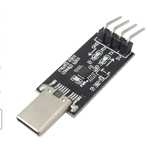

#8 Post by giorgino » 30 Oct 2024, 08:50
Sorry I've never used I2C converter
TD-er wrote: 29 Oct 2024, 23:42 Then having one of those I2C to serial converters is probably the best way to go.
do you mean something like this?
usb to serial.png (142.94 KiB) Viewed 5666 times
On my ESP32-S3 board there is 2 usb connector, one called USB and one UART
so one for the power and one fro the seriale (the third) because for the other two exist appropriate pins
Re: connecting many serial to ESP
#9 Post by Ath » 30 Oct 2024, 09:08
No, more like these: https://aliexpress.com/item/1005006765729550.html
You connect such board to your ESP via I2C, and get 2 serial ports in return (can be configured from most Serial communication plugins).
As TD-er said, the hardware-buffer in these chips is only 64 bytes, but for the Victron (and Nextion) devices that should be fine.
