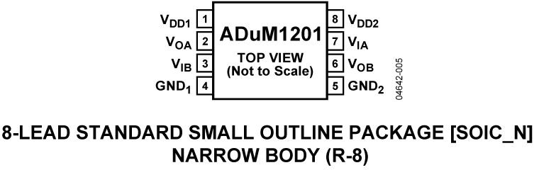

I buyed small and cheap ADUM1201 isolators and convertor
https://www.analog.com/en/products/adum ... rt-details
The ADuM1201 is a dual-channel, digital isolator with 1/1 channel directionality based on the Analog Devices, Inc., iCoupler® technology. Combining high speed CMOS and monolithic transformer technologies, these isolation components provide outstanding performance characteristics superior to alternatives, such as optocouplers.
Re: Victron to ESP using SerialProxy plugin
#157 Post by TD-er » 28 Nov 2024, 13:17
That's even better.
The reason I did not mention it specifically is because those are not always easy to find and/or sometimes way too expensive.
However I really do like these icoupler chips.
They are available in many configurations, like for SPI, I2C, UART, etc.
And you can get them for quite high speeds to.
They also clean up the signal if needed.
Just only one thing to keep in mind... these can be damaged by ESD, so when adding some connector to them, make sure the GND is connecting to the device first.

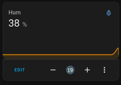

#168 Post by bonti69 » 05 Dec 2024, 18:30
According with the instructions https://www.home-assistant.io/integrati ... th-espeasy
I have managed to read in HA the sensor from ESPEasy device.
Have to manually create/edit the yaml configuration, then create a card in dashboard
mqtt:
  sensor:
    - name: "Humidity"
      unit_of_measurement: '%'
      device_class: humidity
      state_topic: "home/ESPname/HTU/Humidity"
    - name: "Temperature"
      unit_of_measurement: '°C'
      device_class: temperature
      state_topic: "home/ESPname/HTU/Temperature"
Screenshot 2024-12-05 at 19-23-02 Overview – Home Assistant.png (11.85 KiB) Viewed 10627 times

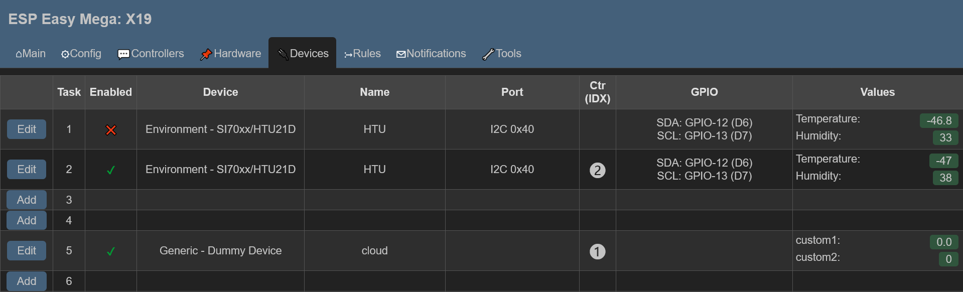

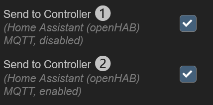

#169 Post by bonti69 » 05 Dec 2024, 18:49
I noticed that, if the device has two mqtt controllers defined, the device connects to both of them, but publish sensor data only to one. Meantime , accept commands from the disabled mqtt. Interesting... maybe some rule to enable /disable mqtt1 and mqtt2 alternatively , in order to send data to both controllers, for example to local broker every minute and to remote broker every 5 minutes.
Screenshot 2024-12-05 at 19-36-17 X19.png (63.31 KiB) Viewed 10618 times
Is there a command to enable/ disable the controllers, which can be used in rules?

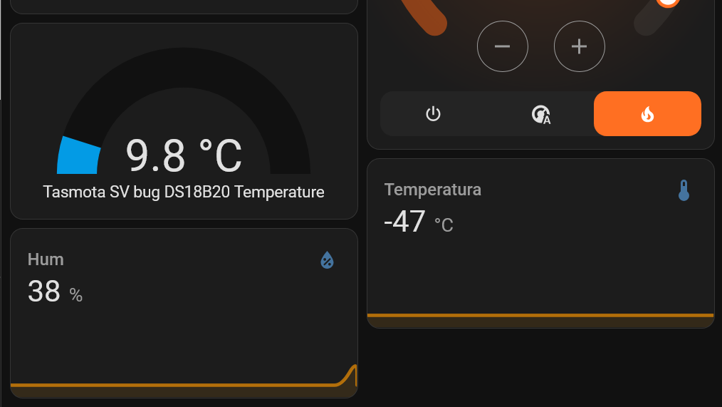

do you live in Siberia ?
-47 Degrees ?
bonti69
Posts: 176
Joined: 08 Apr 2021, 12:16
Location: Romania
#171 Post by bonti69 » 05 Dec 2024, 20:23
Affinite wrote: 05 Dec 2024, 20:14 @bonti69
-47 Degrees ?
senzor failure, temperature measurement is down, humidity works
or maybe plugin viewtopic.php?t=9312
ESPEasy bug, flashed an older firmware and works again...
Screenshot 2024-12-05 at 21-54-57 X19.png (79.23 KiB) Viewed 10593 times
#172 Post by Ath » 05 Dec 2024, 21:06
bonti69 wrote: 05 Dec 2024, 18:49 Is there a command to enable/ disable the controllers, which can be used in rules?
There are ControllerEnable and ControllerDisable commands, that take a numeric parameter 1..3 for the involved controller.
MQTT commands (from rules) are handled by the first enabled MQTT controller found.

Right again. Two mqtt controllers are not allowed simultaneously
Screenshot 2024-12-06 at 00-24-56 X19.png (65.36 KiB) Viewed 10534 times
