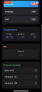

HTML Dashboard:
I want to create an HTML interface to monitor temperatures and relay states via my iPhone. I’ve tried the fetch.html tool but face stability issues. I also attempted my own code with ChatGPT's help, but I’m unable to fetch temperatures successfully.

I think you have to use the Custom webUI. Here you can upload your own HTML file

#3 Post by Neoseb38 » 11 Dec 2024, 19:24
Thank you for the information.
I quickly skimmed through it, but since I’m using a translator and I’m a beginner, it’s not very clear.
I see it mentions .css and not .html. What’s the difference?
I had already done something similar, but in .html. It works, but I don’t know how to handle the temperatures.
Thanks to chromo23, who helped me a lot with this code on my other post.

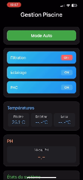

Re: Help Needed: Building an Autonomous Pool Management System with ESP32 Ethernet and ESP Easy

#9 Post by Neoseb38 » 14 Dec 2024, 17:09
Thanks !!!!
Great, I managed to get it working. I don’t understand why it wasn’t working before, but oh well.
As you know, I’m slowly starting with a code that includes a relay button and a temperature sensor. So far, this works... almost :D. The problem now is that I no longer have the status feedback. That means if my relay is on and I open my .html page, the relay shows as OFF.
I had three codes.
One with the relay and status feedback functional (occasionally getting a message saying "Unable to communicate with ESP-Easy" but it updated after a few seconds).
Another with just the temperature sensor, which also worked.

And a third with the mix of both, where everything is functional except for the status feedback.

My .html page is progressing well :D
Buttons for activating my relays.
Status feedback from my filtration pump (currently simulated using a light bulb) when the Filtration relay activates it.
Display of temperatures (only one available for now).
Potential evolution to display pH levels.
Display of Modes based on the activation of the switches on the control box.
I struggled quite a bit, but with your valuable information on using JSON and the help of AI, it’s turning out exactly the way I want.
Now I can start working on the rules!
Neoseb38
Posts: 122
Joined: 02 Dec 2024, 18:48
#11 Post by Neoseb38 » 24 Dec 2024, 13:36
ScreenRecording_12-21-2024 19-06-49_1.gif (787.46 KiB) Viewed 5720 times
ScreenRecording_12-21-2024 19-06-49_1 (1).gif (256.32 KiB) Viewed 5720 times
ScreenRecording_12-21-2024 19-06-49_1 (3).gif (939.33 KiB) Viewed 5720 times
