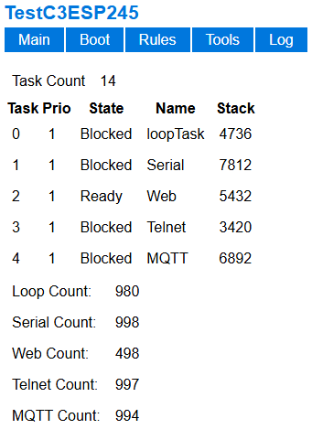

I think the plan to upgrade my entire environment (source code, platforms, modules) during the Christmas/new year holidays is going to be successful in the end
Today is the last day of my holiday and I've managed to fix the last showstopper, being MQTT on the C3 module. I've tried the pubsubclient from ESPEasy repo but that one also failed on me.
During testing and using serial.prints with a small delay I accidentally discovered that a "delay(1)" solved the connection issue.
So now I'm using pubsubclient 2.7 stock with only one modification in the connect code:
            while (!_client->available()) {
                unsigned long t = millis();
                if (t-lastInActivity >= ((int32_t) this->socketTimeout*1000UL)) {
                    _state = MQTT_CONNECTION_TIMEOUT;
                    _client->stop();
                    return false;
                delay(1); // This seems needed on ESP-C3 otherwise it will not connect !!!
It works, but IMHO it should not be needed because we have RTOS running on C3. I guess the fix somehow works because the delay also returns to the RTOS scheduler.
What's even more strange, when I started an MQTT connection manually from either web or telnet, it works with the default pubsubclient library without delay(1).
So for some strange reason, it works OOTB if any other client is connected at the same time.
Puzzled, but at least it's all working now on IDF 5.3.2 !
Re: SDK migration headaches
#21 Post by TD-er » 05 Jan 2025, 15:12
This doesn't sound too odd to me, as the C3 is a single core.
So what you're doing by calling delay() in Arduino is you let the Arduino SDK code check for WiFi events to be processed.
I always got the impression those C-versions were a bit more prone to connection issues and missing events.
In the WiFi code of ESPEasy, there are some delay() calls right after any call to something WiFi related just for this reason.
I suspect your code may be doing some DNS resolve at that point, which I know is still being a bit flaky at best.
martinus
Posts: 163
Joined: 15 Feb 2020, 16:57
#22 Post by martinus » 05 Jan 2025, 15:24
TD-er wrote: 05 Jan 2025, 15:12 This doesn't sound too odd to me, as the C3 is a single core.
Yes that somehow has to be related. But on preemptive RTOS, the scheduler should timeslice both Wifi task and loopTask, at least each millisecond. There should not be any reason to delay or yield to handover cpu time to the wifi task on RTOS.
Even more strange, this patch was not needed on IDF5.1. They must have changed something related in the most recent IDF to result into this issue.
