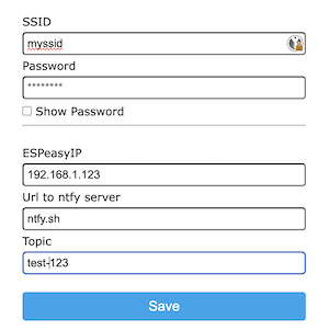

How to use:
1. Compile and upload Arduino sketch or flash binary file to an esp8266.
2. Connect to Access Point "easy2ntfy" (password: "configesp") and open 192.168.4.1 in a browser.
3. Enter your WiFi network credentials .
4. Enter ntfy-channel, ntfy-server, default-node-IP (other public ntfy server can be found here: https://docs.ntfy.sh/integrations/ - ntfy.adminforge.de is an exception and doesn't work with easy2ntfy!)
(the WiFiManager is always running. by entering the local ip you can always access and change the credentials and parameter)
5. Add a channel to easyfetch: https://raw.githack.com/chromoxdor/easy ... fetch.html
Setting up a channel:
config wifi.png (26.9 KiB) Viewed 8201 times
