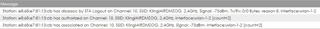

interestingly, the "not connecting" case maybe has another reason - I can see the DHCP Discover and the offer is sent. but then nothing else happens.
My AP's are Zyxel NWA1123-ACv2 - working flawless for all clients (stupid webradios, old windows phones, notebooks, android devices, iOS devices, raspberry PI (zero1, zero2, 3, 4), tasmota devices) flawless. only ESPs give me always a headache with not clearly reproduceable glitches.

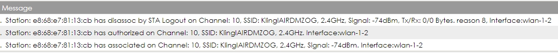

what looks strange to me: I always can see more than one DHCP request in unhidden case, and also the log on the AP looks like it does connect, disconnect, and connect again (sse the count=2) while in hidden (not working) case = can see only one connect and also only one DHCP request arriving: besides this, the log on the AP looks identical.
with 20240414 I can also see two DHCP requests, but the AP log looks different. it does not distinguish between hidden / unhidden SSID at all:
