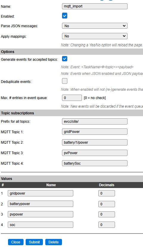

Re: bugfix working: ESP Easy on M5StickPlus no Display, but other bug
#18 Post by janssenuwe » 24 Jan 2025, 12:07
I followed basically your instructions concerning git usage.
I downloaded the espeasy-1 repo and switched to branch
feature/P137-add-settings-for-m5stickc-plus_03394ac
Build worked (ESP_Easy_mega_20250124_display_ESP32_4M316k.bin) but still I cannot upload.
I worked around using another flash tool and setup my previous environment on a M5StickCPlus.
The good news is that a can control ldo2 (connected to backlight/display brightness) successfully.
Alas, MQTT steadily keeps disconnecting and I cannot receive subsribed topics.
Here the log:
872410: IMPT : [mqtt_import#gridpower] subscribed to evcc/site/gridPower
872413: IMPT : [mqtt_import#batterypower] subscribed to evcc/site/battery/1/power
872425: IMPT : [mqtt_import#pvpower] subscribed to evcc/site/pvPower
872427: IMPT : [mqtt_import#soc] subscribed to evcc/site/batterySoc
872500: MQTT : Connection lost, state: Disconnected
872508: EVENT: MQTT#Disconnected
874241: MQTT : Connected to broker with client ID: Display_1
874247: Subscribed to: Display/#
874266: EVENT: MQTT#Connected
874330: IMPT : [mqtt_import#gridpower] subscribed to evcc/site/gridPower
874333: IMPT : [mqtt_import#batterypower] subscribed to evcc/site/battery/1/power
874346: IMPT : [mqtt_import#pvpower] subscribed to evcc/site/pvPower
874350: IMPT : [mqtt_import#soc] subscribed to evcc/site/batterySoc
874464: MQTT : Connection lost, state: Disconnected
874472: EVENT: MQTT#Disconnected
875981: WD   : Uptime 15  ConnectFailures 0 FreeMem 217104 WiFiStatus: WL_CONNECTED 3 ESPeasy internal wifi status: Conn. IP Init
876202: MQTT : Connected to broker with client ID: Display_1
876208: Subscribed to: Display/#
876222: EVENT: MQTT#Connected
876333: IMPT : [mqtt_import#gridpower] subscribed to evcc/site/gridPower
876349: IMPT : [mqtt_import#batterypower] subscribed to evcc/site/battery/1/power
876354: IMPT : [mqtt_import#pvpower] subscribed to evcc/site/pvPower
876356: IMPT : [mqtt_import#soc] subscribed to evcc/site/batterySoc
876421: MQTT : Connection lost, state: Disconnected
876431: EVENT: MQTT#Disconnected
884135: IMPT : [mqtt_import#gridpower] subscribed to evcc/site/gridPower

Am I missing something?
Best Regards,
Uwe

#19 Post by Ath » 24 Jan 2025, 12:09
How is your MQTT Import plugin setup (ESPEasy side)?

#20 Post by janssenuwe » 24 Jan 2025, 12:19
may i send a screenshot or is a conguration download usefull?
janssenuwe
Posts: 19
Joined: 06 Jan 2025, 11:13
Re: ESP Easy on M5StickPlus no Display
#21 Post by janssenuwe » 24 Jan 2025, 12:24
Here my configuration and rules
https://drive.google.com/drive/folders/ ... sp=sharing
Best Regards,
Uwe
#22 Post by Ath » 24 Jan 2025, 12:26
Better include the screenshot as an attachment to the message, so it will retain
#23 Post by janssenuwe » 24 Jan 2025, 12:43
Screenshots attached.
#24 Post by Ath » 24 Jan 2025, 14:56
Maybe the MQTT Controller Keep Alive Time setting should be changed from 0 to 60 sec. (AFAIK, that should have been done by the automatic upgrade :shock:)
janssenuwe
Posts: 19
#25 Post by janssenuwe » 24 Jan 2025, 19:46
I have been AFK until.
That helped, Thanks a lot. :D
