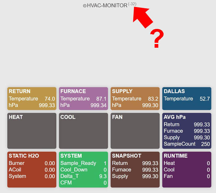

#209 Post by ThomasB » 12 Feb 2025, 17:21
I am not quite sure what you mean? Do you mean the unit number in the url? e.g.: "?unit=2"
I mean the negative number at the page title, which constantly changes. See image.
Screenshot showing numeric value at title.
Could you test this for me? (Not necessarily for the new functions just to see if the layout still works as expected
Works the same as before, but now is in color rather than gray. The image above was captured with your test release.

#210 Post by TD-er » 12 Feb 2025, 17:28
Maybe the negative number is the RSSI?

unit-name: the unit-name of the unit that is actual selected. next to it is the signalstrength in dBm of this unit.

TD-er wrote: 12 Feb 2025, 17:28 Maybe the negative number is the RSSI?
ThomasB wrote: 12 Feb 2025, 17:21 I mean the negative number at the page title, which constantly changes. See image.
maybe i should change this to a more human readable/understandable number/icon

#213 Post by ThomasB » 12 Feb 2025, 18:29
Cool. Would never have guessed it was the device's RSSI. Apparently I missed the github info that said it was signal strength, so my bad.

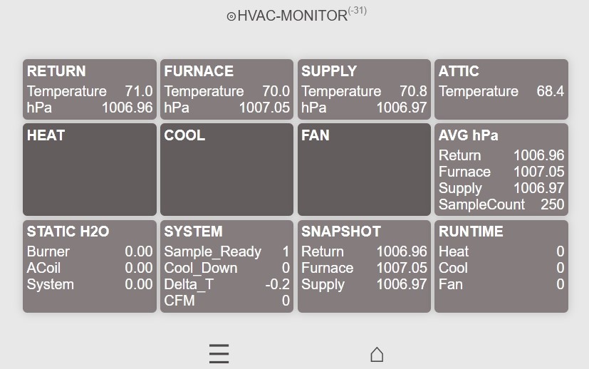

#225 Post by ThomasB » 19 Feb 2025, 01:48
Testing was a success. I created a layout that works well for my application. No issues, was intuitive.
Two things I couldn't figure out: (1) How to restore a fully hidden tile. (2) How to colorize switch-input tiles (off state) and empty tiles.
BEFORE:
BEFORE (earlier easyfetch)
AFTER:
AFTER (latest easyfetcy)
Thanks for the new features. This thing rocks!
