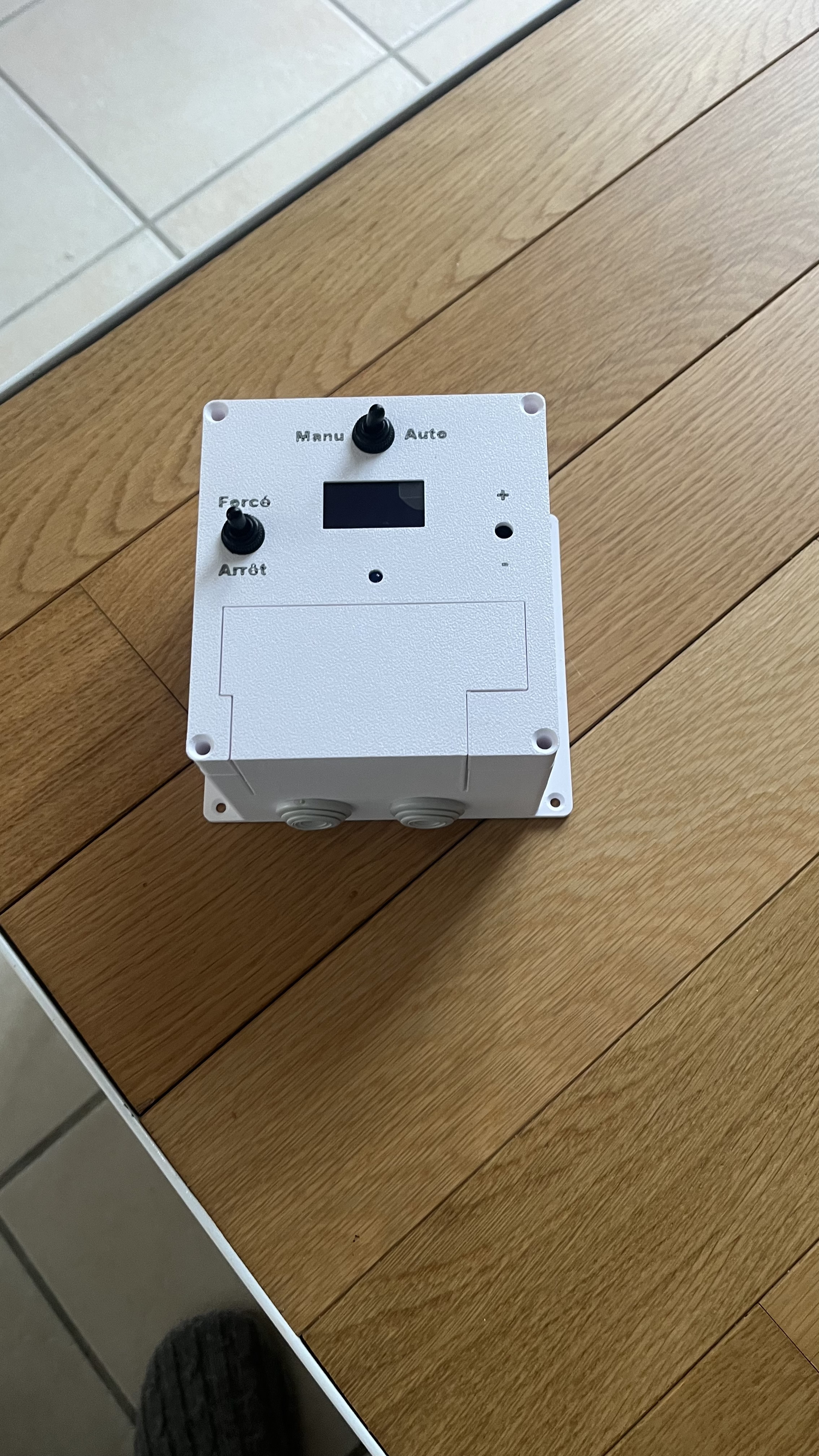

Hello everyone,
I need help creating an ESP Easy rule to automatically manage my pool filtration. Since I’m a beginner, I’m struggling to design a rule that integrates multiple essential functions. Here’s a summary of my needs:
1. How Pool Filtration Works
Filtration is crucial to keeping the water clean and preventing algae growth.
Why?
When the water temperature exceeds 12°C, the risk of algae growth increases (especially due to UV exposure).
Below 10°C, a reduced filtration time (e.g., 1h30) is sufficient to circulate the water and prevent stagnation.

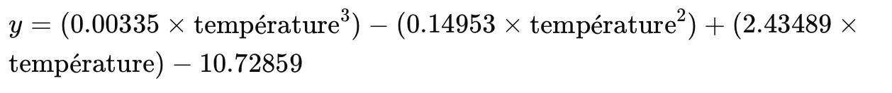

Advanced Method – Abacus Curve:
Instead of using a simple formula (e.g., temperature/2), I’d like to use the "Abacus curve" method (like in Jeedom’s pool plugin) to optimize energy consumption and ensure effective filtration.
Example: A minimum duration of 1h30 at 10°C, adding 0.5 hours per degree above 10°C.

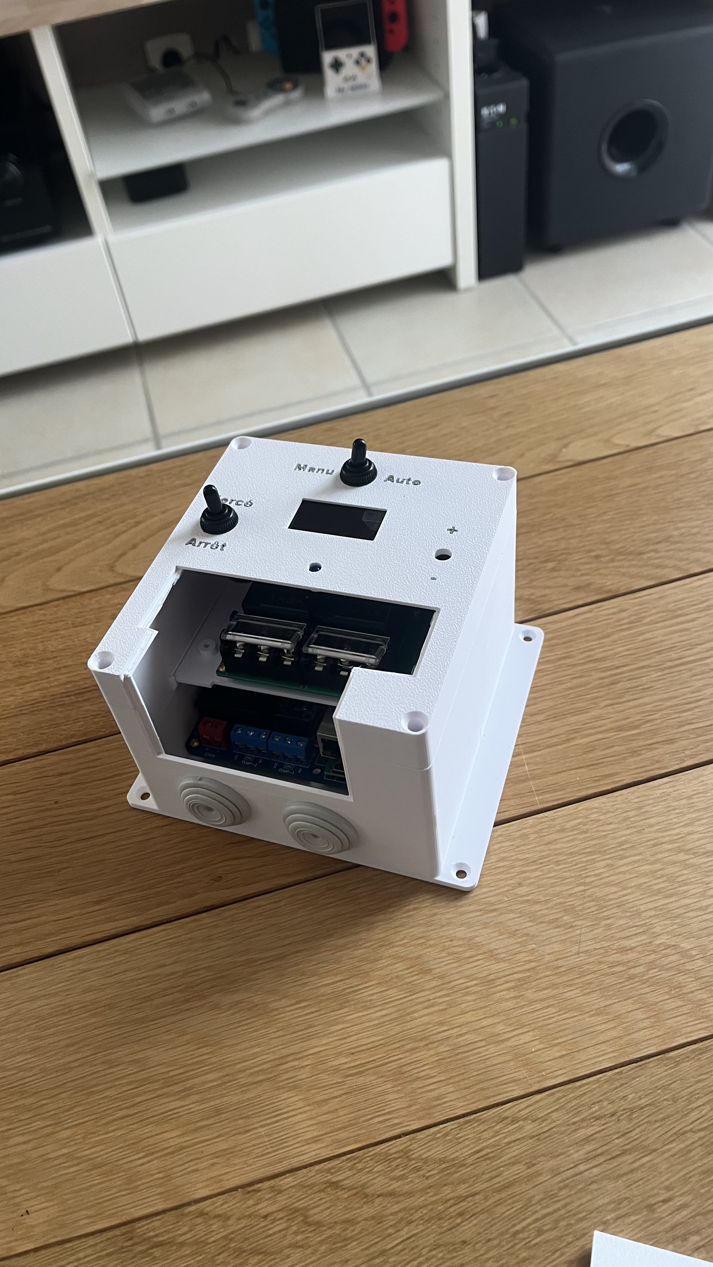

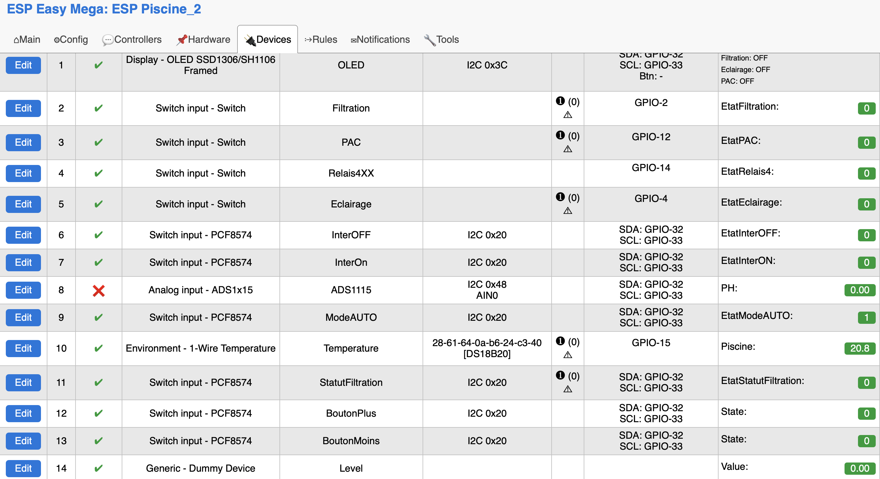

2. Hardware Setup and Devices
Here’s a breakdown of my installation, based on my JSON configuration:
Temperature Sensors:
Pool: Task “Temperature” (Name: Piscine) – Displays the pool water temperature.
Outdoor: Task “Temperature” (Name: Extérieur) – Used for display on the OLED screen.
Filtration Control and Other Features:
Filtration: Task Filtration on GPIO2 (value: EtatFiltration).
Heat Pump (PAC): Task PAC on GPIO12 (value: EtatPAC).
Lighting: Task Eclairage on GPIO4 (value: EtatEclairage).
Switches:
ModeAUTO: Task ModeAUTO (value: EtatModeAUTO) to toggle between automatic and manual mode.
InterON/InterOFF: Tasks InterOn and InterOFF (values: EtatInterON and EtatInterOFF) to force filtration ON or turn it OFF.
Filtration Duration Adjustment:
Two push buttons named boutonPlus and BoutonMoins (value: State) should allow increasing or decreasing the filtration duration in percentage (e.g., from 50% to 150%).
OLED Display (Task: OLED):
Line 1: "Pool Water: [Temperature#Piscine] °C"
Line 2: "Outdoor Temp: [Temperature#Extérieur] °C"
Line 5: "Mode: ..." (updated via a rule)
Line 6: "Filtration: ..." (ON/OFF via a rule)
Line 7: "Lighting: ..." (ON/OFF via a rule)
Line 8: "PAC: ..." (ON/OFF via a rule)
3. Desired Features
Automatic Filtration:
Filtration duration is automatically calculated based on the temperature using the Abacus curve (e.g., a minimum of 1h30 for T < 10°C, with +0.5h per degree above 10°C).
This duration, considered as 100%, should be adjustable via a multiplier.
Manual Adjustment via Buttons:
I want to increase or decrease the filtration duration in percentage (from 50% to 150%) using the boutonPlus and BoutonMoins buttons.
Anti-Freeze Protection:
If the temperature drops below a critical threshold (e.g., < 3°C), the pump must activate immediately to prevent pipes from freezing, even if it’s outside the normal filtration cycle.
Power Outage Safety:
Option 1: On restart, the ESP turns off the pump for safety and recalculates the filtration cycle if the reboot happens after the expected start time (even if it results in extra filtration, which is acceptable).
Option 2: Memory Storage – To avoid losing data during a power outage, I want to save the calculated filtration duration in non-volatile memory. The idea is to store this value once per day, so the system can resume its cycle normally after a reboot without requiring manual intervention.
Here’s my current functional code, but it lacks the ability to adjust filtration times via the Plus and Minus buttons, which I don’t know how to implement:

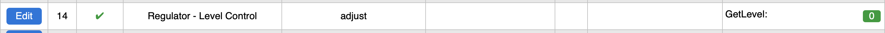

In another post that was slightly drifting off-topic, TD-er provided me with a draft rule that I tried to update (Names and Values), as well as shorten the timers for testing. I also added screen displays to better see the plus and minus buttons, etc.
However, I couldn’t get the code to work, so I’m continuing my research.
I’m reposting the code here:

I removed the OLED messages that weren’t displaying anything and put the code back. I only tried the dummy device.
Capture d’écran 2025-03-10 à 18.28.03.png (572.4 KiB) Viewed 4938 times
Maybe my Dummy device, I don't know.

Posts: 9895
Re: [Help Needed] ESP Easy Rule for Automatic Pool Filtration Management
#3 Post by TD-er » 10 Mar 2025, 20:23
I don't see a task using the "Level" plugin, only one called "Level" but using the Dummy plugin.
To set a value in a Dummy task, you need the command "taskvalueset"
However those values are not stored in flash and thus lost after a power cycle.

About the "Regulator" task (named "adjust")
It looks like you changed the output name to GetLevel
This is not what you should do, as this Regulator plugin allows for specific commands to get the actual setting.
The output (which was originally named "Output") is only the state of any coupled GPIO pin. Thus either "1" or "0".
The level (which you can set using "config,task,<taskname>,SetLevel,<value>" and get using [<taskname>#GetLevel]) is some parameter you can use to set a threshold.

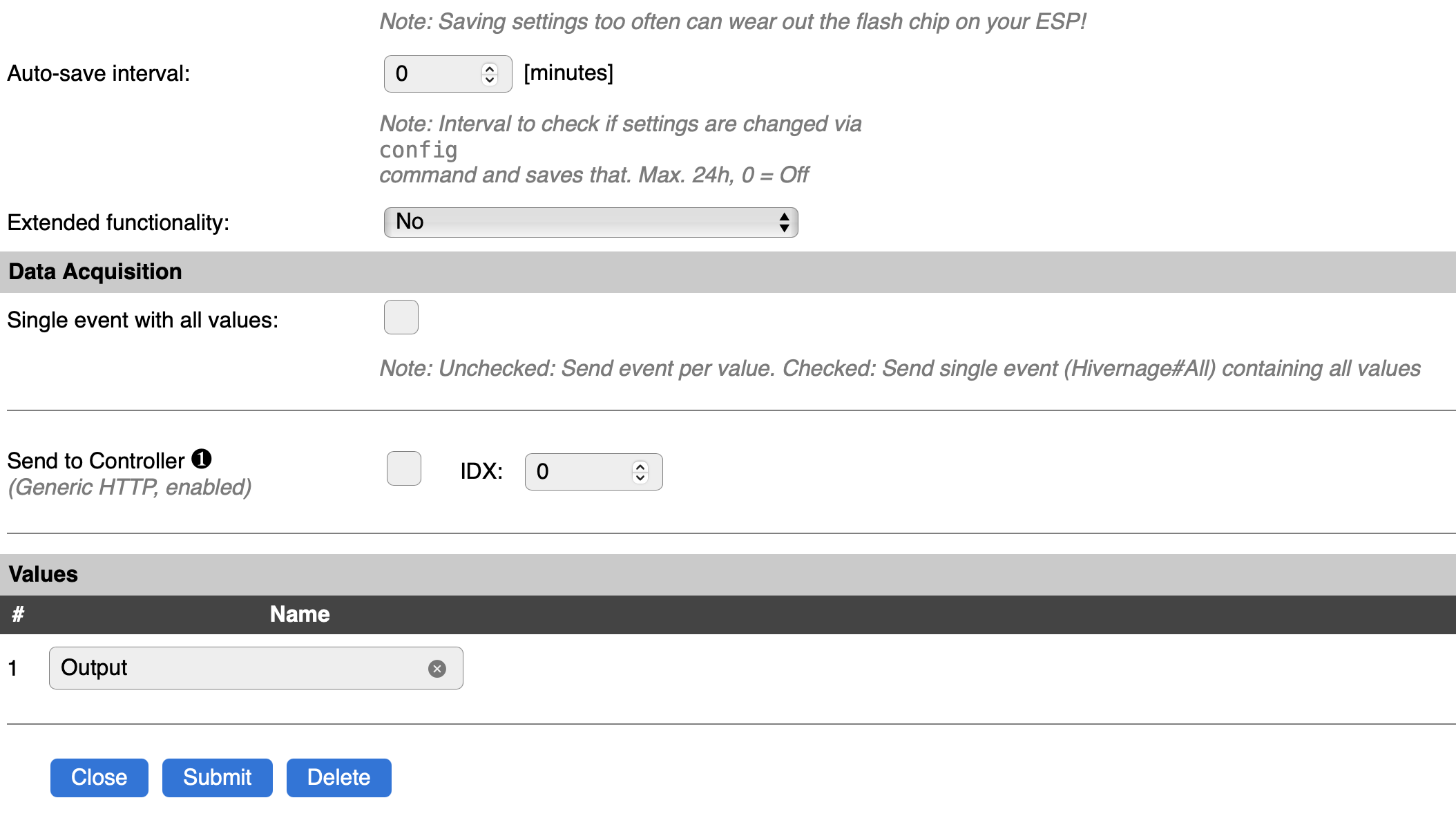

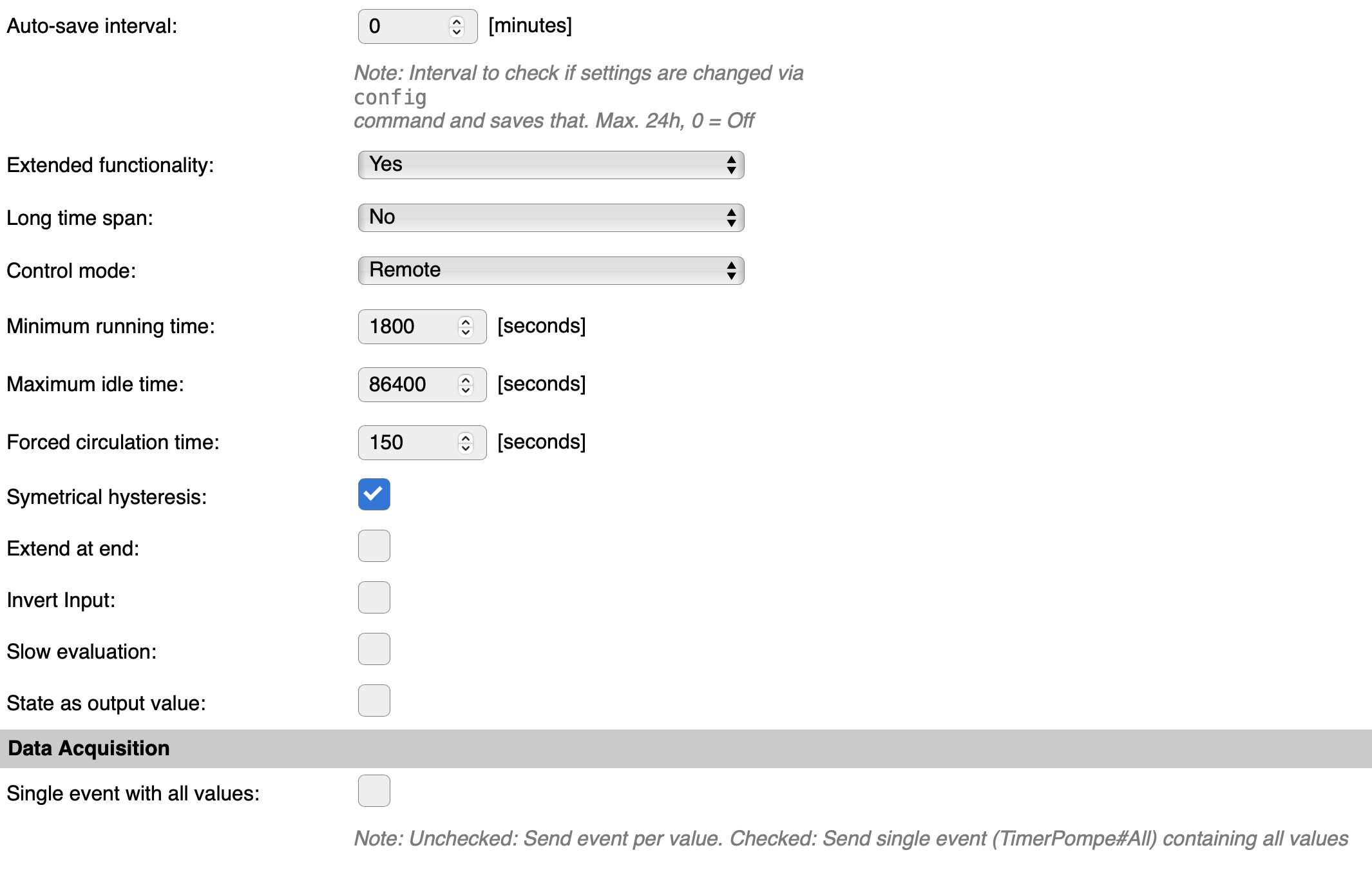

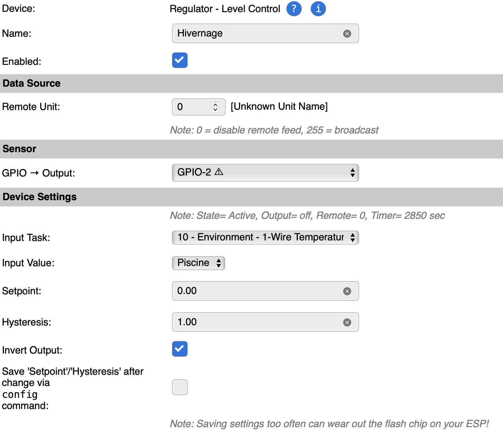

One that I named Hivernage (Wintering) with its settings.
Capture d’écran 2025-03-11 à 17.22.41.png (205.32 KiB) Viewed 4801 times
Capture d’écran 2025-03-11 à 17.22.54.png (190.12 KiB) Viewed 4801 times
It gets complicated for the second one: :D

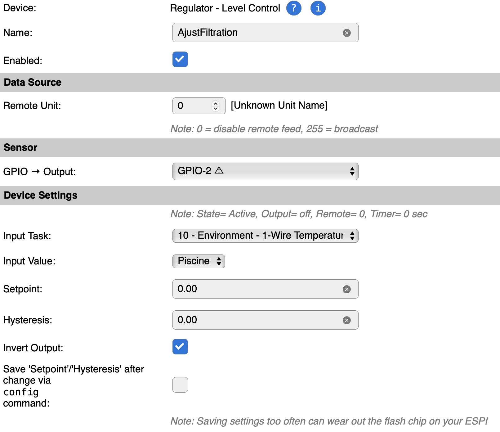

I named it AjustFiltration and I activated the remote function. All the other settings, I did not touch them.
Capture d’écran 2025-03-11 à 17.30.47.png (205.83 KiB) Viewed 4798 times
Capture d’écran 2025-03-11 à 17.24.25.png (229.99 KiB) Viewed 4801 times
Capture d’écran 2025-03-11 à 17.24.35.png (56.01 KiB) Viewed 4801 times

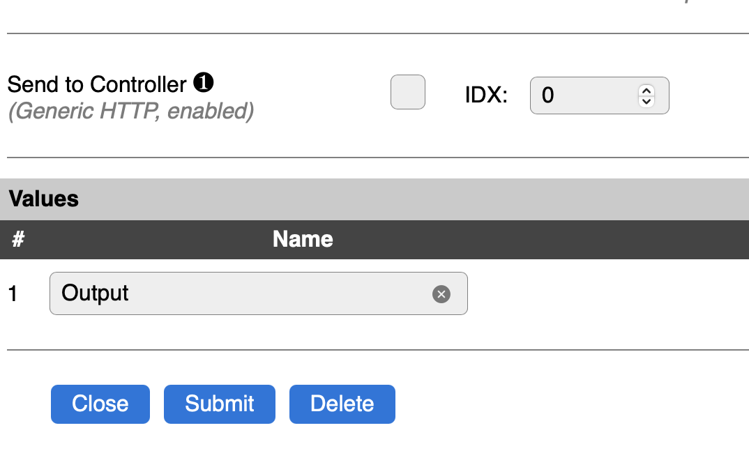

You tell me that I changed the output name to GetLevel and that it is not what I should have done, so I put everything back to default.
Finally, I saw that we could put a tank for the oled screen.
This is what I am missing to be able to send the information back to the screen because it is not easy to test without sending information back.
Finally, indeed, it will be necessary to review the calculation method based on the curve because I was MORE than wrong on the calculation (which by the way, I do not know)... Sorry.

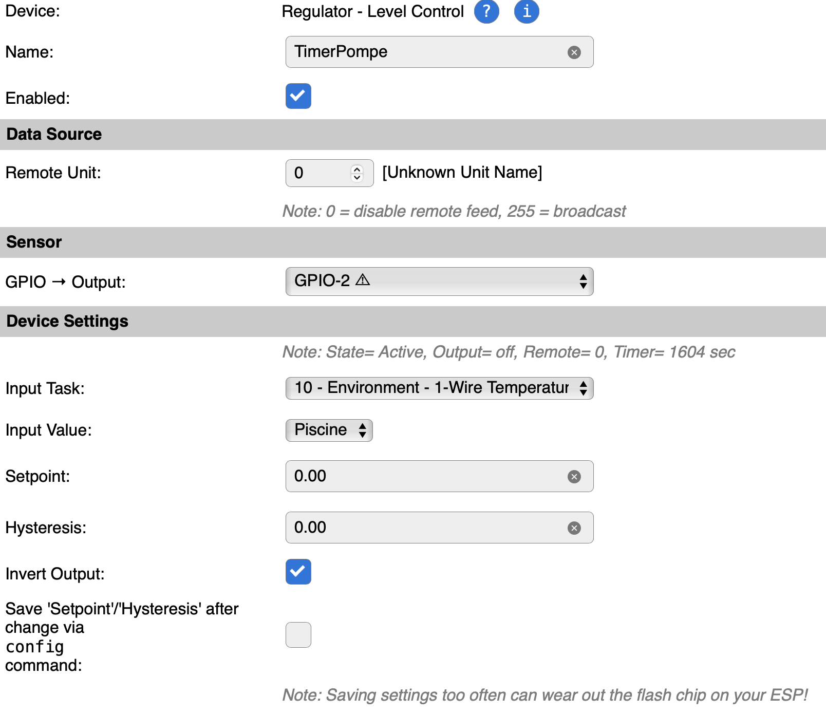

Nope, you got it wrong... (edit: this is a reply to your earlier reply, not about renaming the temperature sensor)
First of all, why try to change the names before getting it to work?
Now you're introducing lots and lots of uncertainties as there can be some extra typing errors and it makes it harder to compare with the example.
Let's first completely ignore the adjustment factor as it apparently makes it way more confusing.
The adjustment "Level" task was only to keep the adjustment factor stored in the settings.
However you're now trying to also let this one control the GPIO pin which is absolutely not the intention.
There should be only 1 task controlling the GPIO to the pump and that's the first "Level" task.
So please forget the second Level task for now and only focus on the main "Level" task.
If you want to call it "Hivernage", that's fine.
Based on the screenshots, you need to set the "Setpoint" to 3.00 (degree C)
It looks like you also need to enable the "extended functionality" here to be able to use the "remote" command. (this should be added in the documentation)
The second "Level" task probably has a typing error in the task name, as you called it "AjustFiltration", where I'm missing a "d".
N.B. if you change these names, then all related names in the rules also need to change, so that's why I don't understand why you want to change so many things at once as it will be really hard to find the errors.
Just as a general tip when working with these kind of things: Try only to change 1 thing at a time and try to start making small parts work first.
This one does NOT control any GPIO, so the GPIO field should be left empty.
Also it does NOT need an input task. It ONLY needs to store the "Setpoint". Nothing else!
I also see a third screenshot of a task using a "Level" plugin, which is absolutely not needed right now.
So can you tell me what tasks are now present?
I don't know what I am looking at.

Neoseb38
Posts: 122
Joined: 02 Dec 2024, 18:48
Re : [Aide nécessaire] Règle facile ESP pour la gestion automatique de la filtration de la piscine
#11 Post by Neoseb38 » 11 Mar 2025, 18:38
I'm really sorry.
I tried to replace the names that I changed in the code and I didn't see everything...
I thought I was doing the right thing because it would be so much easier for me to find my way around and understand (with all this new information)
As for the second level task, I misunderstood (probably with the translator) your instructions:
So the setup can be as simple as this:
- Configure your Level task and set it to directly operate the pump so it will control the pump directly based on the temperature.
- Calculate the pivot-point duration/start time/end time
I also thought that this function would also control my plus and minus buttons to adjust the adjustment... ( :roll: )
I renamed it AjustFiltration because in French we say "Ajustage" (sorry again)
I removed the gpio and input task fields that I set to none.
I left the remote function.
Should I leave the setpoint at 0?
As for wintering, I add the "extended functionality" here to be able to use the "remote" command.
I didn't think I was doing anything wrong by setting the set temperature to 0°C, it's just that I preferred to set the right temperature right away (and I would even go down to -2 from experience) because over the years, I realized that running the pool as soon as it's 0 outside when the water is not even at 4°C was not very economical.
What I don't understand is how to test all this?
Is it possible to put a display on the screen to be able to see for example if my plus and minus buttons work etc...

Then, I'll have to find a way to get as close as possible to the curve.
I found this:
Here is the calculation formula for the curve:
Capture d’écran 2025-03-12 à 06.26.15.png (29.04 KiB) Viewed 4649 times
I find HERE:
https://domo.rem81.com/index.php/2022/0 ... pdaemon-2/
In any case, I'm very happy with this code and can't wait to confirm the tests for the future.
Thanks again for everything.
I know we're not there yet, but will it be possible to make all this work only when the auto mode is enabled? (interrupter)
Because for the moment, the code overrides my forced on and off filtration interrupter.
PS: Beers might indeed be a real problem :lol: :lol:
Neoseb38
Posts: 122
#15 Post by Neoseb38 » 12 Mar 2025, 09:51
The formula works and fits well with the blue 100% curve.
However, you have to keep all the numbers after the decimal points, otherwise the result in hours will be very different.
Do you think this formula is feasible for espeasy? :shock:
Posts: 9895
#16 Post by TD-er » 12 Mar 2025, 10:01
Sure, the floating point variables in ESPEasy are of type 'double'.
Meaning you have roughly 16 decimals to work with (compared to the 6 - 7 decimals of a 'float' type)
Just using variable #10 here as that one isn't used.
let,10,[Piscine#Temperature]^3*0.00335
let,10,[var#10] - ([Piscine#Temperature]^2 * 0.14953)
let,10,[var#10] + ([Piscine#Temperature] * 2.43489)
let,10,[var#10] -10.1072859
And then your calculated value can be used in the rules (or on displays, or anywhere you need it) by referring to [var#10]
N.B. I used [var#...] here instead of [int#...] as we need to keep the decimals.

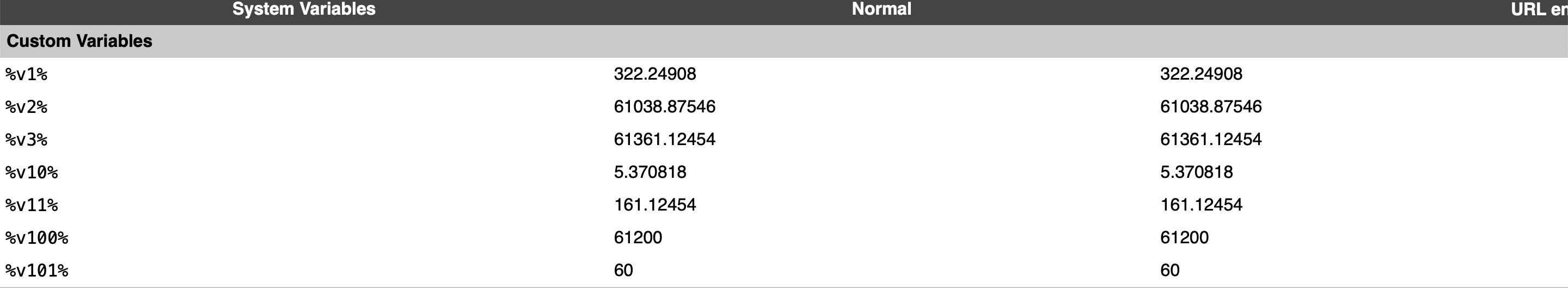

Neoseb38
Posts: 122
#24 Post by Neoseb38 » 12 Mar 2025, 16:25
I just got home (I haven't changed the rules yet).
The variables have appeared, but the filtration relay is off.
Capture d’écran 2025-03-12 à 16.22.18.png (57.78 KiB) Viewed 4511 times

Posts: 9895
#25 Post by TD-er » 12 Mar 2025, 16:38
Can you show your complete rules?
These values are strange, as it suggests the total duration is 1 sec.

#28 Post by Neoseb38 » 12 Mar 2025, 17:17
just in case:
Capture d’écran 2025-03-12 à 17.16.35.png (182 KiB) Viewed 4486 times
Capture d’écran 2025-03-12 à 17.16.46.png (195.89 KiB) Viewed 4486 times
Capture d’écran 2025-03-12 à 17.16.56.png (150.87 KiB) Viewed 4486 times
PS: I can't send anything in PM.

#30 Post by TD-er » 12 Mar 2025, 17:21
Ah it is good I put that adjustment factor in a comment, as you have set it to 0, not 1.
So for now we just ignore it. Something for later when the rest is working.
Neoseb38
Posts: 122
#31 Post by Neoseb38 » 12 Mar 2025, 17:25
Are you talking about that?
Capture d’écran 2025-03-12 à 17.24.48.png (43.91 KiB) Viewed 4474 times

I managed to make a little progress.
I realized that the Variable V10 was wrong and did not correspond to the calculation.
I searched on my side but I didn't understand.
I ended up asking the question to different AI (not hoping for much) and only GROK to find, and the first time.
Here are his words:
- The calculation of %v10% is not complete beyond the first step.
- The calculations of %v2% and %v3% are not applied, leaving these variables at their initial value.
After advising me to add logos, he confirmed this and then remade me a code that after checking the logos will be operational.
Here is the code:

This is much better for the Abacus curve formula but I realized that the variable %v100% was also wrong.
Having exceeded the free time of grok :D I found that the error did not take into account the minutes for an example of 5:30 pm:
let,100,17*3600 + 30*60
By leaving it like this, all the variables seem to be ok.
let,100,17*3600
Capture d’écran 2025-03-26 à 18.50.17.png (104.85 KiB) Viewed 3106 times
However, my gpio2 remains off despite everything.
Even when entering the order
gpio,2,1
The relay is activated and then deactivated instantly.
Ditto through my switch for forced walking.
The only way to activate it is to modify the set point so as to set a temperature higher than the temperature recorded in"Regulator - Level Control # Hivernage.
Neoseb38
Posts: 122
#38 Post by Neoseb38 » 27 Mar 2025, 18:32
I succeeded and I will have struggled a lot.
The problem came from the temperature threshold of the level plugin that was set to 0.
So every time I tried to activate my gpio2 also controlled by this plugin, it did not work since the latter turned it off every time since temperature above 0.
So the rule couldn't work.
So I removed the gpio2 from the plugin level (Hivernage) and no more worries.
Then, and that's where I struggled, I had another problem with the rule.

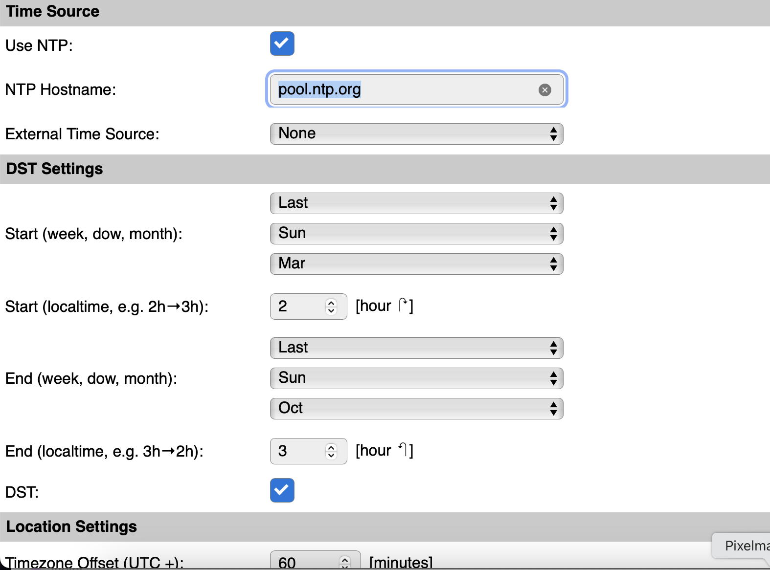

The problem came from the command %unixday_sec%.
I ended up with a lag of 1 hour between the time of the esp32 and the time found.
Living in France, I thought about hourly takeoff. However, I have settled everything in espeasy and the NTP.
Capture d’écran 2025-03-27 à 18.27.04.png (169.82 KiB) Viewed 2942 times
In short, after having fought well, I started on the %syssec_d% values that they do not change.
And there, it works:

#43 Post by Neoseb38 » 12 Apr 2025, 10:16
Hello everyone,

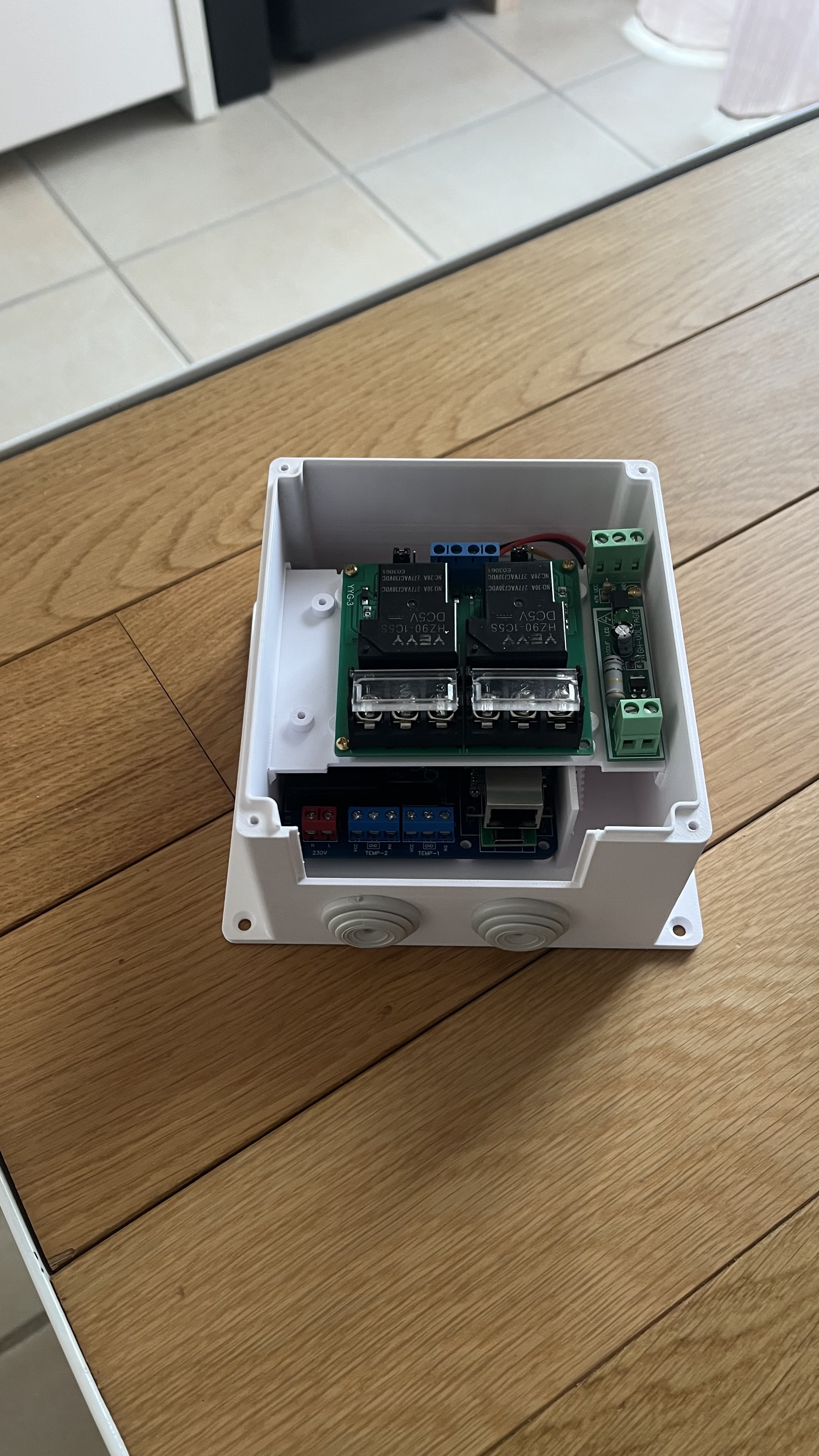

My project is coming to an end, and I am very happy.
I finally finished the design of the 3d box and just like the pcb, it was a great first.
I also left room for an evolution towards PH reading and therefore the module that goes with it.
At the moment everything works perfectly well.
I still lack a little thing to put in the rules but for that I will have to be able to activate my gpio2 via a switch-type dummy device but I can't do it.
I can do it via the command line but not through a rule.
In short...
I have a question:

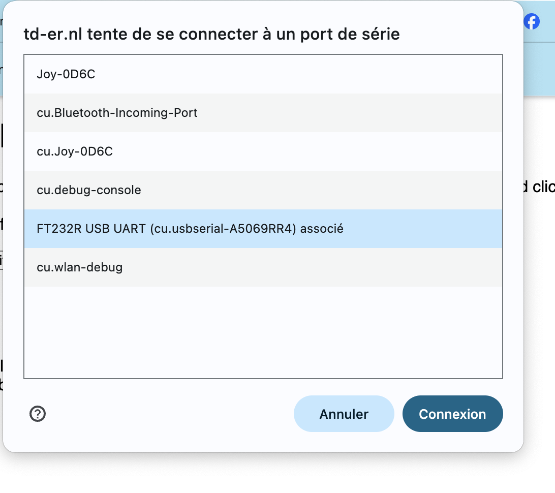

This project must manage my pool but also that of my father-in-law.
Only how do I proceed to make a copy of my esp32?
I make a backup of my espeasy, I go back herehttps://td-er.nl/ESPEasy/latest/ for a new installation and then I restore or is there faster?
Once the new installation is complete, do I have to go to this ip address 192.168.4.1? (Sorry but I had struggled and I don't remember anymore)
There was a password to enter I think?
If I do all this from home, once at my father-in-law's with new wifi, how do I do it please?
For future updates, I have to install the versions without the factory, is that right?
PS: the screen in the photos is not broken, I just didn't remove the protective film :D and I have not yet received my momentary inter 3 positions for the increase / decrease in filtration time.

The Tools page has a Backup files button that will create a .tar file with all files on the file system of the ESP, including all configuration. Be sure to have your browser save that file, as .tar is a really old, but simple, archive that's deemed 'old' by most browsers and they are reluctant to save it.
This backup file can be restored on another, similar, ESPEasy unit using the Load button on the Tools page. (The .tar file should be uploaded without being renamed!)
The reboot that's suggested after the Load is completed is mandatory!
When restoring on a new unit, the unit number and device name should be changed, and when using a fixed IP-address that must also be changed.
Neoseb38 wrote: 12 Apr 2025, 10:16 For future updates, I have to install the versions without the factory, is that right?
Updates can be installed on the Tools page, using the Update Firmware button. The .factory.bin file is uploaded only once, for the initial setup, when using an external tool, via the ESPEasy UI you select the (somewhat smaller) .bin file.
The initial connection to WiFi is indeed via the AP provided from the ESP, but can also be done from https://td-er.nl/ESPEasy/latest/.

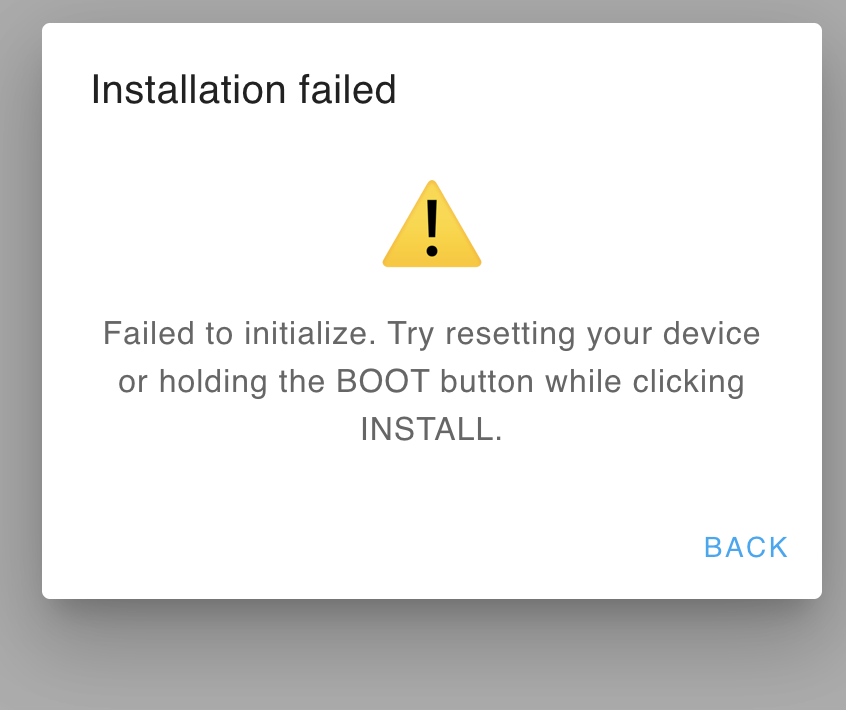

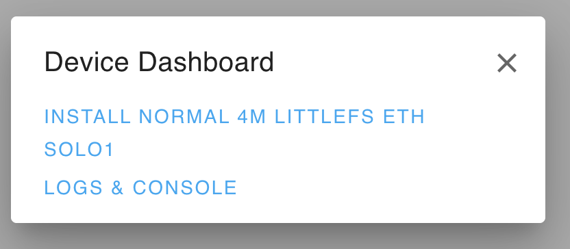

I spent the whole morning trying to install espeasy on my esp32 ETH01 but I didn't succeed.
I had already struggled the first time but now I can't.
However, I connected well like this:
IO0 on hinge at startup.
Tests with reset (EN on GND), in short hundreds of tests but in vain.
Capture d’écran 2025-04-13 à 15.32.57.png (67.31 KiB) Viewed 1050 times
Capture d’écran 2025-04-13 à 15.32.38.png (42.84 KiB) Viewed 1050 times
Capture d’écran 2025-04-13 à 15.32.25.png (155.59 KiB) Viewed 1050 times

#48 Post by Ath » 13 Apr 2025, 17:04
Most likely the serial adapter doesn't deliver enough power to start up the ESP. Better use a separate 5V power supply to the 5V pin of the ESP. The GND must be shared with the GND coming from the serial adapter, and 3V3 from the serial adapter must be disconnected from the ESP board.

#49 Post by Neoseb38 » 13 Apr 2025, 17:27
Thank you, I'll try this way.
Can you tell me the exact manipulation to do with the gpio0 and the EN please?
I start with the gpio0 connect to GND then once turned on, I unplug?
For the EN terminal and the nest, do I just have to make a pulse?
DSL but I mix the brushes :D

This sounds right. Keep GPIO-0 connected to ground, then power-up or reset (EN to GND) the unit. Then it's in Flash-mode, and GPIO-0 can be disconnected. After flashing the unit will most likely be software-reset, so the flasher is expecting to be able to connect to the ESP, but that requires GPIO-0 to be floating, and not to GND, so best to disconnect that pin once it's in Flash-mode.
