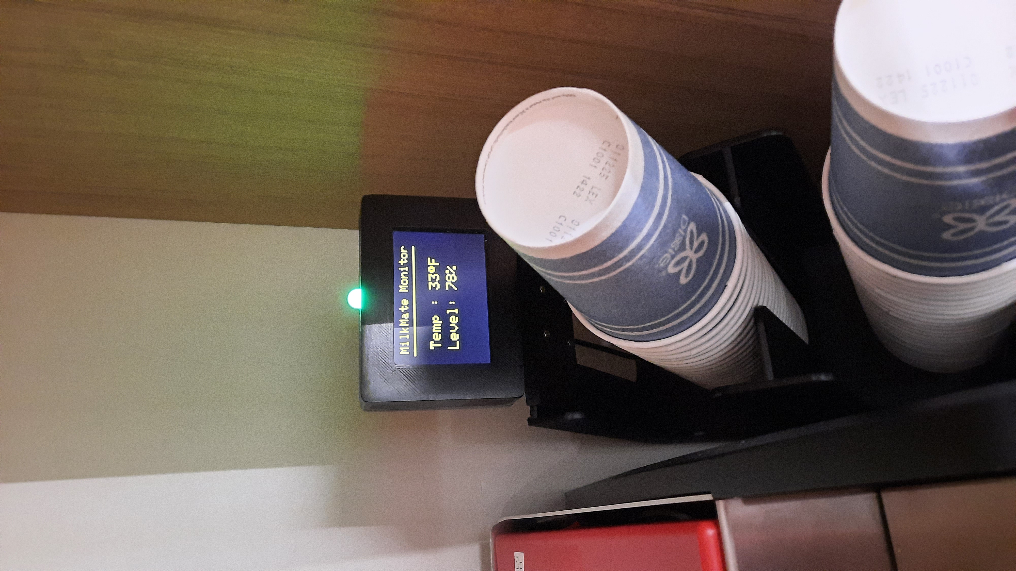

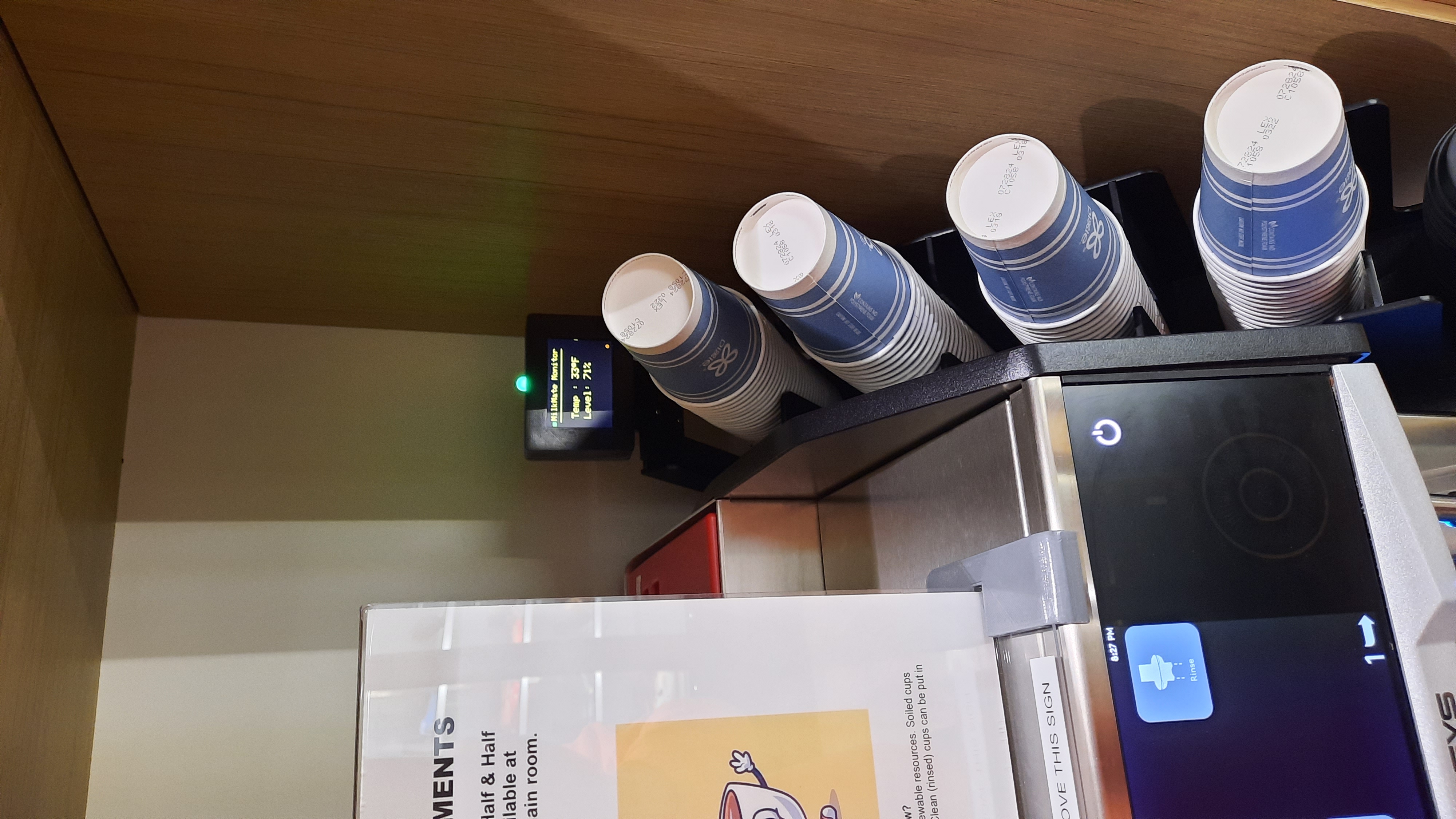

The finished system is shown below.

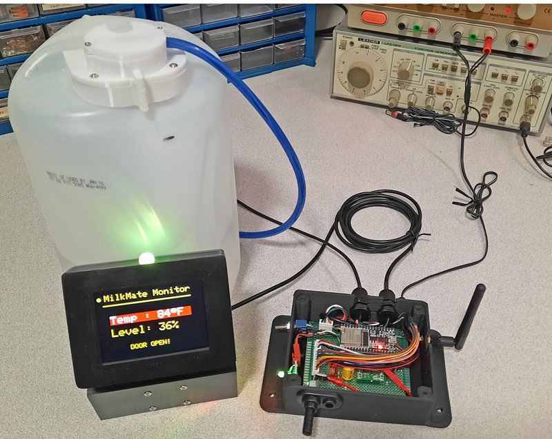

The ESPEasy Hardware is shown below:
Some notable things:

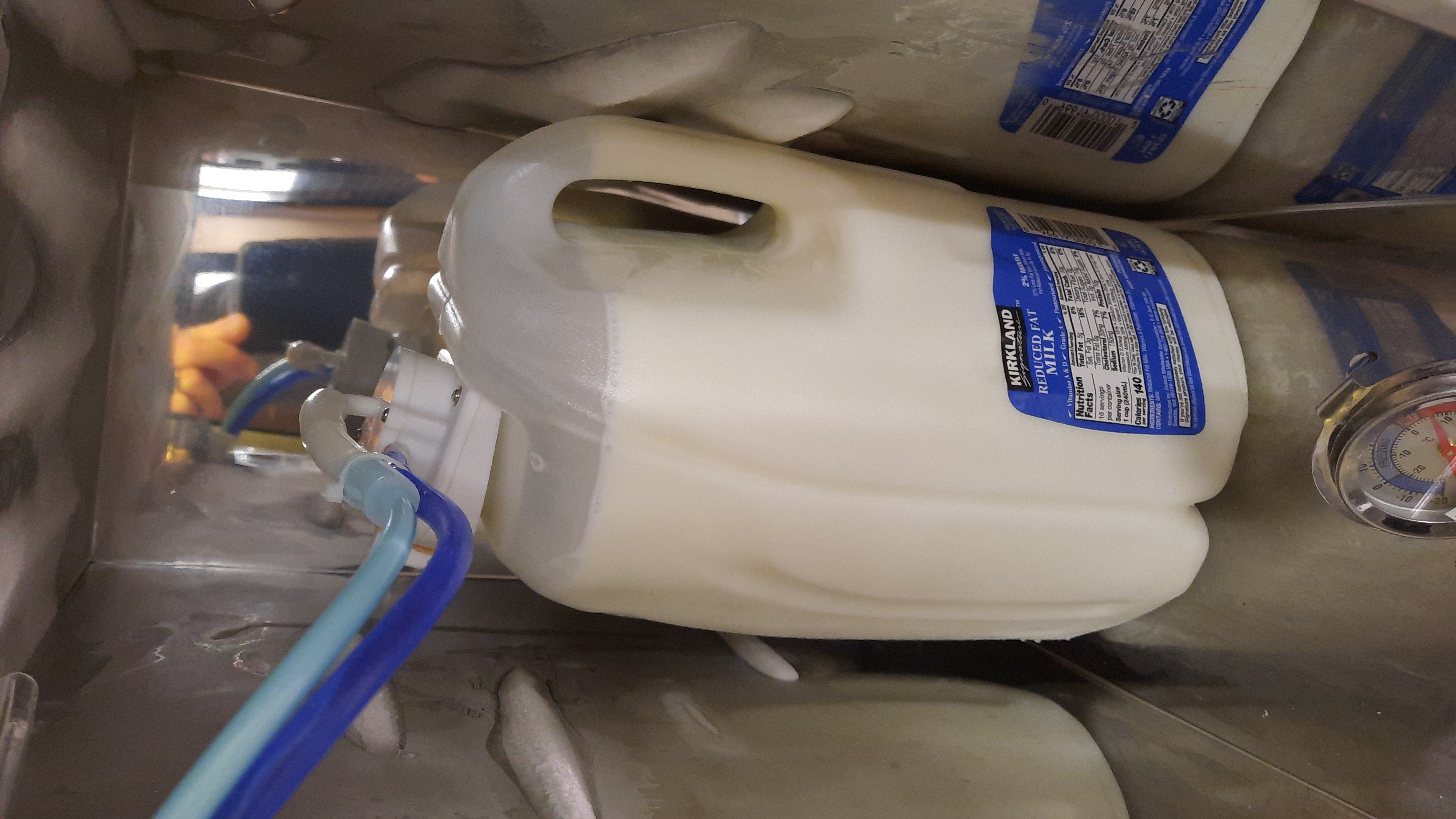

▪ A VL53L1X non-contact distance sensor (optical laser) determines liquid level. It measures distance from top of jug downward to milk surface. Math does the rest.
▪ This optical laser is in a plastic assembly that rests on top of the milk container. It touches the container, NOT the milk.
▪ The color display mounts on a cup holder rack next to the machine. It reports 0-100% milk level and its temperature.
▪ A large RGB NEOPixel LED shows status at a glance. Green=Good Milk Level, Yellow=Low Level, Red=Milk Empty

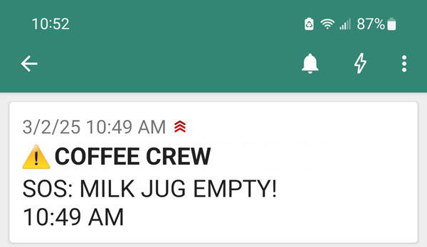

▪ Emails are sent to report status that needs immediate attention.

The issue is that the long milk suction tubing (which goes into the top of the milk container) often gets in the view of the optical sensor and disrupts the measurements. And unfortunately it causes the display to report good milk levels, even if the jug is empty.
I could solve the issue by replacing this flexible silicone hose with a stiffer suction tube so it could be directed away from view. But that would violate rule #2; No changes to equipment are permitted.
The suction tube goes though the plastic assembly that holds the sensors. It's made of three pieces, shown below. The big "tongue" seen on the top piece is used to push the milk suction tubing away from the VL53L1X distance sensor. But the tubing has a mind of its own and managing its direction is like controlling a room full of angry cats.

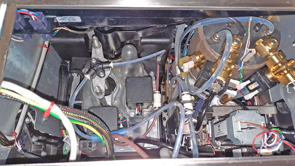

The solution I decided to use requires cutting the coffee machine's milk suction tubing. Not a horrible thing, but it bothers me because this is a modification and that breaks one of my self-imposed rules.
I'm using 6mm clear PTFE tubing that was heat-formed into a "S" curved shape. The milk cap was redesigned to hold it in a fixed position. When the cap is placed on the milk container the suction tubing is forced into a corner, out of the way of the optical sensor's view.
The PTFE tubing's top end will be connected to the long silicone hose that feeds the coffee machine. The bottom end gets a 17cm length of silicone hose terminated in a filter/sinker that lays on the bottom of the milk jug. This section of hose is the piece that will get cut off the existing suction hose.
The PTFE tubing is semi-flexible and so it's not difficult to insert it into the milk container while everything is still inside the refrigerator's tight quarters.
I haven't installed the MilkMate system on the coffee machine yet. I need to do a demo and earn approval before I can proceed. But I think I can say the project is done. And a success.

MilkMate has been in service for a while. So I think it's time to do a short presentation of the project. Although it only monitors milk status in an espresso machine at my community clubhouse, it has been a game changer.
The espresso machine is in a small convenience store that utilizes Amazon's Just-Walk-Out technology. No one is on site, customers just grab and go.
Despite being a "super-automatic" machine, the espresso maker is intended to have a staff person on hand to keep things running smoothly. But this one is on its own, with a small ghost crew that visit every couple hours to restock and clean.
BTW, using a touch screen the customer can select lattes, cappuccinos, macchiattos, espressos, and so on. All using freshly ground beans with smoothly textured milk foam. The coffee is free and tastes just as good as the local Starbucks (some say better).
At the back of the customer cup holder rack is a small color display for reporting milk level and temperature. The display's enclosure only has the TFT panel and it is connected via a long SPI cable to the ESP32 that is inside a cabinet. Power is by a wall wart. ESPEasy runs the show.
Inside a 3D printed milk jug cap is a VL53L01 distance sensor and LM75A temperature sensor. These do not come in contact with the milk, which is important for food safety.
The milk level measurements are insanely accurate. Resolution is 1% (0-100%), and device accuracy is ideal for this application. In a nutshell, the displayed milk level values are spot on.
The temperature sensor is in contact with the exterior surface of the milk jug, where as our old method relied on measuring the air temperature in the fridge. The contact method is much better.
Before MilkMate the crew member had to pull out the refrigerator from a locked cabinet and then open up the fridge to see the milk level. Now they only need to walk by the display.
But there's another trick it can do. The crew gets hourly status notifications on their phone. Urgent SOS notifications are sent if the milk runs out.
Count me in as another satisfied ESPEasy user. If any of the devs drop by, the coffee is on me.
