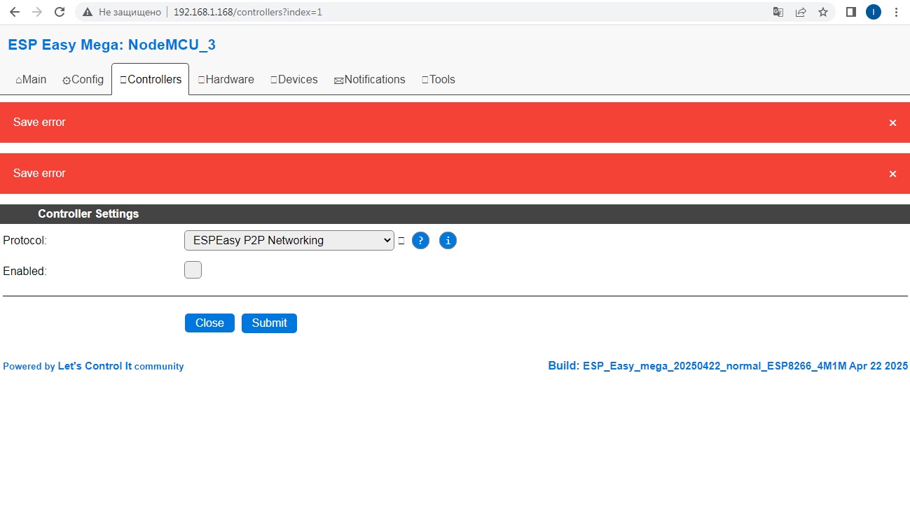

I tried to flash NodeMCU 8266 and VeMos D1 mini for new firmware that was not officially released (Build: ESP_Easy_mega_20250422_normal_ESP8266_4M1M) - I was able to successfully flash only version, after flashing the rest, both modules did not create an access point for configuration. And in this version, both modules get an error when saving any changes (screenshot)
I wanted to try the Climate firmware
Then I remotely saved the configuration of one of the working Wemos D1 mini modules with the old firmware I mentioned above (version 2022) and tried to load it into the same Wemos module, which I had just flashed with the new firmware - as a result, the new module wrote that the configuration was successfully saved, it was necessary to reboot. I reboot - and it again creates an access point and asks to connect to the home network. However, it did not transfer any configuration settings. It also resets Wi-Fi settings and creates its own access point during a software reboot from the VEB interface
When trying to update the firmware from the WEB interface, it gives an error - Update error: ERROR[2]: Flash Erase FailedI wanted to try the Climate firmware
Re: ESP32 s2 mini P2P networking
You may have done too many saves on a single day. Power-cycling the unit should solve it for now. Or there isn't enough free space to save the file. If that doesn't solve it, then you may have found the end of life for the flash chip
Yes, I know that this can be solved by rebooting the module, but here, immediately after rebooting, when saving the first change, such an error appeared.
Version 1m was installed via cable normally, but not via ESP Easy software - as it gave the same error 2
I used the program WIFI-IOT Flasher from the site wifi-iot.com.
I installed version 4M1M because I had already installed this version on these modules, but in 21-22-23 release years. Also, ESP Easy Flasher gave error 2 when selecting version 1M.
And then for some reason the module began to resist and glitch with version 4M1M.

Can you show the flash section of the sysinfo page?
Maybe also run the command "meminfodetail" first on the tools page and then load the sysinfo page.
This command will enable drawing some charts at the end of the sysinfo page regarding the partition table.
I have never seen this site, so I have no idea what this does.ilguvat wrote: ↑24 Apr 2025, 15:46 [...]
I do know that some other firmwares, other than ESPeasy, may set a different partition layout.
So maybe your partition layout is set to force a too small file system?
Updating ESPEasy will not change the partition layout.
