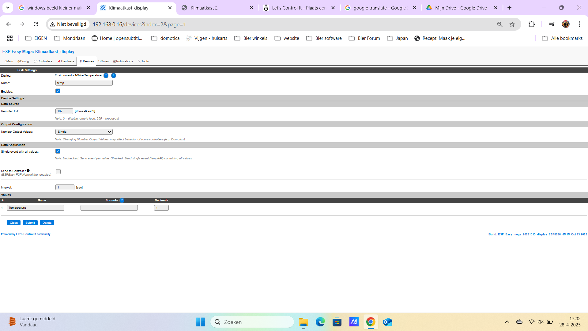

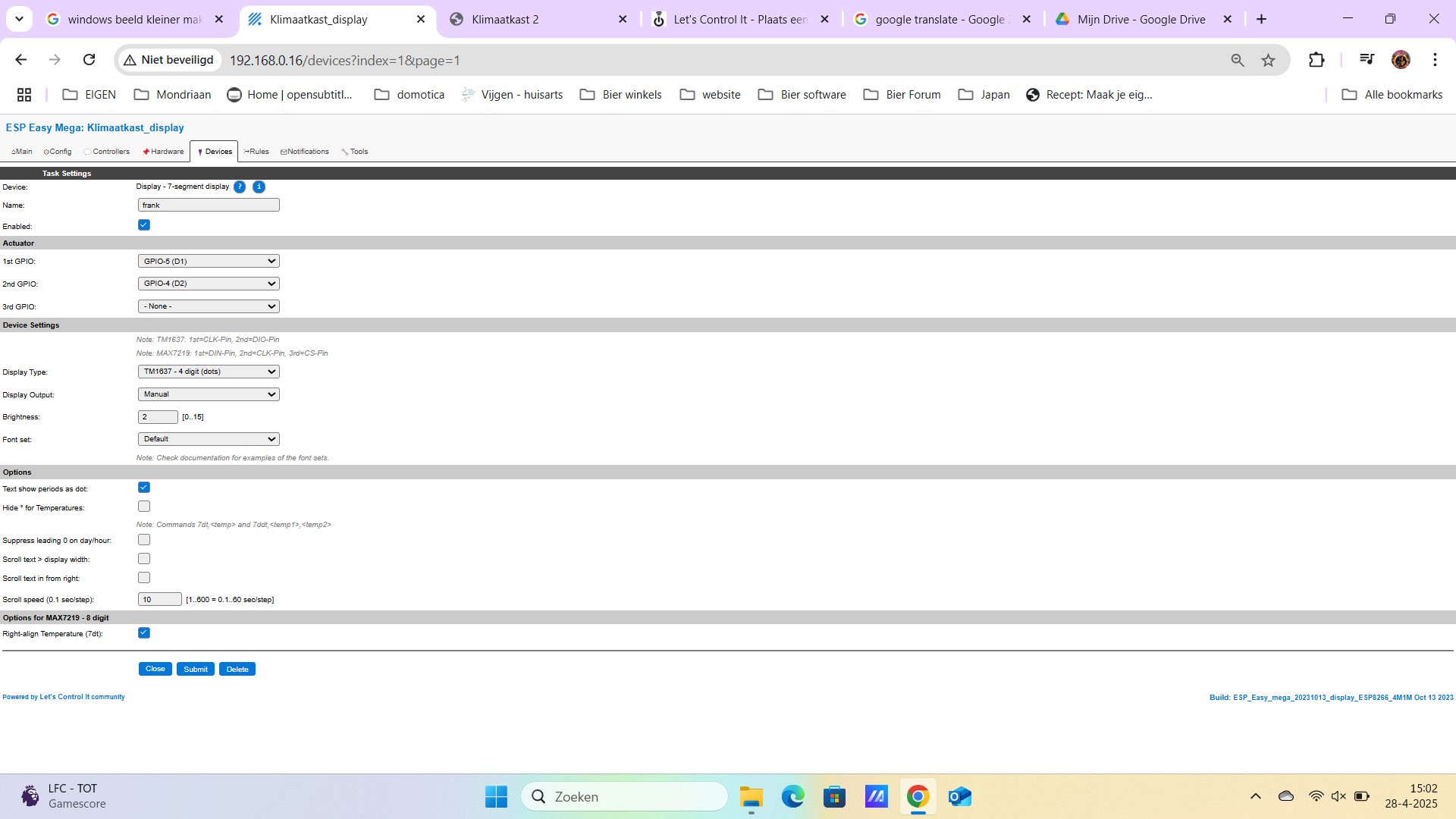

in the command line I enter the following: 7dt,[temp#Temperature]
I tried something but I don't really know what I'm doing
i dont know how to make a rule, like i said im a beginner
I have added 2 screenshots.
Thanks in advance

In Rules you can put something like this:
On temp#All do
  7dt,%eventvalue1% // First argument is the first temperature from the task, because 'Single event with all values' is enabled.

#5 Post by coenen » 28 Apr 2025, 16:49
it works.
Thank you
