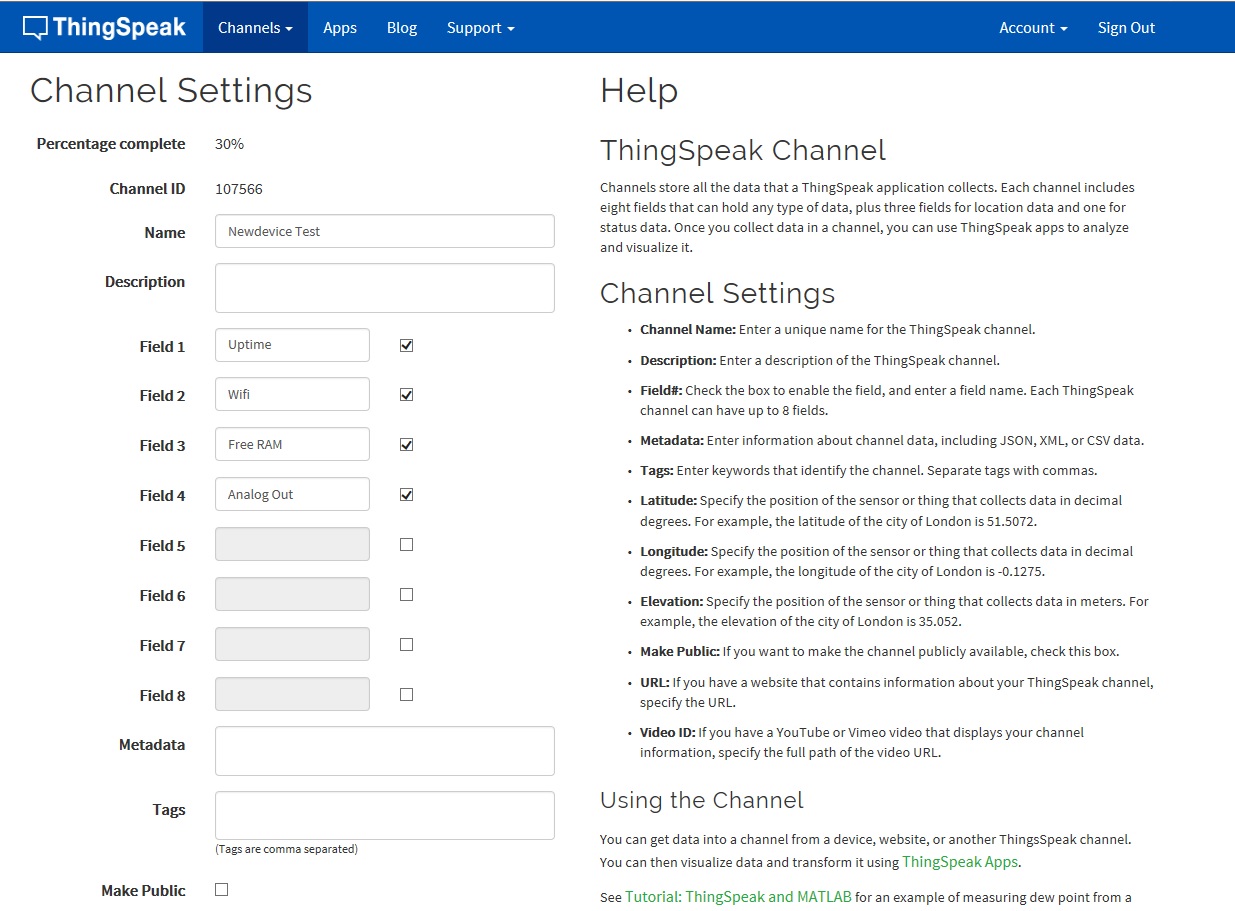

In ThingSpeak, you set up your channels as Field 1, Field 2, etc. You can add a name for each field, but the magic is the field number. You need to put the Field Number as the IDX/Variable for each device you want to chart.
ThingSpeak Configuration
Thingspeak Configuration.jpg (243.73 KiB) Viewed 18825 times
