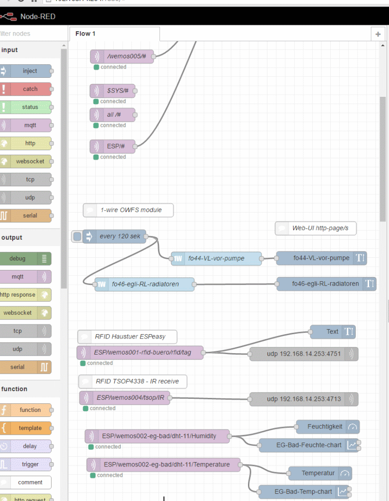

Re: MQTT to Relay with Node-Red
Here is a visual of the Node-Red nodes and flow to construct the UI. I also have more pages on it, to report the costs of warm water, then I ping the ESP's every 5min to check if they are alive, then write this into the MySQL if not alive, so when I do analytics, I know when not to trust the data.
What do you think?
What do you think?

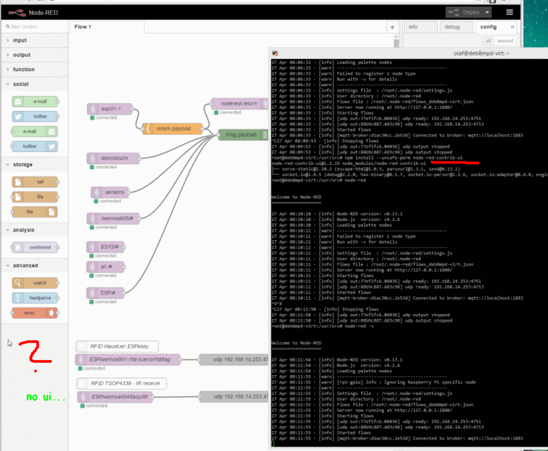

i am on debian 8,
installed the node-red-UI, but it dont show up...
anybody with a hint for me ?
(google has not that much, mostly working or raspberry...)
Did you remember to first change directory to the node red dir before issuing the command to get and install?
cd ~/.node-red
Only then issue the command : npm install node-red-xxxx (applicable package name)
cd ~/.node-red
hey thanks,
now working.
it was annoying, that i am a noob at so many things,
so i dived deeper into testing/googling and found, that the
installs node.js modules in the local dir....
cannot remember how i installed node-red, so i cannot remember why my modules are installed at
/usr/lib/node_modules
but as i found the node-red-contrib-ui directory in the local /root/directory,
i copied it to /usr/lib/node_modules and it is working..
dont know if i have to do more about that, but its running...
edit2: i searched my brain, how i installed this, and now think i must have done it like the doku said:
https://nodejs.org/en/download/package- ... tributions
so that i am not aware about the path...
maybe i had to install the ui with something like -global or the like.. dont know...

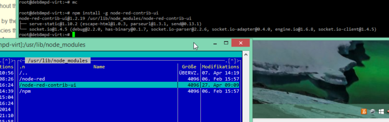

https://openenergymonitor.org/emon/node/12437 check this RaspberryPi image, emonCMS, Jessie Lite, Node-Red & openHAB. It's booting pretty quick.
that was it, install as global, -g
i investigated the install of node-red, and as the wiki/doku said, i installed it as -global
http://nodered.org/docs/getting-started/installation
so i had to intall the UI with the same global-flag "-g" to have it at the right place..
i want to thank you for the inspiration with the web-ui in node-red.
i also install the 1-wire owfs module, and have all temp-values from my other server..
fantastic...
fantastic...
- Zwischenablage13.png (93.67 KiB) Viewed 39196 times

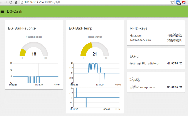

+1 ! Looks like you have done a lot today! Could you show us a screen shot of the UI?
node-red-ui component builds the ui itself,
cannot manually control html-elements. so it looks:
- Zwischenablage16-3.png (62.8 KiB) Viewed 39188 times

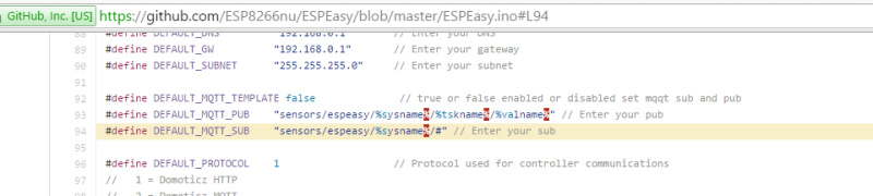

thanks for proof...
i saw this by accident, thought it would work the way you described, but was not sure.
in some discussions, the dev stated nothing special to develop this way,
but, hey: great! it works!
https://github.com/ESP8266nu/ESPEasy/bl ... sy.ino#L94 (or does it has nothing to do with your findings..
- Zwischenablage01.png (55.69 KiB) Viewed 39125 times

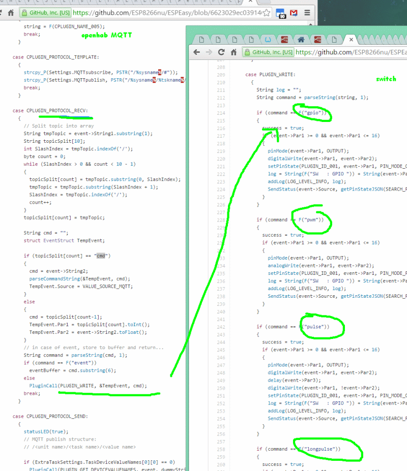

i dont know, if i am on the right track (
but if you really can switch the GPIO with MQTT, than the other commands "could" work also?
i am a computerlanguage i-literate, but it this works, maybe it should be documented in the wiki?
maybe new with version r1xx?
- Zwischenablage07-3.png (104.66 KiB) Viewed 39095 times

crsherman, I see you say you are also interested in the UI tool I used on NodeRed, not much to it, check out this node:
http://flows.nodered.org/node/node-red-contrib-ui. Once loaded & wired-up, you fire it up on mobile browser on your home wireless with: http://localhost:1880/ui
On my blog I briefly show the interface I have built, will write more what I have learnt of the family using it in future, and progress on it, see image of an earlier version here:

No, the substibe template setting is on Advanced tab on EspEasy, I will oost a pic tonight if you are not finding it
