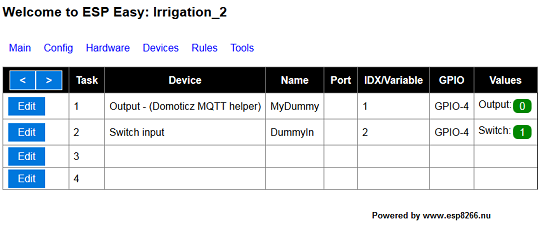

It works but also needs another gpio (4) operated by MQTT in order to generate an event (the switch input) to start the rule.
If I use the gpio the solenoid is connected to (2) it gets very confused. So here is the setup:
Rules:
On DummyIn#Switch=1 do
timerSet,1,1
gpio,2,1
On DummyIn#Switch=0 do
pwm,2,0
On Rules#Timer=1 do
pwm,2,512
