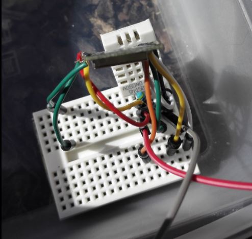

7 days my easyesp deep sleep dht22 run with r20.
Internal clock is not a swiss one, but job is done very well.
I can says it's works !
Thanks Martinus !
Next step, add luxsensor ans soilmoisture sensor to monitor my tomato.
