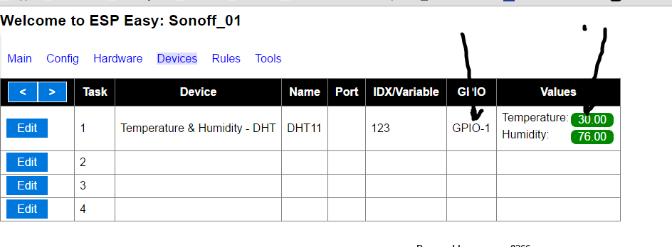

Sonoff with DHT11
can read Temperature & Humidity
to control Sonoff Relay.

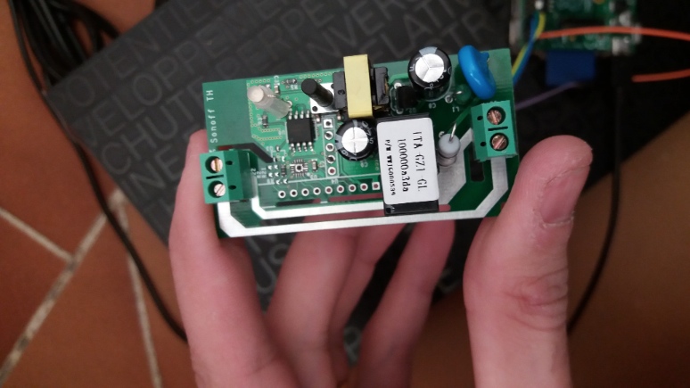

Hi guys !
Thank you for your reply !
First of all there is my photo of the sonoff with 5 pins
But secondly : I can't fly my module with ESPEasy
- I use esptool
- I want to use this firmware : ESPEasy_R78_1024.bin
I got this error :
Connecting...
Erasing flash...
A fatal error occurred: Invalid head of packet
Any idea ?
Is there a way to put the module in firmware update mode ?
- I use esptool
I got this error :
Connecting...
Erasing flash...
Any idea ?

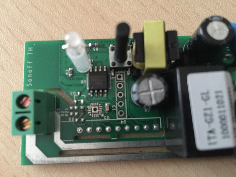

I also have this 5pin sonoff device (arrived today) .SuperToma wrote:Hi guys !
First of all there is my photo of the sonoff with 5 pins![]()
But secondly : I can't fly my module with ESPEasy![]()
- I use esptool
I got this error :
Connecting...
Erasing flash...
Any idea ?
Try to flash it using the flashtool (R78) , but can't get it working.
I als changed the FTDI adapter, but
trying to connect
flush start
setting serial port timeouts to 1 ms
setting serial port timeouts to 1000 ms
flush complete
espcomm_send_command: sending command header
espcomm_send_command: sending command payload
read 0, requested 1
warning: espcomm_sync failed
error: espcomm_open failed
Press any key to continue . . .
What did i do wrong ?

Re: New ESP gadget
I only have experience with the 4_pin sonoff, but from the documentation i cannot see any difference in the schematics of the 4_pin or 5_pin Sonoff module, (except for that one extra pin), so the procedure to flash it should be the same I think.
Disconnect power
connect your FTDI USB/Serial interface which is set to 3.3 volt.
then while the power is still disconnected push the black button on the sonoff and while keeping it pressed connect the FTDI to the USB port so the Sonoff gets powered.
This shoul force the ESP/Sonoff into flashmode.
Now you can program it with the Arduino IDE or a flash program.
edit:
advisable settings in the arduino IDE:
Board: generic ESP8266 module
Flash Mode: QIO
Flash Frequency: 40MHz
Upload using: Serial
CPU frequency: 80MHz
Flash Size: 1M (64k SPIFFS)
Reset method: ck
Upload speed: 115200
Disconnect power

I ordered 2 of the new 5pin-Versions, flashed them both without any problems
I used a cheap 3.3V-Adapter, directly connected, incl. power supply
I connectected GND, RXD and TXD, then hold the button, plug 3.3V, release button

finally got it working ! U used the shorting solution : http://tech.scargill.net/more-sonoff/costo wrote:There is no rule what color when flickers, depends how the manufacturer connects , if any, leds to the chip.the cosmic gate wrote: Could somebody tell me what way the LED would flicker ?
Getting this differnt way's : fast flickering / normal flickering / stable red
Usually during upload/flashing one led (often a blue one) is flickering very fast which means uploading is busy.
The Sonoff does not have a led that signals a status but the USB/Serial converter shows fast flickering for a while (20-30 seconds) when uploading takes place.
When uploading failes the same led will flicker but just for a short while (1 second or so)
is there anyone who can tell the GPIO for the LED on the sonoff ? (in the 103 software you can set the GPIO for WiFi , so would be nice when the LED on the sonoff can be used for it)
Re: New ESP gadget
Hi Cosmic Gate,the cosmic gate wrote: finally got it working ! U used the shorting solution : http://tech.scargill.net/more-sonoff/
Can you explain your method for flashing your 5 pins module.
You shorten the points with a cable and took it off before flashing ?
Which version of Esptool and ESPEasy have you used ?
Regards.

OK, I got through step 1 (soldered a 4-pin male header). And found out that the inner pin is vcc, outer pin is gnd.
The two pins in between must be TXD/RXD, not sure which is which.
I connected these four to a serial adapter to USB, but the unit comes up in Windows device manager with a warning triangle: device cannot start (code 10).
Also shows "A device which does not exist was specified" /
Tried to swap the TXD/RXD leads, no change.
What am I doing wrong?

Just received the second Sonoff. This one has 5 holes for the serial header, not 4.
Modification and flashing was easy. But when I measured the V on the output, I noticed that even when the relay is switched off, there is still some 14 or 15V remaining.
Is this a problem, or should I ignore?

Hi guys.
thanks for this thread, as it has been a great source of information.
I have one question though. Just received my new Sonoff and it is the 5 pin one.
Can anyone share the pinout for flashing? I have mu FTDI programmer set to 3.3V and presume that the square pin is 3.3V as in the 4 pin ver.
If anyone can point me in the right direction it would be greatly appreciated. Thanks in advance! Peter Scargill's blog has the 4 pin one only too...
Also, has anyone flashed ESP Easy onto the Slampher yet?
