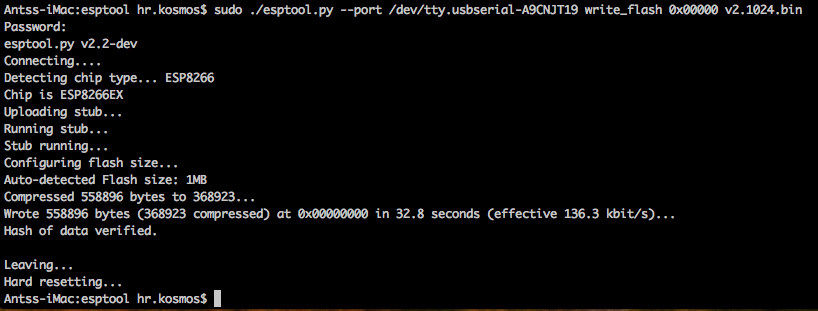

I bought month ago Sonoff wifi switches. I do not flash these first time but with these ...i do not know what. Esp chip is 8266. Flashing goes norm but after reboot i do not see ESP_0 wifi. I use Os X and esptool. What and how i need ? I try ESPEasy_v2.0.0-dev11_normal_1024.bin and after this R120 512 and 1024. Not works.
- Screen Shot 2018-01-25 at 21.21.34.png (58 KiB) Viewed 20817 times

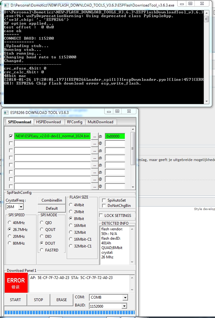

i also bought a SONOFF basic , but i cannot flash i with this tool
![Image]()
what am i doing wrong ???
- error programmer.jpg (332.68 KiB) Viewed 20788 times

I do not know it is working but i flash it with image for 8285. Working. I use os x and esptool. I do not have no one comp with windows.
