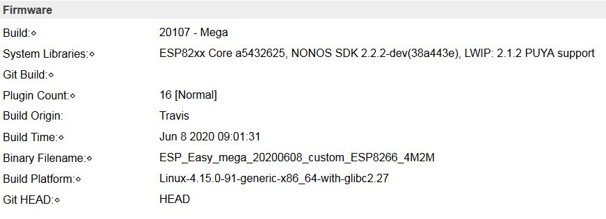

Here the current state of the devices storage:
Firmware:

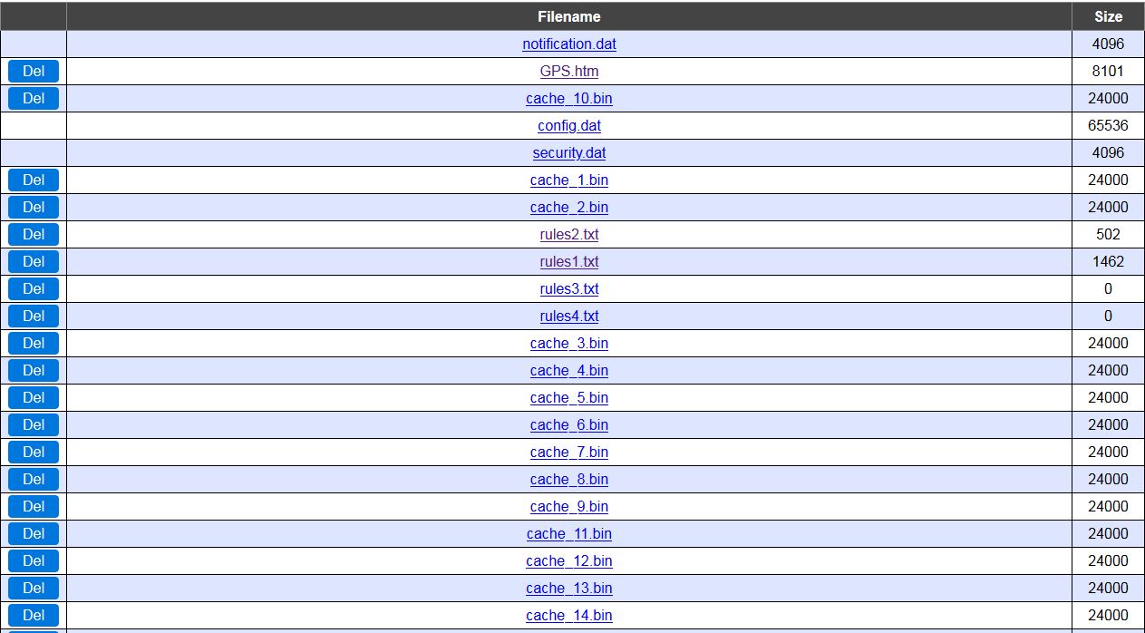

And a snippet of the file browser:
Just for documentation purpose....

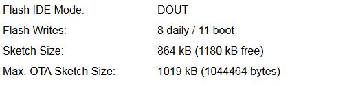

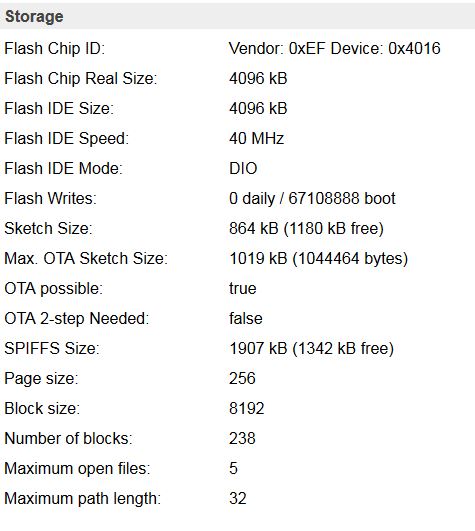

Interesting is the number of flash writes.

The cache controller writes are not counted to the flash writes as it would otherwise easily hit the 100 writes a day and lock the option to change settings or write to the cache controller.
But the number of boots is rather high.
Even if we take into account it could reboot a few times a second, then it has not been built long enough ago to get to that boot count.
