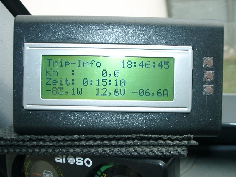

I started a project to replace my 16 years old self built onboard "computer" of my motorhome (I was / am using a Tiny Tiger) by something little bit more modern.

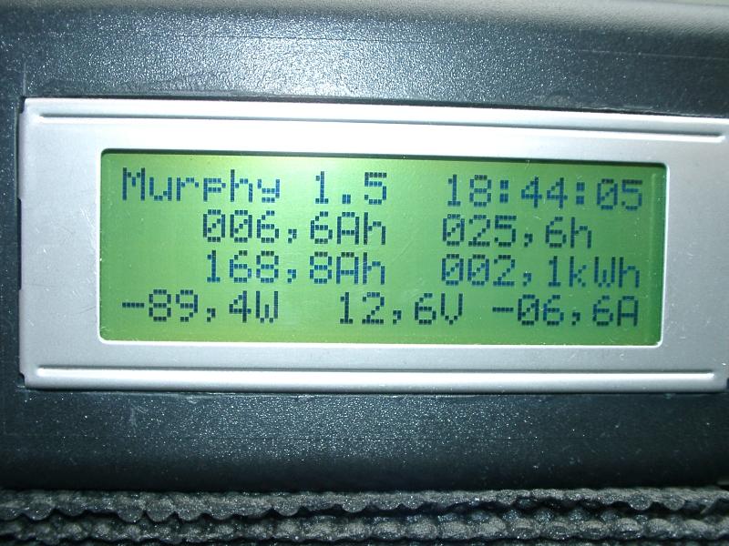

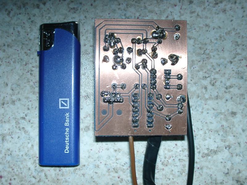

Some pictures of the old electronics, self-soldered, the battery sensor self designed and built on selfmade pcb board, read using AD, an old modified USB GPS mouse attached to serial port, huge amount of spaces used, bunch of cables through the whole motorhome. But it worked through the past 15 years reliably without any changes except the addition of two NTC resistors to get and display inside/outside temperatures (not to be seen on the old pictures I took 16 years ago, sorry), the data are downloadable using a serial cable to the laptop.
In this current project which I name ESPEasy-RV I want to collect all data of my motorhome I could get, i.e. level of water tank, level of LPG tank, battery states, solar panel energy production, levelling of the vehicle itself, track trips, display time and ambient data, aso. The amount of sensors needed took me to the decision to realize it using ESPEasy. This will reduce the weight of the motorhome by a ton of copper cables, increase the amount of data collectable, give much more precise readings. And last but not least, it will increase the WAF of my doing as already happened with my installations in my house/living room.

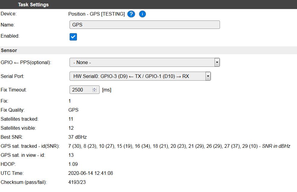

Equipment currently used: Huawei mobile 4G Hotspot, three Wemos D1, one for the GPS sensor, one for a MPU6050 gyro and a BMP280, one for a 4.3" Nextion display.
The first steps are done, I will not post the hardware itself at this time, is currently not presentable. But some results already appear on the Nextion display.

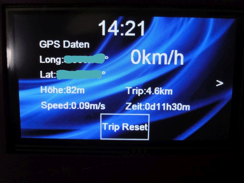

Here the very first pictures of the display, much more data and pages to come:
Using a MPU6050 I am finally able to level the motorhome form drivers seat by moving the vehicle and / or alter the pressure in the air suspension. Has been in the past sometimes really painful to get the vehicle correctly levelled:

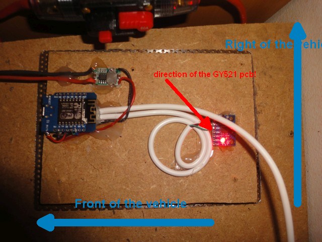

The iron plate is fixed with hot glue onto a flat, almost horizontal surface in the underbed compartment at the farest end of the vehicle. Tipp: before applying the glue, heat up the surface and the iron plate a little bit (ofcourse taking into account the heat resistance of the surface!!), you will get better and more durable results:
The four magnets are screwed to the plate:
And the plate holding the hot glued pcbs will be in place fixed and horizontal:
On the left Wemos D1, top mini step down voltage regulator, right GY521 / MPU6050 sensor - and enough space for more sensors to come.
In the next step I will post my rules calculating a (for me) understandable tilt and explain, how to get them onto the Nextion.

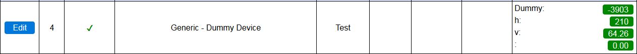

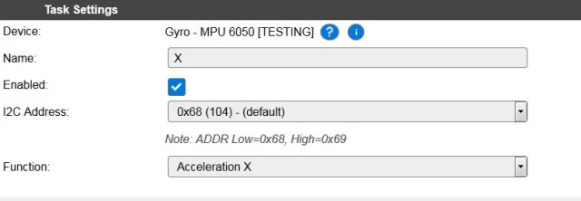

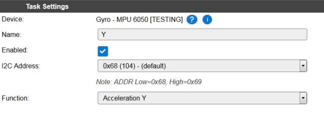

Step 2: Putting the readings of the Gyro to Nextion.
At first I am creating two tasks, every needed axis gets one:
Additionally I am creating a dummy device to be able to calculate averages and a dummy device to be able to switch on / off sending the data to Nextion manually. I did this to minimize Wifi traffic during the times the levelling is not needed.
Switching measurement On / Off (resp. sending the data):
Hitting the button "Messung" on the Nextion display (refer picture post #2 in this thread) sends an idx of 100 from Nextion to its attached ESPEasy device and this will fire an event on the device with Gyro attached:

On task-triggered events I generate a little bit of averaging to minimize influence of whatever, i.e. egine vibrations and write the results directly on the Nextion screen.
On X#X Do
  let 4,%v3%
  let 3,%v2%
  let 2,%v1%
  let 1,[X#X]
  TaskValueSet 3,1,(%v1%+%v2%+%v3%+%v4%)/4000*5.625+0.7     //bringing the raw data in somewhat useful format for my eyes and calibrating zero (^= +0.7)
  let 8,([XY#X]*10)+100        //adopting to the middle of the slider in Nextion (°=100)
  If [Auto#Messung]=1         //doublecheck, if sending data is not initiated by the task schedule itself
  SendTo 28,'Di,page0.h1.val=[int#8]'
  SendTo 28,'Di,page0.t1.txt="Tilt_längs:[XY#X]"'
  EndIf
EndOn
On Y#Y Do
  let 12,%v11%
  let 11,%v10%
  let 10,%v9%
  let 9,[Y#Y]
  TaskValueSet 3,2,(%v9%+%v10%+%v11%+%v12%)/4000*5.625-0.4     //bringing the raw data in somewhat useful format for my eyes and calibrating zero (^= -0.4)
  let 16,([XY#Y]*-10)+100        //adopting to the middle of the slider in Nextion (°=100)
    SendTo 28,'Di,page0.h0.val=[int#16]'
    SendTo 28,'Di,page0.t0.txt="Tilt_quer:[XY#Y]"'
  EndIf
EndOn

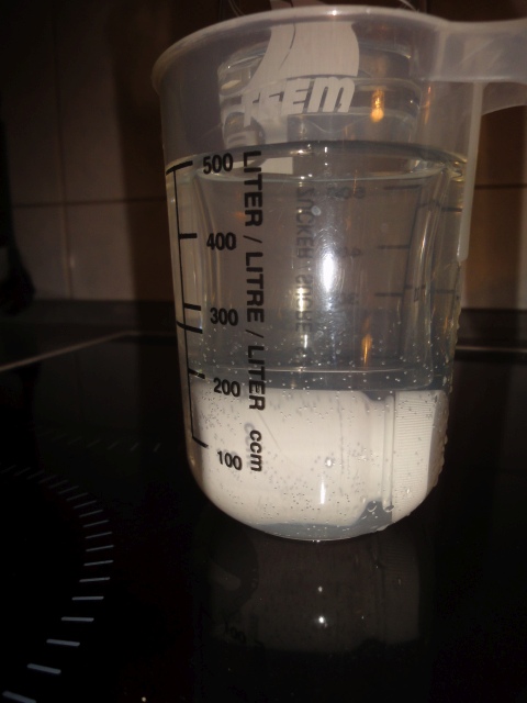

My stupid idea to save money by using a pill bottle for my floater made the highest efforts to get it waterproof. But nevertheless, I show you, which stupidity I did.
My first waterproofing test I did with the unmodified bottle by submerging it for ~5 hours:
Surprisingly the sealing of the cap was originally made of paper (!), which let the water through after a while. So I replaced it ny cutting out a sealing out of an old bycicle tube. Second submerge test was successful.

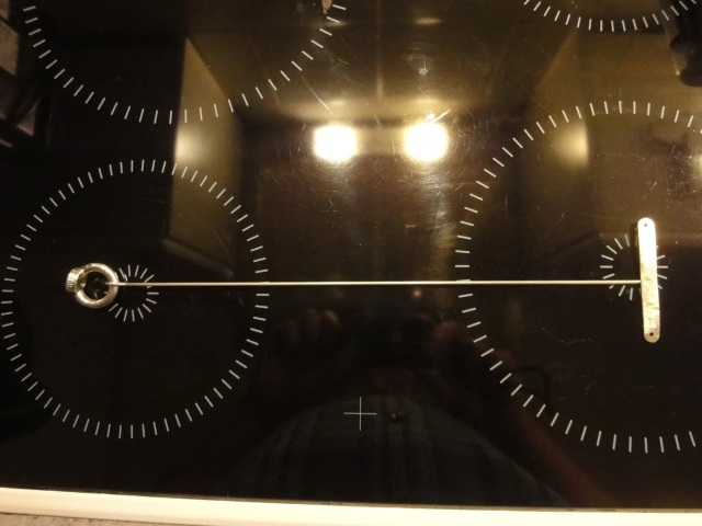

I produced an arm for my floater made of stainless steel parts:
And did a floating test, which was really promising that it will work:
And at last I added a cable to my pill bottle, made another sumerging test with it, this time in a depth of 0.5m, which should be enough, which it passed.
Next step will be the placing of sensor and cables. Due to the fact that the submerging tests and the modifying of the pill bottle took so much time, for me is not left enough day today to continue now. So stay tuned....

Thank you, but my first floater tests are surprisingly good. In a 15 l bowl today I was able to estimate the water level in a range of 1cm. For a motorhome user thats a spot landing. Never forget:We are talking about a vehicle, which is constantly in movement, at least by the movement of persons inside of it, except you have a luxury one which is levelled and fixed by hydraulic aids.
Believe me, a floater is a good and reasonable solution. And if you still have any doubts: why, do you hink, the gasoline tank of your car still is equipped with a floating sensor to give you an idea, when to approach a gasoline station?

OK, next step is done.

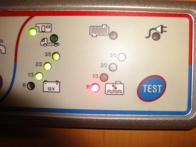

This "thing" went inside my freshwater tank after being - more or less accurate - calibrated last night by using a bowl and some liters of water:
Now its inside of the tank and I will show you, why I did these efforts (despite the fact that with some more research probably it could have been easier). The next picture shows the reading of the onboard water level info:
Its says, the tank is almost empty and at this moment - if I should trust the LEDs - it would be risky to take a shower. But I filled the tank already with 45 liters of water - almost the half of its volume of 100 liters. The reading of my floater/sensor combination tells me:
The difference to the amount of water I filled into the tank is easy to explain: its the weight of the floater. So the weight eats up some 7-9l of water before the floater begins to float. At least this is acceptable, the gasolin gauge in your car behaves the same way.
Lets leave the handcraft part and return to ESPEasy. The device is configured:
And a dummy device for storing values neede for calculation:
The way the end of the floater rises is a direct linear function to the read acceleration of the sensor. So the height of the floater above the tanks bottom can be calculated directly by the factor length floater/16384 (max reading of the MPU6050 +/- direction). Depending on the floater angle in relation to the surface of the water (optimum would be a ball, my floater is a cylinder) the factor varies a little bit over the height, I took an estimated average of this factor. To minimize the influence of water movement I am averaging the raw readings to the maximum I can using ESPEasy, might be possible to reduce it.
On X#X Do
  let 15, %v14%
  let 14,%v13%
  let 13,%v12%
  let 12,%v11%
  let 11,%v10%
  let 10,%v9%
  let 9,%v8%
  let 8,%v7%
  let 7,%v6%
  let 6,%v5%
  let 5,%v4%
  let 4,%v3%
  let 3,%v2%
  let 2,%v1%
  let 1,[X#X]
let 16,(%v1%+%v2%+%v3%+%v4%+%v5%+%v6%+%v7%+%v8%+%v9%+%v10%+%v11%+%v12%+%v13%+%v14%+%v15%)/15 //averaging
TaskValueSet,4,1,%v16%
let 16,292-[test#dummy]*-0.021 // 292 = lenght of the floater minus height of mounting point, 0.021 = tan-constant calculated from max to actual accreleration
taskvalueset,4,2,%v16%
let 16,[int#16]*450*680/1000000  // depending on the size of the tank calculation of volume
TaskValueSet,4,3,%v16%
SendTo 28,'Di,page3.t2.txt="Stand:[int#16]l"'   //and send the whole stuff to the Nextion device
SendTo 28,'Di,page3.j0.val=[int#16]'
SendTo 28,'Di,page3.t3.txt="[Temp#C]°C"'
SendTo 28,'Di,page3.t4.txt="[Temp#H]%"'
SendTo 28,'Di,page3.t5.txt="[Temp#P]hPa"'
EndOn
...and again, thats all. I got a perfect information of my oboard water. Only thing is: up to now, the vehicle itself wasn't moved. Wether my design is standing the rough environment of a moving home the future wil tell me. Thanks to ESPEasy, its mighty sensor connection posibilities in combination with rules.
In this case, handcrafts took around two days, attaching and configuring the sensors, adding the rules was done almost in minutes.

1. the readings of the water level has - between ~8l and 95l - an accuracy of 1 liter, in a tank of 32 cm of height
2. the levelling system I described before is that sensible, that it told me after filling 50 liters of water into the tank (this is placed in the left side of the vehicle), that the vehicle should be levelled once again - and the RV itself has a gross weight of almost 3.000 kg.

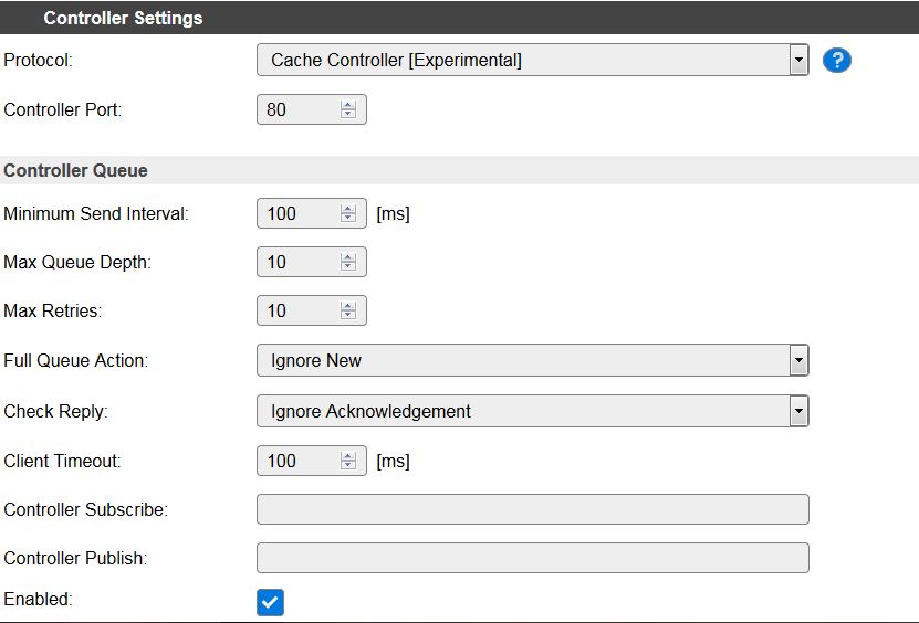

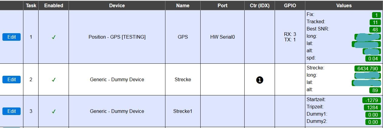

OK, here we go, next step of my tiny project: Trip recorder.
You need:
- a GPS device, mine is a Neo6M, others are supported, too. I tok the Neo6M because I ave positive experiences in other automotive projects. Supported devices are documented in the ESPEasy readthedocs
- a Wemos D1
- another Wemos D1 and the Nextio display
- In my case ESP_Easy_mega_20200608_custom_ESP8266_4M2M.bin to get the cache controller and some more space to store data

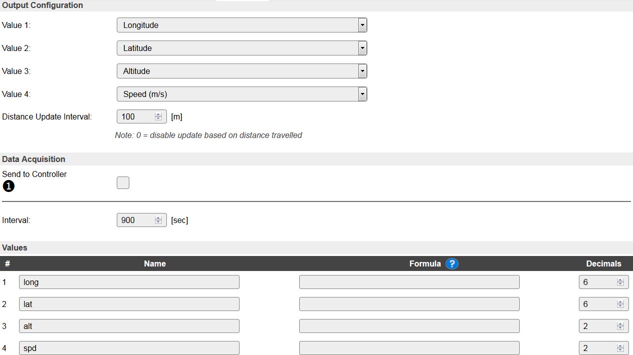

On the road I get the current GPS readings including some calculated values:
The fields names are self explaining.
Using the last custom build
ESPEasy gives me the experimental cache controller which is able to write some data into the flash:
Defining some devices:
is the prerequisit for what I am doing now.
Since the last release the GPS plugin sends an event depending on the travelled distance including the calculated distance since last event. I take this value to add it to the total distance travelled, write it into the dummy device and send the values to the cache controller which writes it into the flash:
On GPS#travelled Do
  if %eventvalue%<500   //just make sure there's no misreading of the GPS sensor
  let 1,[Strecke#Strecke]+%eventvalue%  //adding the distance
  TaskValueSet 2,1,%v1%  //setting dummy values
  TaskValueSet 2,2,[GPS#lat]
  TaskValueSet 2,3,[GPS#long]
  TaskValueSet 2,4,[GPS#alt]
  TaskRun 2  //run the task to write the data into the flash using the cache controller
  let 1,[GPS#spd]*3.6   /calculating speed in km/h
  SendTo 28,'Di,page2.t7.txt="[int#1]km/h"'
  SendTo 28,'Di,page2.t1.txt="Long:[GPS#long]°"'
  SendTo 28,'Di,page2.t2.txt="Lat:[GPS#lat]°"'
  let 1,[GPS#alt]
  SendTo 28,'Di,page2.t3.txt="Höhe:[int#1]m"'
  SendTo 28,'Di,page2.t4.txt="Speed:[GPS#spd]m/s"'
  let 1,[Strecke#Strecke]/1000
  SendTo 28,'Di,page2.t5.txt="Trip:%v1%km"'   //displaying the total distance since last trip reset
  EndIf
EndOn
Hitting the "Trip Reset" button on the display generates an event on the device to reset trip time as well as trip distance:
On TripReset Do
  SendTo 28,'Di,page2.t5.txt="Trip:0.0km"'
  SendTo 28,'Di,page2.t7.txt="0km/h"'
  TaskValueSet 2,1,0
  TaskValueSet 3,1,%uptime%
  TaskValueSet 3,2,0
  SendTo 28,'Di,page2.t6.txt="Zeit:%c_m2dhm%([Strecke1#Tripzeit])"'
  TaskRun 2
EndOn
For calculating the trip time since last trip reset I am using the uptime of the device, calculating the difference betwen starttime and current uptime, writing it into the dummy variable and send it every minute to the Nextion display:
On Clock#Time=All,**:** Do
  SendTo 28,'Di,page1.t10.txt="%systm_hm%"'  //sending the GPS-depending time to the zime fields of the various Nextion pages
  SendTo 28,'Di,page2.t10.txt="%systm_hm%"'
  SendTo 28,'Di,page3.t1.txt="%systm_hm%"'
  let 1,%uptime%-[Strecke1#Startzeit]  // calculating the trip time
  TaskValueSet 3,2,%v1%  //setting the dummy value
  SendTo 28,'Di,page2.t6.txt="Zeit:%c_m2dhm%([Strecke1#Tripzeit])"'  //and sending it to Nextion display
EndOn
Some more lines of code make the life easier. Because I am working with testing and experimental parts of ESPEasy some reboot are most likely. The values of the dummy devices will survive a reboot, but the uptime will be reset to zero. So I want to assure the surviving of the trip time:
On System#Boot Do
//Warmstart überleben Tripzeit
  let 1,0-[Strecke1#Tripzeit]
  TaskValueSet 3,1,%v1%
  TaskValueSet 3,2,0
EndOn
The Nextion will not run 24/7 so it is useful to inform the GPS device that the Nextion display has been started. On System#Boot the Nextion device generates an event on the GPS device which will send the currrent display data:
On NextionInit Do
  let 1,[GPS#spd]*3.6
  let 1,[GPS#alt]
EndOn

Using the cache controller and the html-code I get a semicolon seperated .csv file which - with a little bit of work - I can convert them to a .gpx format using GPSBabel.
At first I have to cleanup the data extracted from the devices flash using the html-code of @TD-er, I am doing this using Excel. You have to assure, that the excel-produced "," inside the exported .csv have are converted to ".". I am doing this currently simply using wordpad. Works. Up to now I was concentrated purely on the geodata Latitude and Longitude, much more is possible. Out of the .csv file I build a tab-delimited file with a header setting, structure looks like this:
No	Latitude	Longitude
0	xx.xxxxxxx	y.yyyyyyyyy
This structure can be imported by GPSBabel using the universal csv format:

Taking the produced .gpx file onto the page https://www.bernhard-gaul.de/gpxviewer/gpxviewer.php you will get as a result your travelled road track:
I did remove the underlaying map, but if you do it by yourself, you will have a wonderful mapview of your travel.
The map with the track on it clarifies, why the traced distance using GSP plugin will never be able to get the 100% accurate reading. Corners are looking like this:
Thats because the distance is calculated between the current and the last geo position. This calculation will be a straight line, so the corners are partially cut. But the total difference for me personally is absolute neglectible. E.g. on a trip of around 30km the odomoter reading of the car differed less than 100m to the reading of the trip counter. The readings of my system will be more accurate in the future, because with the latest release I get the calculated distance pretty accurate. So I will reduce the "Distance Update Interval" to somewhat like 25 or 30m. We will see.
Summed up: the whole system is built up with a handful lines of code in the rules. Thats all, Thanks to ESPEasy, its mighty sensor connection and the underlaying code of the developers.

To get a clear starting point of my travel I have added four lines to the rule for Tripreset on the GPS device, modified the original post, too:
On TripReset Do
  TaskValueSet 2,1,0
  TaskValueSet 3,2,0
  TaskRun 2
EndOn

#32 Post by TD-er » 15 Jun 2020, 13:25
Since we're checking the distance on every position update anyway, I could keep track of it in a counter.
This way you could get an accuracy based on updates roughly 3 times a second.
But I think this may also introduce an error which will be reporting a longer distance then actually traveled as you may then measure a saw-tooth pattern with HDOP as some sort of amplitude.
For slow speed movements this may attribute to quite some error.

#33 Post by Wiki » 15 Jun 2020, 14:16
Well, I think lowering the update interval may help. In the past, using my old system, I made the experience that constantly counting leads to differences, too. Calculating the distance as it is now implemented makes imho more sense, because its a kind of averaging and reduces errors due to time shifts which take place in the GPS system itself, highly depending on the quality of used hardware. Take a good chip like the Neo 6M and put a bad antenna on it - results will be quite suprising.
Today I have to be on the road anyway and I redu ed the update interval to (I think) 40 m. I will report.

#35 Post by Wiki » 15 Jun 2020, 17:35
OK, trip done.
Google maps calculation: 15.8km, odometer reading: 15.4km, trip recorder: 15.79km. Trip profile: 10% in village, 90% highway / overland. Difference odometer reading <-> trip recorder/google -2.5%
My app Eco biker completly useless, recorded 3.4km overall. Surprise: the GPS-mouse of my old system has exhaled today the holy breath of electronics and quitted working after 15 years - what a mess concerning the old system but how lucky am I that I did setup the new system ontime. Gotcha!
The distance update interval I had set to 50m. The track on a map looks like this:
You can see, the track is much closer to the (edged,too) map drawing.
Failure discussion:
- The distance reading of the ESPEasy trip recorder works pretty well.
- This time the odometer was wrong. Explanation could be: The high amount of highway influences the odometer reading because the tyre diameter rises with higher speed and thus counts less distance.
I added time and altitude information to the modified file for GPSBabel and - what a surprise, uploading it to the GPX-Viewer I get a whole profile of the trip:
Isn't it nice?

Trip reading of vehicles odometer: 234.2 km - aha
Total reading of ESPEasy-RV tripcounter: 238.87 km - perfect
Speed readings of ESPEasy-RV : The whole trip the app Google Maps and the tripcounter of ESPEasy-RV where in perfect synchronization, now and then 1km/h difference, but the other device always reported some seconds later the same value - perfect
@TD-er: you have done an absolute perfect work in an unbeatable time - Thank you, I'll buy you a beer
Levelling the vehicle using ESPEasy-RV levelling meter: Took around 60 secs. to get the RV in perfect level by moving forward/backward and at least lowering the pressure of the air suspension on one side a little bit - perfect
ESPEasy-RV water tank levelmeter: During the whole trip in movement reported values +/- 5l of the real amount of water, from the moment of parking and switching off the engine took 60 secs. to deliver the correct reading - perfect
And: all the informations concentrated on just one display, just a fingertip away, no walking through the RV to get the desired informations.
@Wiki: you have done an unbelievable job, just have a beer now!
