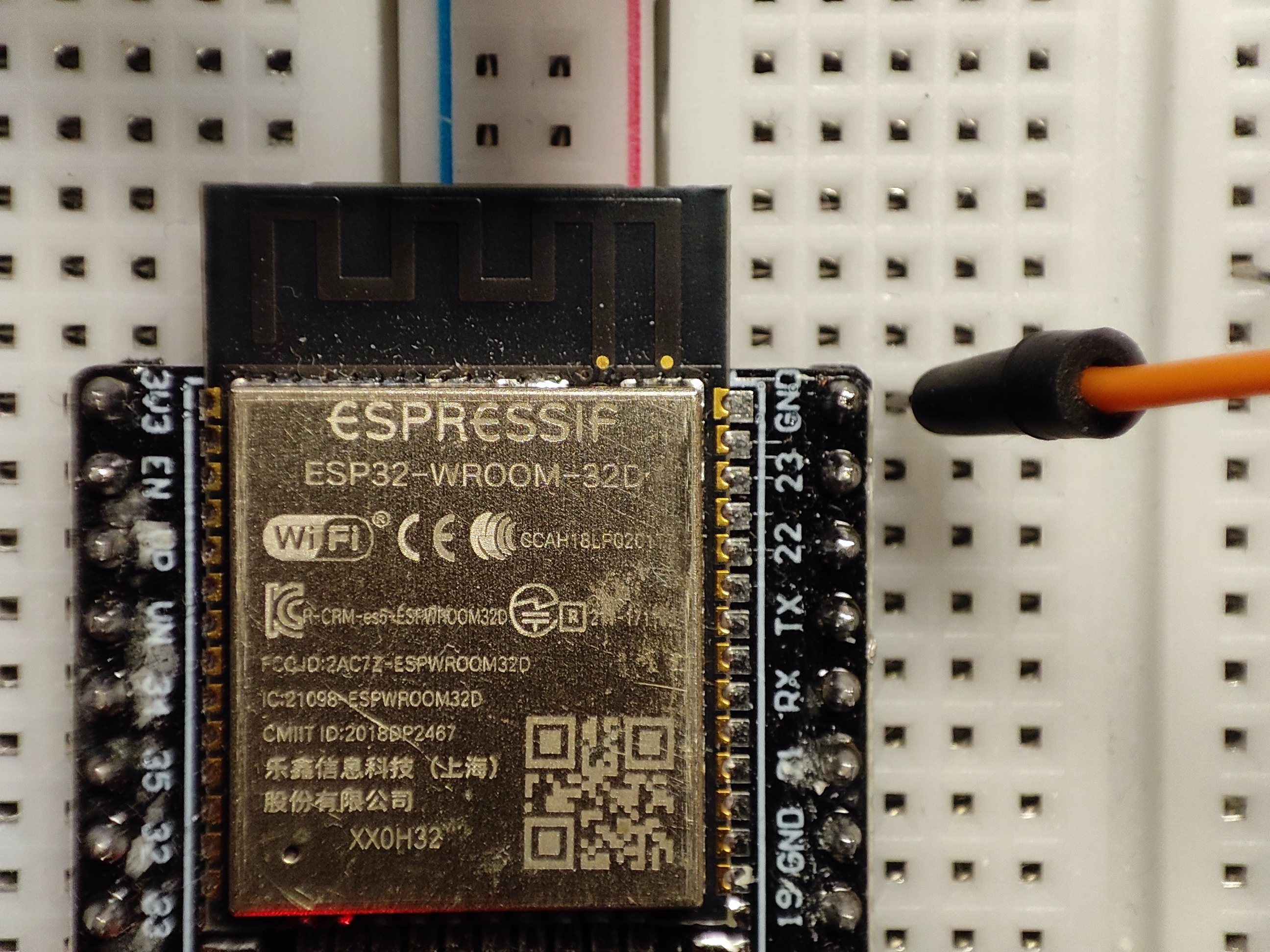

Which board do you have?

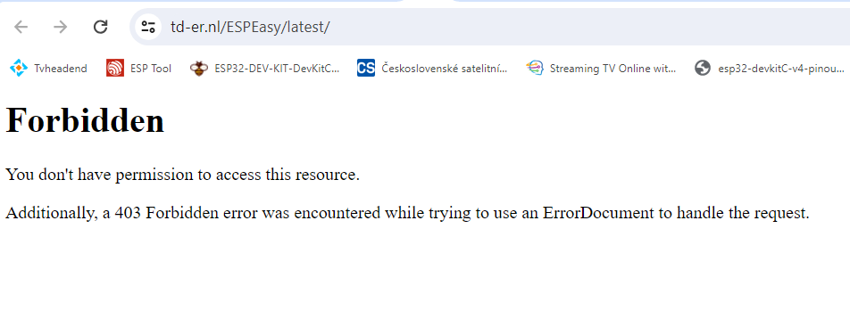

Unfortunately, I can't get to the mentioned www page...

Ah can you send me your public IP-address via a direct message?
Seems like you're in my very extensive IP-block. (I get a lot of hack attempts to my server)
Re: I can't program ESP32 sw:"ESPEasy_mega_20240229_ESP32_binaries"
I removed your IP range from the block list

I had to connect GPIO0 to GND, otherwise I didn't want to connect to the programmer, the software was uploaded and a message appeared saying that it was OK.
Unfortunately, I don't see any new network in the WiFi manager!
It's like it won't run on the ESP32 AP function.

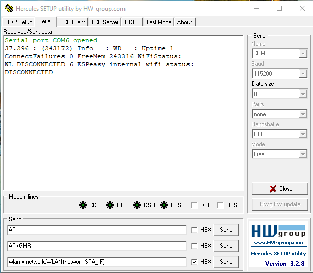

after "uploading" the software, I canceled the connection between GND and GPO0.
- RS232_01.png (27.53 KiB) Viewed 9258 times
This is the rs232 dump after disconnecting GND and GPIO0.
I don't understand why I can't upload "ESPmega", when I use the online programmer, it uploads both TASMOTU and ESPhome (https://web.esphome.io/)....
This is the dump from the ESP32 after pressing the EN button.
You should be able to see the ESPEasy accesspoint from your phone, tablet or wifi-equiped computer, when scanning for networks. If not, you can send a few commands to the unit via the terminal program you used, above, these commands should be:
You can enter these 3 commands, 1 by 1, in one of the input fields, make sure Hex is un-checked, and click the Send button.
That will trigger a rescan of the Wifi APs, and try to connect to the AP you specified.
Once connected, the log will report the ip-address the unit received from your AP, and you can then access the ESPEasy web-UI from your webbrowser, using that (http) address.
wifissid,TheNameOfYourWifiAP
wifikey,TheSecretP@$$w0rdOfYourWifiAP
save
Is it not possible to enter the network name and password via AT commands?

Nope, it is just the serial console of ESPEasy.
You can also open a console window via my web flasher tool if you don't have a proper terminal program on your PC.

Ah, I just downloaded that Hercules tool, but this silly tool doesn't send an enter after a command, and also doesn't seem to have an option to do that, so it's rather useless
As TD-er suggested, please use the web-flasher at https://td-er.nl/ESPEasy/latest from a Chrome or Edge browser (other browsers don't have the required serial-support built in).
There you can select the build you would want to install, but as you already have that arranged, it's not needed to re-flash, unless you would want to clear the device and re-flash. Different builds, using the same Flash layout (4M316k-SPIFFS) can be uploaded via the Web UI after downloading to your computer.
When switching flash layout (not much choice for 4MB ESP32s) or filesystem (LittleFS vs SPIFFS), reconfiguration is needed, except for the WiFi settings, they are stored after the unit has been successfully logged into a WiFi network, and been active for a couple of minutes (5 AFAIR).
After pressing the big blue button, it will ask to select and connect to a detected serial port, and when connected present a menu that includes the LOGS & CONSOLE option. Click that to connect to your ESP, and then enter the commands I listed above, of course replacing your access point name and password.
This console does offer full editing features of the command before pressing Enter to send the command. As usual, the password is case-sensitive.
When using the Web flasher, that's automatic, and as he's showing the log of a running ESPEasy unit, that's a part of what succeeded already
Connecting the unit to WiFi seems to be the hard part, but as it's already been running ESPHome and Tasmota, without a full wipe, that's one of the situations you may end up with.
It's easily fixable, instructions are available, above, I initially assumed that the shown terminal software was usable, but it isn't.
The "Boot" button will connect GPIO-0 to GND, and "Reset" (often labeled "EN", like in the images you shared, above...), well, that should be quite obvious, resets the unit.
To get the unit into flash mode, 90% of the time that's taken care of by the flash tool, including the Web flasher, when starting the upload (often called download for some reason
The remaining 10% you have to press and hold the "Boot" button, press the "Reset" or "EN" button shortly (~0.5 sec), and after a few seconds (~20 just to be on the safe side) you release the "Boot" button. Then the unit has entered Flash-mode, and you can start the flash download process.
More importantly, as you already had ESPEasy installed and running on your ESP32, can you observe the log messages from the Web flasher "LOG & CONSOLE" screen?
If that is the case, you can enter the 3 commands I listed above (wifissid, etc.) to connect the unit to your WiFi network, and from that point on you should be able to configure the unit using a webbrowser, using the ip-address shown in the logs when connecting to the WiFi. If you missed that, you can request the currently used ip-address by typing the command "ip" (without the quotes) and press Enter from the console.
so finally I managed to set up a WIFI network with the help of PuTTY and those 3 commands.
Thank you all.
Thank you all.
