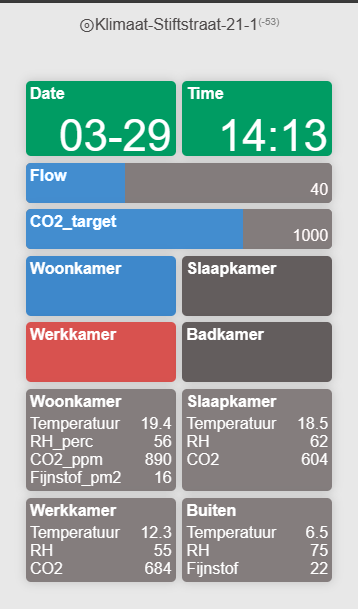

By a tile a mean a dummy task that's not a bigVal, Slider, pButtons, dButtons.
I assume that's the original definition from the author of EasyFetch.
In the picture below from top to bottom
- 1 dummy Task with 2 bigVal
- 1 dummy Task with 2 sliders
- 1 dummy Task with 4 pButtons
- 4 dummy Tasks with each 3 or 4 variables
so this would contain 4 tiles, giving 2 columns whish is correct.
but adding a 5 tile won't scale to 3 columns.

Stef2s wrote: 29 Mar 2024, 11:19 2. The number of Columns in the dashboard should become 3 if I've 5 or more tiles. I'm not sure what all counts to "Tiles", but for this test I've : 5 normal Tiles, 5 bigValues, 2 sliders and 4 pButtons and still I get only 2 columns, What am I doing wrong ?
First of all as i can see from your screenshot you are probably using a mobile phone. If not in landscape and your screen width is smaller than the number of columns times their width then there will be always the two column view.
Number of tiles in this context means all but slider and bigVal. So in your case there are 8 tiles. But as also stated in my suboptimal documentation, But as also stated in my suboptimal documentation, the number of big values in a dummy task (so maximum 4) equals the number of columns and has a higher priority than the number of "normal" tiles. So if you only have two bigVals then there will be only two columns. If you want for example 3 columns you could change your bigVal dummy task to 3 values and call one of the values "noVal" to show an empty tile or a valuename with XX in it to hide the tile completely. But regardless of that your columns will always be 3.
Hope that helps. If you have more questions please feel free to ask.
