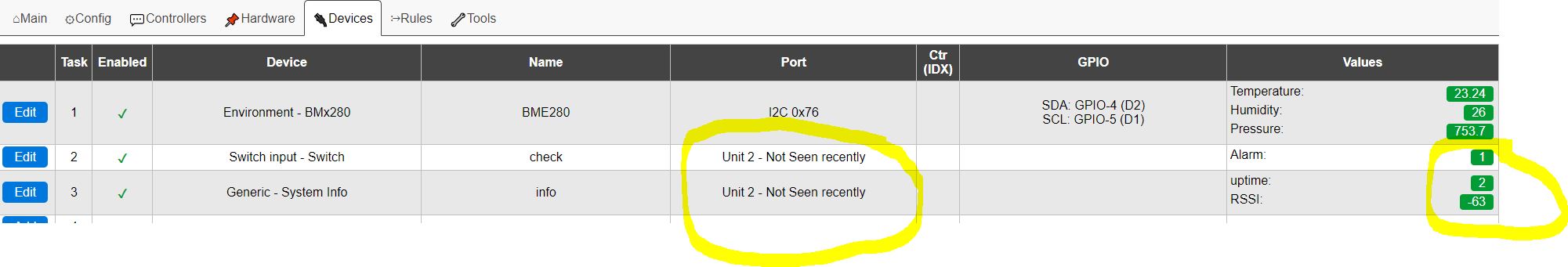

Unit2 is Down: WiFi, Power, Etc
Unit1 lost another Unit2, but still continues to store the last received values Why?
How can I update or reset these old irrelevant cached values (to NaN, Error, Etc) until the connection is restored and the current ones are obtained?

Right now there isn't any such setting to set values when not being updated for N amount of time.
However I think you might be able to do so via rules, as the task does send out an event when it does receive an update.
So something like this:
You may have to check the checkbox on the tools->Advanced page to allow taskvalueset on tasks other than a Dummy task.
on info#update do
TimerSet,3,600 // Task #3, set timer to 10 minutes
on Rules#Timer=3 do
taskvalueset,3,1,-1
taskvalueset,3,2,-1

please check if using taskvalueset within rules to override value of P2P sensor works. On tasks using "non dummy devices" you get error NOT_A_DUMMY_TASK
I was using taskvalueset within rules to set ERROR value in case that temperature sensor Dallas was disconnected and this was not reflected in setting ERROR value. Since taskvalueset is not working anymore I created viewtopic.php?t=8781 where I am waiting for resolution.
Basically this (not being able to set value on task with DS18b20 sensor) blocks my application to be upgraded to newer version of ESPEASY - I am still on 20201227 where taskvalueset on sensor task is working.
In viewtopic.php?t=10144 @ATH implemented simple solution how to detect (within rules) that one node is not responding anymore. Maybe it helps you to.

@jgrad:
That's why I suggested to check the checkbox (tools->Advanced page) for "Allow TaskValueSet on all plugins:"
This should allow to set taskvalues on non-Dummy tasks.
Doesn't that work for you?

What is info#update ?TD-er wrote: ↑25 Apr 2024, 15:45 Right now there isn't any such setting to set values when not being updated for N amount of time.
You may have to check the checkbox on the tools->Advanced page to allow taskvalueset on tasks other than a Dummy task.Code: Select all
on info#update do TimerSet,3,600 // Task #3, set timer to 10 minutes endon on Rules#Timer=3 do taskvalueset,3,1,-1 taskvalueset,3,2,-1 endon
Re: P2P reliability
This solution works stably, you're right.
But how can I get NaN instead of -1 (degrees) the same way it can be done into remote temperature sensors?
on Rules#Timer=3 do
taskvalueset,3,1,-1
on Rules#Timer=3 do
taskvalueset,3,1,-1

By the way I came up with the following idea to add to ESPEasy as it can help in your use case and doesn't yet require a lot of code changes;
The idea is to fire an event when a node is removed from the node list as it is no longer seen.
Something like "node#disconnected=123" with "123" being the node index.
Also add an event like "node#connected=123" when it is first seen (or seen after it was removed from the node list)
And for tasks which receive values from a p2p node:
"taskname#remotelost" or something like that when the node supplying the remote feed will be removed from the node list.
Re: P2P reliability
This idea is very very great.
It will cover most p2p control issues.
This will not have to be solved with significant workarounds: the basic control of node availability has already been implemented, but there are still not enough official events.
In addition, there is a lack of choice regarding the behavior of sensor values received from the remote node. This is configured in the sensor plugin (can as NaN), and should correspond to the dummy sensor appearing via p2p.
Re: P2P reliability
I can look into the rules parser accepting NaN, but I'm a bit hesistant to mess with that piece of code as it is now working (very) well and quite fast.
And this parsing code is used everywhere in the code.
Sending task configuration to receiving nodes does require changes in the p2p code and is plugin dependent so I rather save this for a later change as it really bothers me that this would be plugin specific and I want to think of a way to make it more generic.
Re: P2P reliability
You're right, we need a universal approach to any plug-in sensors available remote via p2p.
Re: P2P reliability
I did add the p2pnode#Connected and p2pnode#Disconnected events in this build: https://td-er.nl/ESPEasy/latest/
on p2pNode#Connected do
LogEntry,'ESPEasy p2p node %eventvalue1% added: %eventvalue2% with build %eventvalue3%'
on p2pNode#Disconnected do
LogEntry,`ESPEasy p2p node %eventvalue1% not seen for a while`
