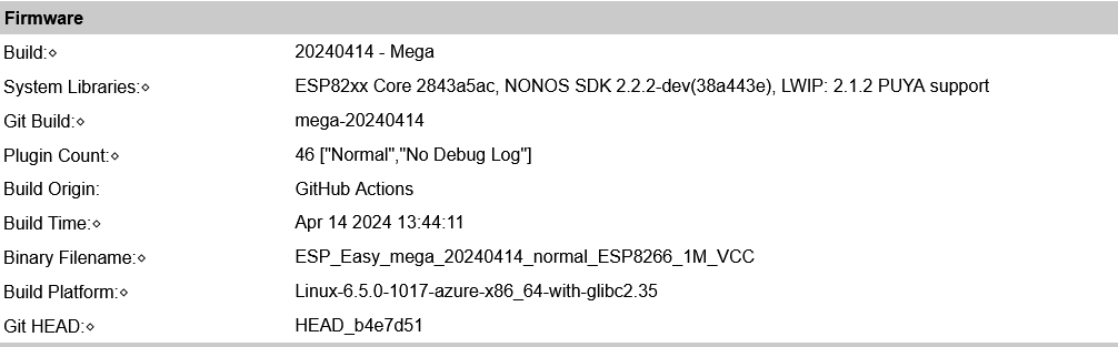

Build tried.png (19.69 KiB) Viewed 5657 times

Thanks for the logs, but unfortunately, these are made using the 20240414 release build, just like you screenshot, and not the most recent nightly 20240812... :?

Ohh... shoot...
I forgot that I downgraded this ESP to 20240414 during the experience... to see if i got the problem again.... Really my bad.
I am then re-doing it.
Sorry for stupid omission
