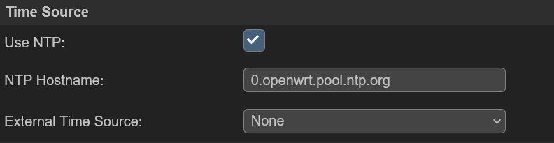

i am wondering, why my ESP's (esp8266) have the wrong time.
Under advanced, i set "use NTP" .
Under Main i see that NTP is succesfully initialzed:
But TIME Source says ESPEASY p2p:
After Restart/Reboot the ESP time source is again NTP.
Why this could happen ?

Most likely, the ESPEasy P2P Network is faster in responding than the NTP server. (That P2P network is quite fast... as it's all local
) Depending on several factors, later it may switch to NTP once/if that offers a reliable connection.
NB: You don't need to configure an explicit NTP server by name, just leaving the field empty will use pool.ntp.org, that automatically returns a result from the nearest NTP source, based on your externally exposed IP-address.
NB2: To avoid an 'NTP-storm' when all devices come back on-line after f.e. a power failure, ESPEasy has built-in some randomness in time to get the latest NTP time, but a better solution could be to have 2 or maybe 3 ESPEasy units in your P2P that are always running, to have NTP configured, and all others to rely on these to get the time via P2P. Most likely, the accuracy provided via P2P is good enough, and NTP will also be re-synched from time to time, to iron out the small differences that occur in an ESP, when counting its own time, and that updated time will also be shared via P2P.

Thanks for your quick reply.
I have deleted my specific NTP Server entry, as suggested.
All your explanations make sense, but do not explain why a have around 6 days time difference !!
I use 10 ESP's with NTP enabled, 2 ESP's without NTP. On all devices p2p is active.
The 2 ESP''s without NTP are configured with deepsleep. It seems that some devices got the time and date from one of this two devices.
What mean the number in brackest after p2p: ??
Time Source: ESPEasy p2p (8)
