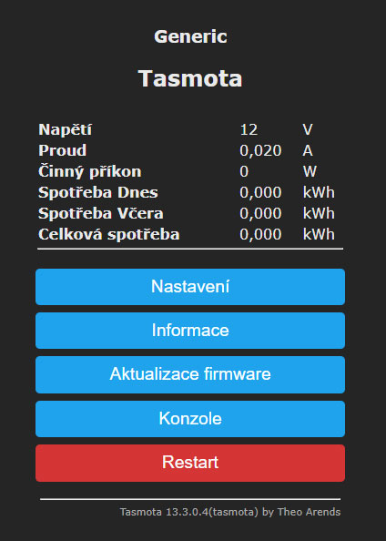

I have a question for the members of the forum if communication with PZEM-017 works for anyone. I tried it with the P-102 PZEM-004Tv30-Multiple plugin but it doesn't work (PZEM-004T v3.0 works for me).
EDIT: I use modified PZEM-017 with TTL communication behind the optocouplers. Communication with the PZEM application works.
EDIT2: Tasmota works.

Any news on the PZEM-017 plugin? It's an excellent DC voltage and current meter. I use it to measure the output from the photovoltaic panels of my power plant (Tasmota so far).
