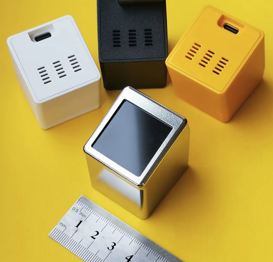

#25 Post by ThomasB » 10 Mar 2025, 18:33
Found a possible candidate for what I have in mind. It's the GeekMagic SmallTV Pro. About $25 USD on aliexpress.
Geekmagic SmallTV Pro
https://www.aliexpress.us/item/3256804945825258.html
There are two versions. The lower cost "Ultra" is ESP8266. The "Pro" is ESP32 with a touch sensor. Both versions have a DiY fan base and there are several projects on the web.
Unfortunately I want something with a slightly bigger display. But maybe I'll order one and check it out.

#26 Post by TD-er » 10 Mar 2025, 20:19
I have the 'low budget' ESP8266 version in transit, so when it has arrived, I can tell you if it is worth it or not.

#31 Post by TD-er » 18 Mar 2025, 22:32
ThomasB wrote: 10 Mar 2025, 21:27 Looking forward to your report.
It has arrived...
Quite a lot of empty space inside.
The default sketch present on the unit.
Display background looks more black than the photos suggest.
Here a discussion about the internals: https://community.home-assistant.io/t/i ... o/618029/2
And here a Tasmota config for the ESP32S3 with PSRAM version (the more expensive variant)
https://github.com/arendst/Tasmota/disc ... t-12022264
Just reading a bit on the used display (ST7789) for the cheap ESP8266 version.
It seems it might be rather tricky to address those as they don't use CS and you can't use a frame buffer on ESP8266 as 240x240 pixels seem to require quite some RAM for a full frame buffer.
