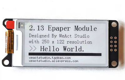

I was looking for a cheap and, most importantly, available E-Ink display that supports ESPEasy.
But I couldn't find one :)
So I ordered a readily available cheap one. "Only" 7€ something on Aliexpress.
And I was very surprised when I plugged it in and saw that it worked right out of the box. I am very, very happy. I guess I have to say a big thank you to Ton 😘. Great work!
The only thing that doesn`t match is the resolution 250x212 vs 250x122. But as long as text only gets truncated i don`t care :)
