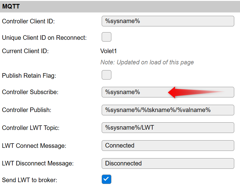

I want to send a message that is triggering an event from Home Assistant to EspEasy.
I set the Controller1 to Home assistant with the parameters as shows bellow.

How should I formulate the publish message on the Home Assistant side ?
I tried without succes :
- Topic : Volet1/cmd=event Payload : ha_start (Volet1 is the %sysname%)
Could you help please ?

Found my mistake :
Topic should be : Volet1/cmd
Payload : event, ha_start
Gives in the log :
EVENT: ha_start
