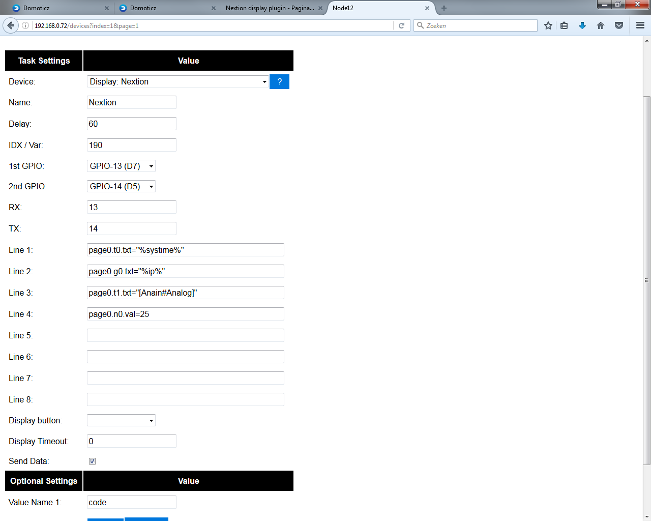

I made quick and probably very dirty combination of ser2net and OLED plugin.
I can now send system variables to the display, using strings like :page0.t0.txt="%systime%" and page0.g0.txt="%ip%"

#25 Post by majklovec » 09 Nov 2016, 02:40
Dirty, easy, working.
Enjoy

I did some ehm pick and mix and drag an drop on the code from Majklovec and OLED plugin and now it reads up to 8 lines of text from the plugin.

    case PLUGIN_TEN_PER_SECOND: {
      char __buffer[80];
      uint16_t i;
      uint8_t c;
      while (nextion->available() > 0) {
        delay(10);
        c = nextion->read();
        if (0x65 == c) {
          if (nextion->available() >= 6) {
            __buffer[0] = c;
            for (i = 1; i < 7; i++) {
              __buffer[i] = nextion->read();
            __buffer[i] = 0x00;
            if (0xFF == __buffer[4] && 0xFF == __buffer[5] &&
                0xFF == __buffer[6]) {
              Plugin_104_code =
                  ((__buffer[1] >> 8) & __buffer[2] >> 8) & __buffer[3];
              UserVar[event->BaseVarIndex] = __buffer[1] * 256 + __buffer[2];
              UserVar[event->BaseVarIndex + 1] = __buffer[3];
              String log = F("Nextion : code: ");
              log += __buffer[1];
              log += ",";
              log += __buffer[2];
              log += ",";
              log += __buffer[3];
              addLog(LOG_LEVEL_INFO, log);
              sendData(event);
        } else {
          if (c == 's') {
            i = 1;
            __buffer[0] = c;
              __buffer[i++] = nextion->read();
              Serial.write((char)__buffer[i]);
            Serial.println();
            __buffer[i] = 0x00;
            String log = F("Nextion : send command: ");
            log += __buffer;
            ExecuteCommand(VALUE_SOURCE_SYSTEM, __buffer);
      if (Settings.TaskDevicePin3[event->TaskIndex] != -1) {
        if (!digitalRead(Settings.TaskDevicePin3[event->TaskIndex])) {
          Plugin_104_displayOn();
          displayTimer = Settings.TaskDevicePluginConfig[event->TaskIndex][2];
      success = true;
    case PLUGIN_ONCE_A_SECOND: {
      if ( displayTimer > 0) {
        displayTimer--;
        if (displayTimer == 0)
          Plugin_104_displayOff();
    case PLUGIN_WEBFORM_SAVE: {
      String plugin1 = WebServer.arg("plugin_104_timer");
      Settings.TaskDevicePluginConfig[event->TaskIndex][0] = plugin1.toInt();
      String plugin2 = WebServer.arg("plugin_104_rxwait");
      Settings.TaskDevicePluginConfig[event->TaskIndex][1] = plugin2.toInt();
      String plugin3 = WebServer.arg("plugin_104_events");
      Settings.TaskDevicePluginConfig[event->TaskIndex][2] = plugin3.toInt();
      char deviceTemplate[8][64];
      for (byte varNr = 0; varNr < 8; varNr++) {
        char argc[25];
        String arg = F("Plugin_104_template");
        arg += varNr + 1;
        arg.toCharArray(argc, 25);
        String tmpString = WebServer.arg(argc);
        strncpy(deviceTemplate[varNr], tmpString.c_str(), sizeof(deviceTemplate[varNr]));
//      Settings.TaskDeviceID[event->TaskIndex] = 1; // temp fix, needs a dummy value
      SaveCustomTaskSettings(event->TaskIndex, (byte*)&deviceTemplate, sizeof(deviceTemplate));
      success = true;
    case PLUGIN_WEBFORM_LOAD: {
      char tmpString[128];
      sprintf_P(tmpString, PSTR("<TR><TD>RX:<TD><input type='text' "
                                "name='taskdevicepin1' value='%u'>"),
                Settings.TaskDevicePin1[event->TaskIndex]);
      string += tmpString;
      sprintf_P(tmpString, PSTR("<TR><TD>TX:<TD><input type='text' "
                                "name='taskdevicepin2' value='%u'>"),
                Settings.TaskDevicePin2[event->TaskIndex]);
      LoadCustomTaskSettings(event->TaskIndex, (byte*)&deviceTemplate, sizeof(deviceTemplate));
          string += F("<TR><TD>Line ");
          string += varNr + 1;
          string += F(":<TD><input type='text'li size='50' maxlength='50' name='Plugin_104_template");
          string += F("' value='");
          string += deviceTemplate[varNr];
          string += F("'>");
      string += F("<TR><TD>Display button:<TD>");
      addPinSelect(false, string, "taskdevicepin3", Settings.TaskDevicePin3[event->TaskIndex]);
      sprintf_P(tmpString, PSTR("<TR><TD>Display Timeout:<TD><input type='text' name='plugin_104_timer' value='%u'>"), Settings.TaskDevicePluginConfig[event->TaskIndex][2]);
      success = true;
    case PLUGIN_INIT: {
      LoadTaskSettings(event->TaskIndex);
//      if ((ExtraTaskSettings.TaskDevicePluginConfigLong[0] != 0) && (ExtraTaskSettings.TaskDevicePluginConfigLong[1] != 0)) {
      if (Settings.TaskDevicePin1[event->TaskIndex] != -1) {
        pinMode(Settings.TaskDevicePin1[event->TaskIndex], OUTPUT);
        digitalWrite(Settings.TaskDevicePin1[event->TaskIndex], LOW);
        delay(500);
        digitalWrite(Settings.TaskDevicePin1[event->TaskIndex], HIGH);
        pinMode(Settings.TaskDevicePin1[event->TaskIndex], INPUT_PULLUP);

ledfreak3d
Posts: 48
Joined: 21 Oct 2016, 12:41
Re: Nextion display plugin
#45 Post by ledfreak3d » 14 Nov 2016, 13:21
Plugin seems to work fine
now trying to see what variables work
see picture attached
You do not have the required permissions to view the files attached to this post.
