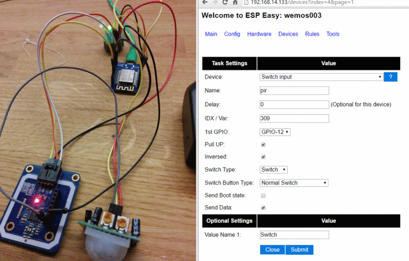

Re: which GPIO?
i am powering the PIR with 3.3V, and it works...
may you try this to (there is lots of info on this in google..)

I don't understand. The PIR sensor is powered from the USB-in line, so it is 5V (measured it).
Ground is common, so no problem.
The signal line of the sensor is either 0 or 1,65V, so no conversion needed here as well.
My problem is with the level of the GPIO line when the sensor is inactive. It does not drop to zero!
Re: which GPIO?
i did not measure my output, but its running on 3.3volt and working without any other mods ....
do you have another sensor at hand?

Which GPIO did you connect to, and what kind of device did you use in the ESP Easy task?tozett wrote:i did not measure my output, but its running on 3.3volt and working without any other mods ....

Re: which GPIO?
I am using a HC-SR501 PIR without any issues
The PIR is powered by 5v
the output is 3.3v connected GPIO 12 on ESP12e
I have the pull up enabled
inversed is disabled
I also tried the smaller HC-SR505 Mini PIR's but found these unreliable

Re: which GPIO?
i measured my output. if the pir has detections, it is 3.3v.
the pir is powered with 5V from my wemos-d1 mini.
i googled, this page says, they have also 3.3v on output: https://learn.adafruit.com/pir-passive- ... r/overview
you have only 1.65, means half of my output-voltage on detection....
