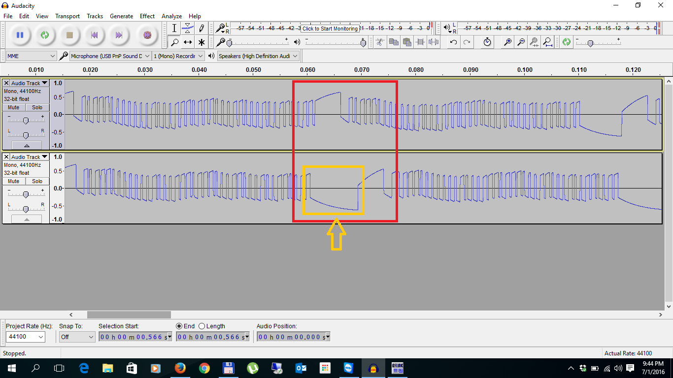

I put below more detail in order to help you to correct the transmission for Dooya remote control.
I made a capture using a receiver and Audacity and see that is a little difference between Dooya remote and RFlink.
Between the first two sequences of transmission RFlink insert a delay that does't apear on Dooya transmision (marked in yellow in the picture). This delay is ok only between:
- 2nd and 3rd sequences
- 5th and 6th sequences
- 6th and 7th sequences
I attached the Audacity file that contain on the first track the original Dooya remote transmission and the second RFlink transmission
http://finesolution.ro/share/Audacity.7z
- 443_1.png (86.28 KiB) Viewed 16319 times

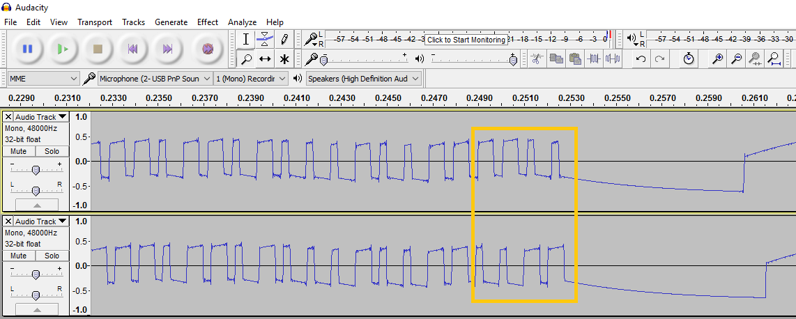

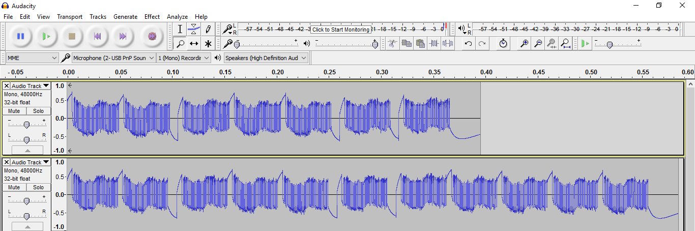

I received today the test version.
Because I'm on holiday I can test only the Dooya remote control versus RFlink in Audacity.
Everything looks fine but I saw that:
- Dooya remote control send seven sequences and RFlink eleven (attached picture)
- First 4 sequences are identically but in the 5,6 and 7, last four bits are not ok. The original remote send "0011" and RFlink send "1100" (attached picture)
In the pictures first track is Dooya remote and second is RFlink
Next week I will test Rflink directly on Dooya motors and I will come back with feedback.
